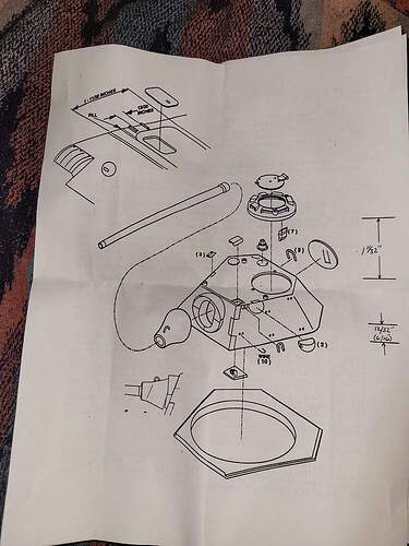

Looks like what Chesapeake Model Designs said do in their Panther F conversion.
The Panther F was basically the new small turret using the existing Panther G hull. There was a planned change to the hull hatches from what I understand for the Panther F. The G’s swing hatches some times were blocked by the main gun. I think the plan was to change the hull hatches so they went up and rotated so the main gun couldn’t block them from opening.
Here are shots of the Chesapeake Model Designs Panther F Turret Instructions for building a Panther F out of a Tamiya Panther G. I think this makes a fair guide for tweaking the DML/Dragon Panther F kit or a basic check list.
Bill Miley owner of CMD excelled at getting this stuff correct back in the day. Bill had a real T-55 wheel and build his masters based off of the real thing accordingly. He was an ultra hard core master modeler.
I’d planned to build a Panther F using CMD’s conversion for the Tamiya kit as DML’s old Imperial #9004 wasn’t the best. I’m sure the newer DML kits are better.
