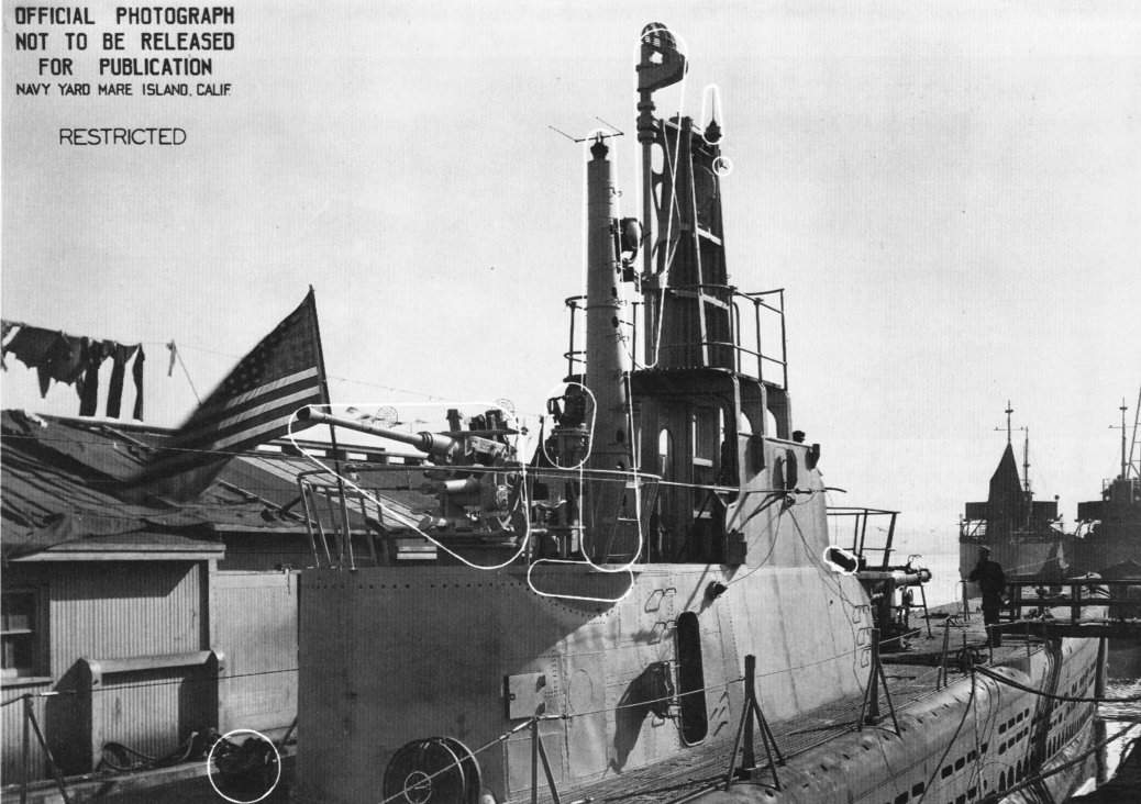

Definitely right about the many differences between boats, they varied considerably. As the war progressed they added more holes to allow trapped air to escape and improve dive times. In this photo of Gato’s fairwater you can see those deck edge holes.
I like your idea on how to do them, have to remember it if I do another.
You have caused me to check my Flasher referenes again. Yup, by 1945 they still didnt have those holes on the upper hull.
Your photo illustrates some of those holes in the rear of the fairwater, however, that also do not come in the kit. The Flasher had many of them as well, so I used the method I described above to drill them out. I also had to thin them from inside as it was sheet metal and the walls of the holes look too thick if you don’t thin them out.
