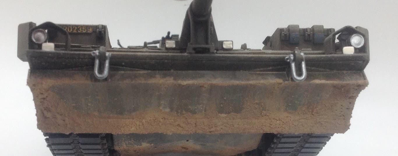

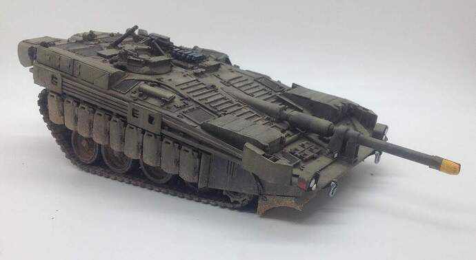

Calling this one done!
After painting the periscopes and adding the final mud effects I highlighted the mg with a pencil and took these finished pics.
Whatcha think?
Great, like a cat getting ready to jump…
VERY dynamic, the details are excellent, and the mud looks fantastic!
