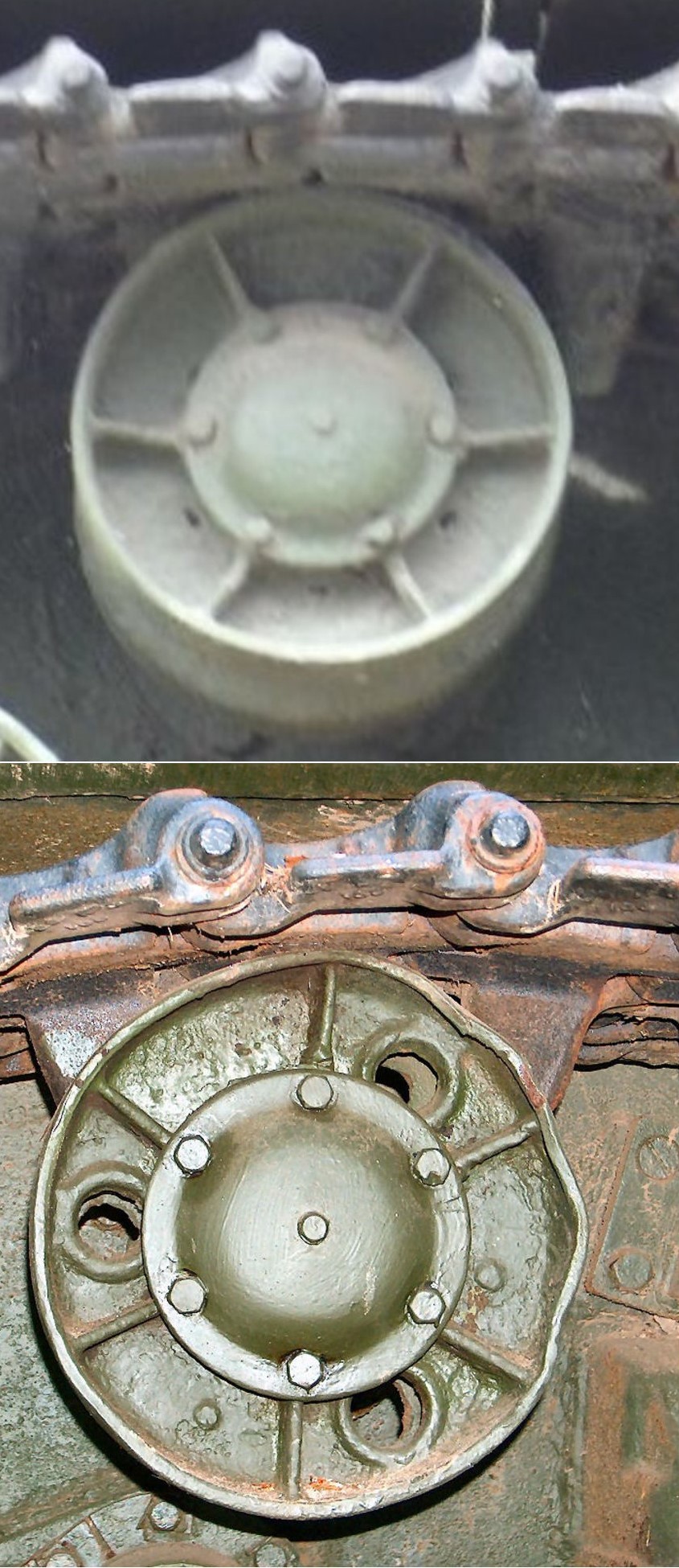

Here’s one more:
The early IS-2 model did not have lightening holes in the return rollers.
Dragon and Trumpeter IS-2 Model 1943 models have lightening holes in the return rollers.
Source: http://www.4bogreen.com/
There should also be other handrails on the turret; spare tracks were originally attached to the stern…

Dragon 6537 JS-2 Stalin II + Soviet Infantry Tank Riders.
The top roller is an early model and the lower one is a later model.
If you look closely at the picture, you will notice that the early top roller wheel also had very small relief holes.
