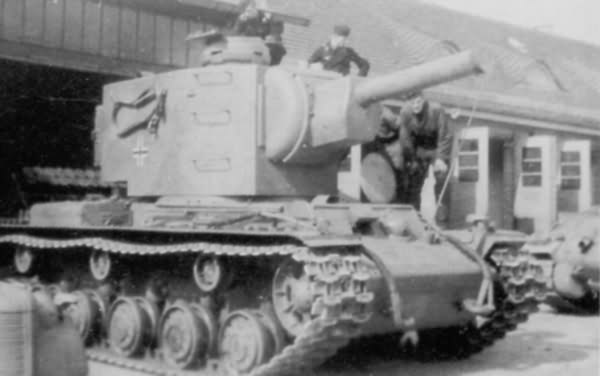

Trumpeter kit 367 depicts a KV-2 captured by the Germans and modified for Operation Hercules. The tracks stick out past the fenders in a very distinctive way.
kv2_001
I believe the photo above shows the vehicle upon which the model is based. In my opinion, in this specific case, those two millimeters matter.
Well its your model, so your opinion matters.

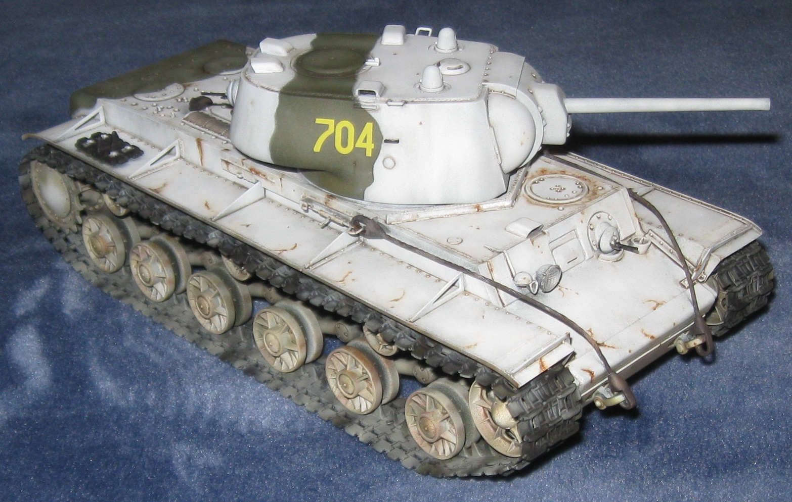

I bought them, and built them to have a sample of Soviet WW2 heavies. I don’t enter them in shows, I just like having them.(!Horrors!!)
BigBend1-1
Flamemach1
KV 1 -E
KVsnow4
MVC-096S
Thank you for posting pictures of your KV projects! They all look great to me. I especially like 702. The winter white camouflages really makes that one stand out. It looks very well done to me. The snow on the tracks is also a nice contrast element.
If I may, did you enjoy building the models? Were they especially easy or difficult? Was one more pleasant or troublesome than the others? Did you run into any specific problems?
Thanks for the compliments. They were / are easy to build, I didn’t have any fit problems. The instructions were clear and logical. “dry fitting” is an easy way to determine how to position parts for assembly. Soviet KV series had a “mud scraper” reaching in between the sprocket halves, to remove mud. Attaching this part was somewhat of a head scratcher, so I left the spot it was to be glued to unpainted, and attached it at the very end, and spot fixed the paint. There were ejector pin marks, but we are all big boys now, and know how to fill them.
I used the link and length tracks, and they fit perfectly.
For “702” I used a product from Hudson and Allen, called snow. It looked just right to me.
