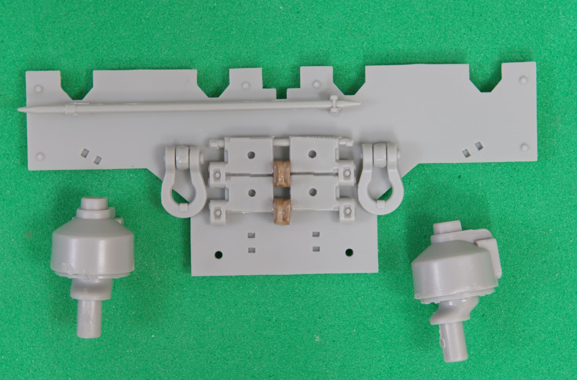

I started with the rear plate.

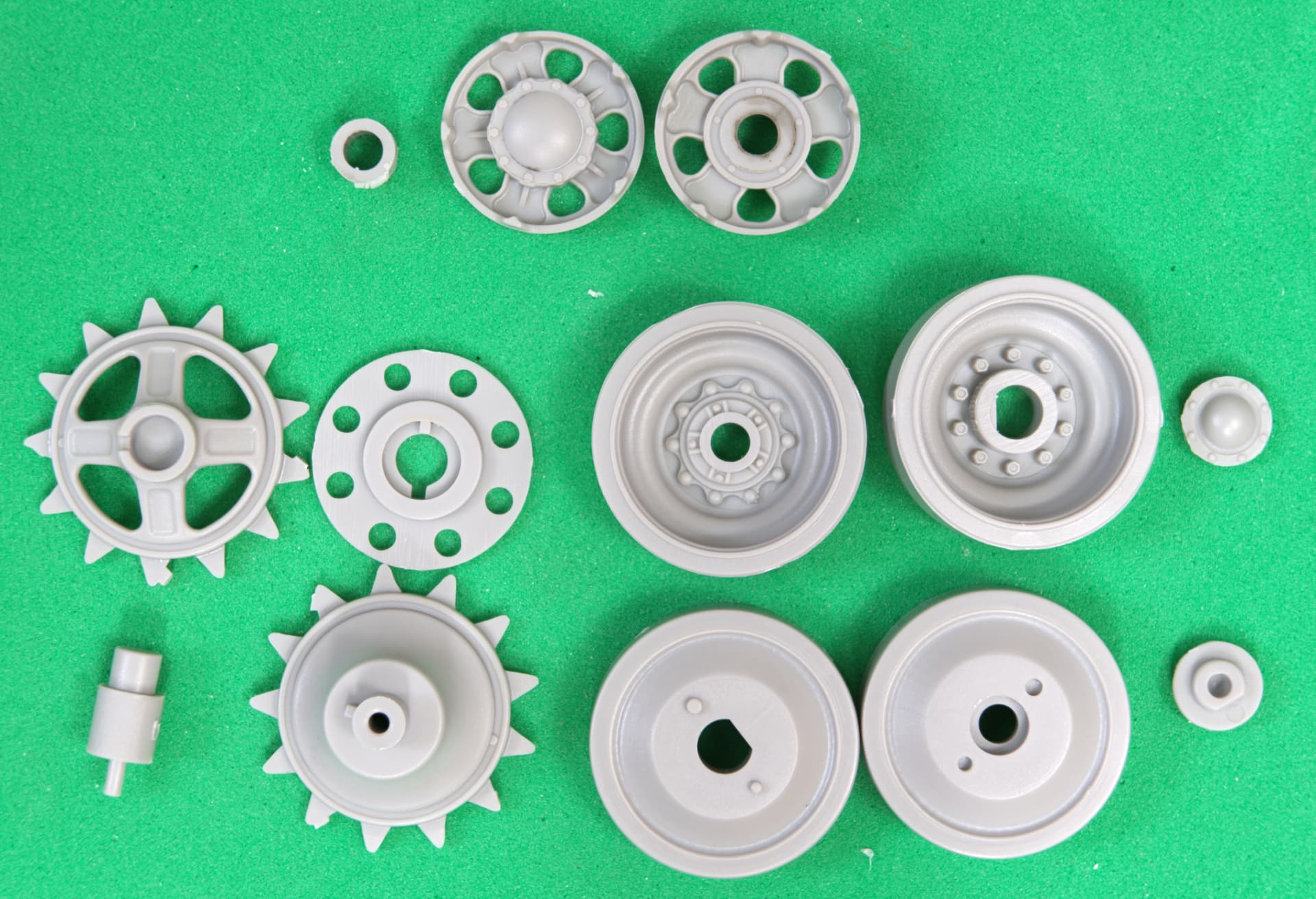

Then the running gear.No polycaps in this kit.
