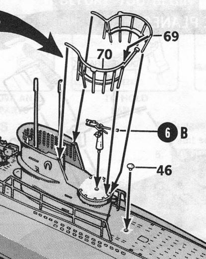

Hi Everyone,
I realize that this request is a long shot but here goes nothing. I started working on a Revell 1/125 scale U-99 WWII German U-Boat kit and discovered that I’m missing a part #70 which is the port side railing that goes around the 20mm gun. If anyone has this kit(#H-408-3800)I’d be willing to pay for the part or the entire kit. Normally, I’d just make the kit a "Shelf Queen"but I spent 3 days on drilling and sanding out the limber holes and I don’t wait to shelve the kit yet. Thanks for your time.

That’s the part Frenchy! #70 is the railing that I’m missing.
