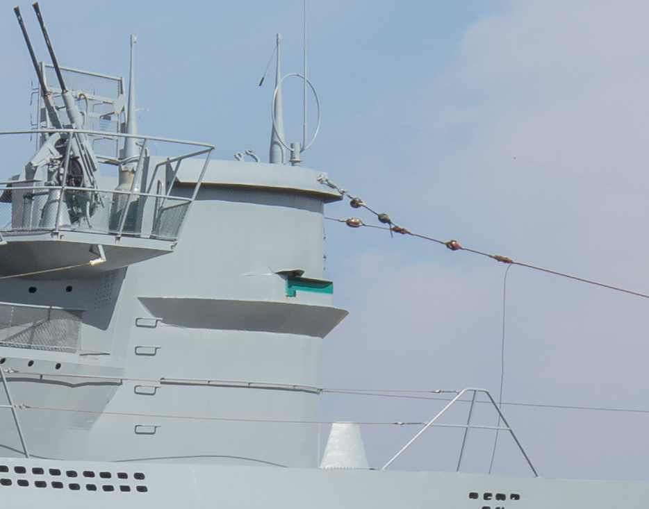

The jumping wire is indeed a radio aerial, this is the U995 at Laboe (just north of Kiel in Germany)
Other large photo of the bridge area
The aerial is thinner, say about half, than the guard rail around the AA-gun positions.
Would one inch be about right for the guard rail?
Half inch or a little less for the antenna wire?
12.5 mm / 144 = 0.08 mm (thinner than an ordinary hair …)
Go for 0.1 mm to keep it visible …
