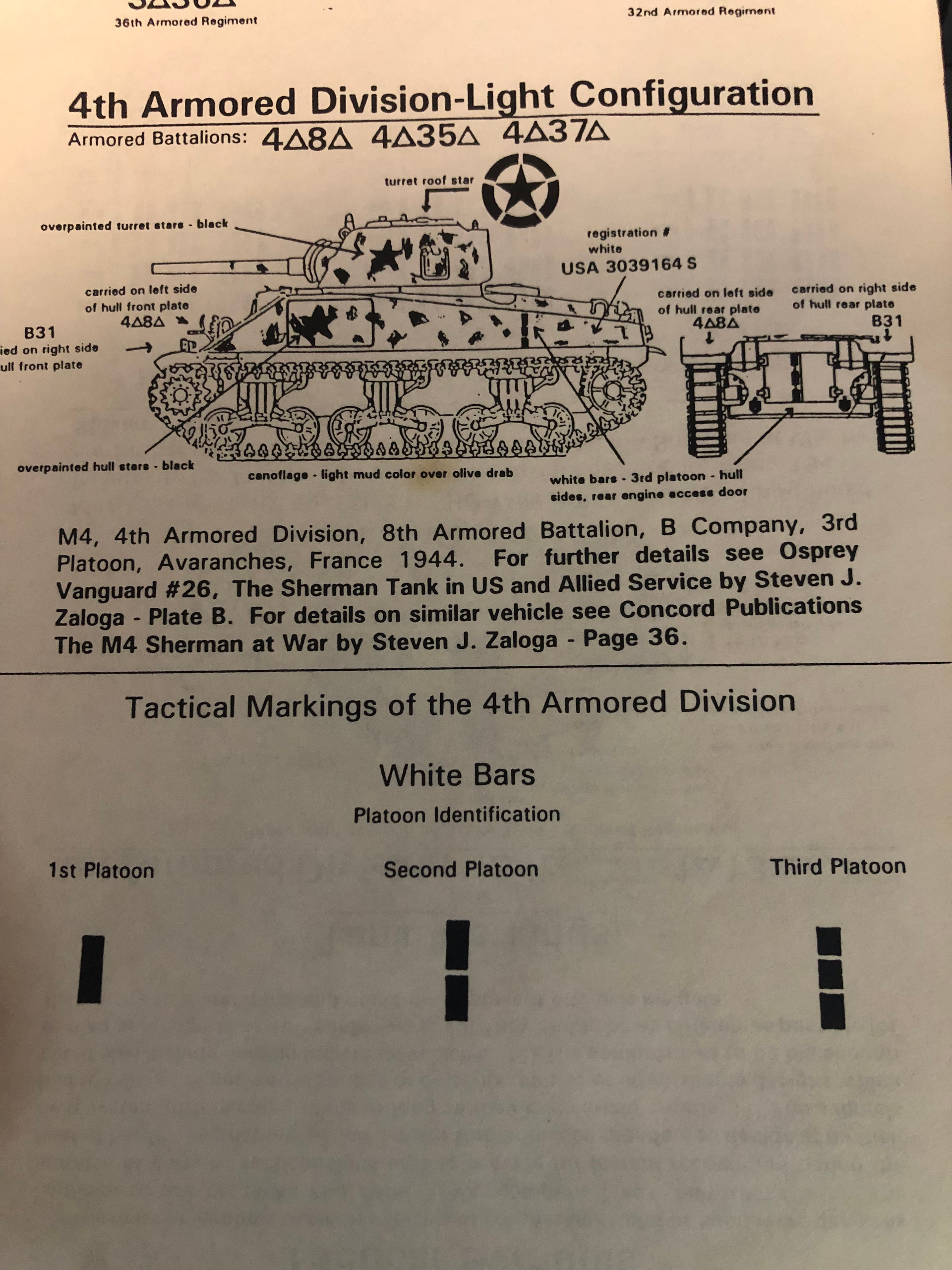

I’ve got an old set of decals with a fairly detailed instruction set for all US Armored divisions fielded in the ETO.
I’ve seen several pictures of these markings on the rear hull side, and one shot of it on the rear engine compartment doors.
3rd Platoon?
1st Platoon??

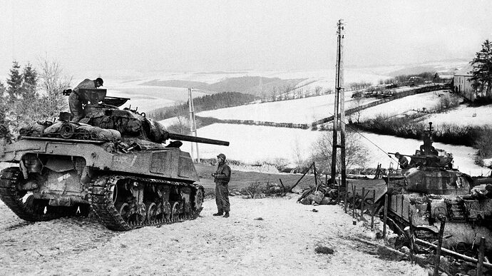

This M4 seems to have the marking painted on at a slant, instead of vertical. Did different companies use different “clock” positions for these markings?

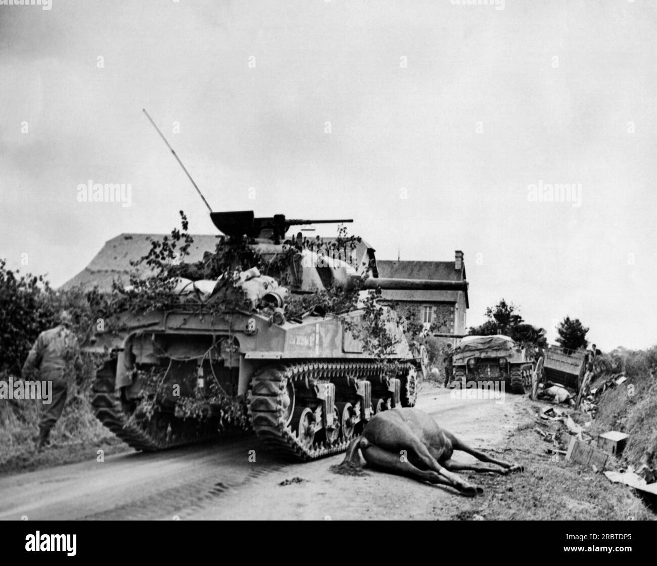

I’ve read that Irzyk and the command officers of the 8th ordered all their stars painted out or painted over, and the 8th was very fond of using foliage to camo their tanks. I also remember reading that a lot of the crews hastily applied mud to their tanks to help them blend in.

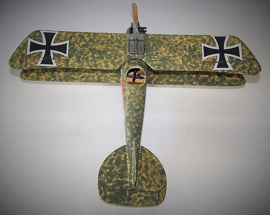

I glued a torn off piece of make up sponge onto a toothpick to do this camo. Supposedly the Austrians camo’d these aircraft with sponges and paint
that looks great!!!
Indeed. Very nicely done.
Thanks guys. JG2 supposedly used a similar method for the fuselage side mottling on their 109’s during the Battle of Britain and I have 109 in my stash that I plan to finish in that scheme…
