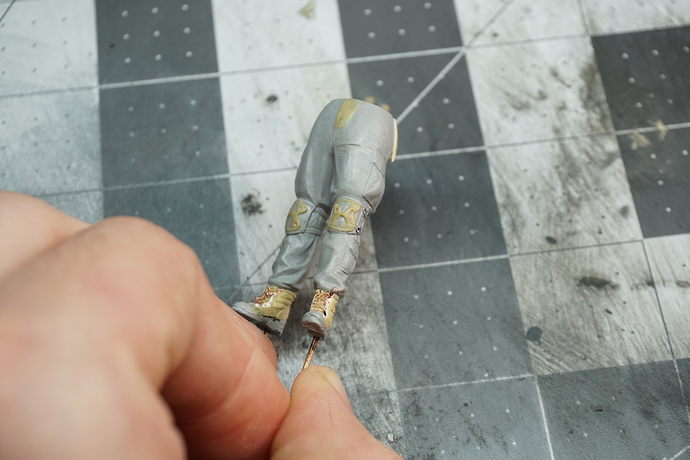

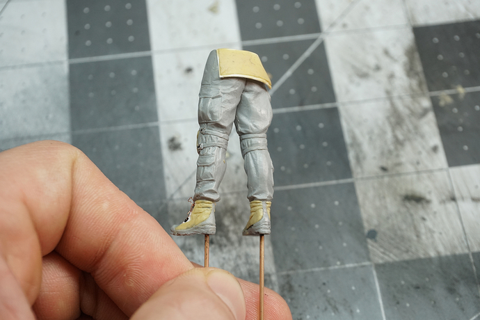

To start, here are the legs, which are practically done except for some detail on the shoes.

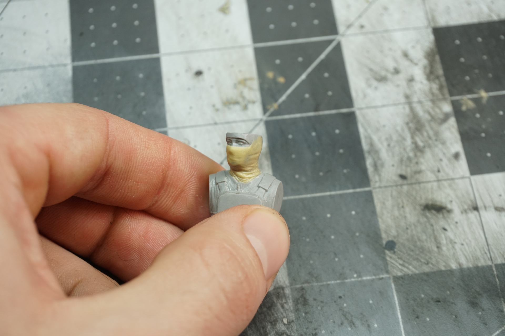

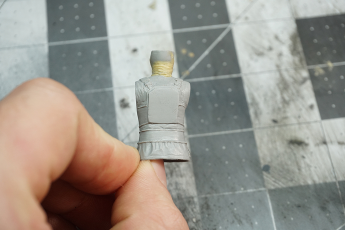

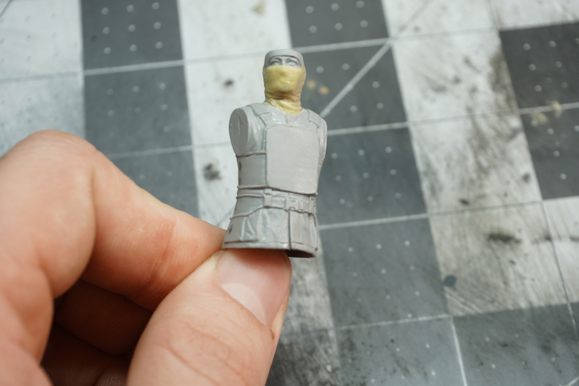

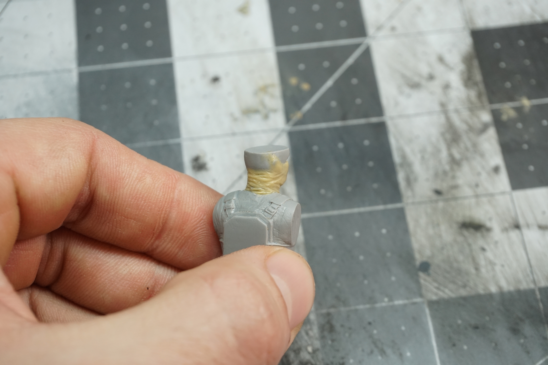

For the upper torso, I removed all the molly( I think that’s how you spell it) mounts, shoulder straps, a sling, and hollowed out the jacket bottom. I also reshaped the balaklava to make it fit and look better.
It still needs a bit of sanding to smooth in areas, but overall, I’m very happy with it.

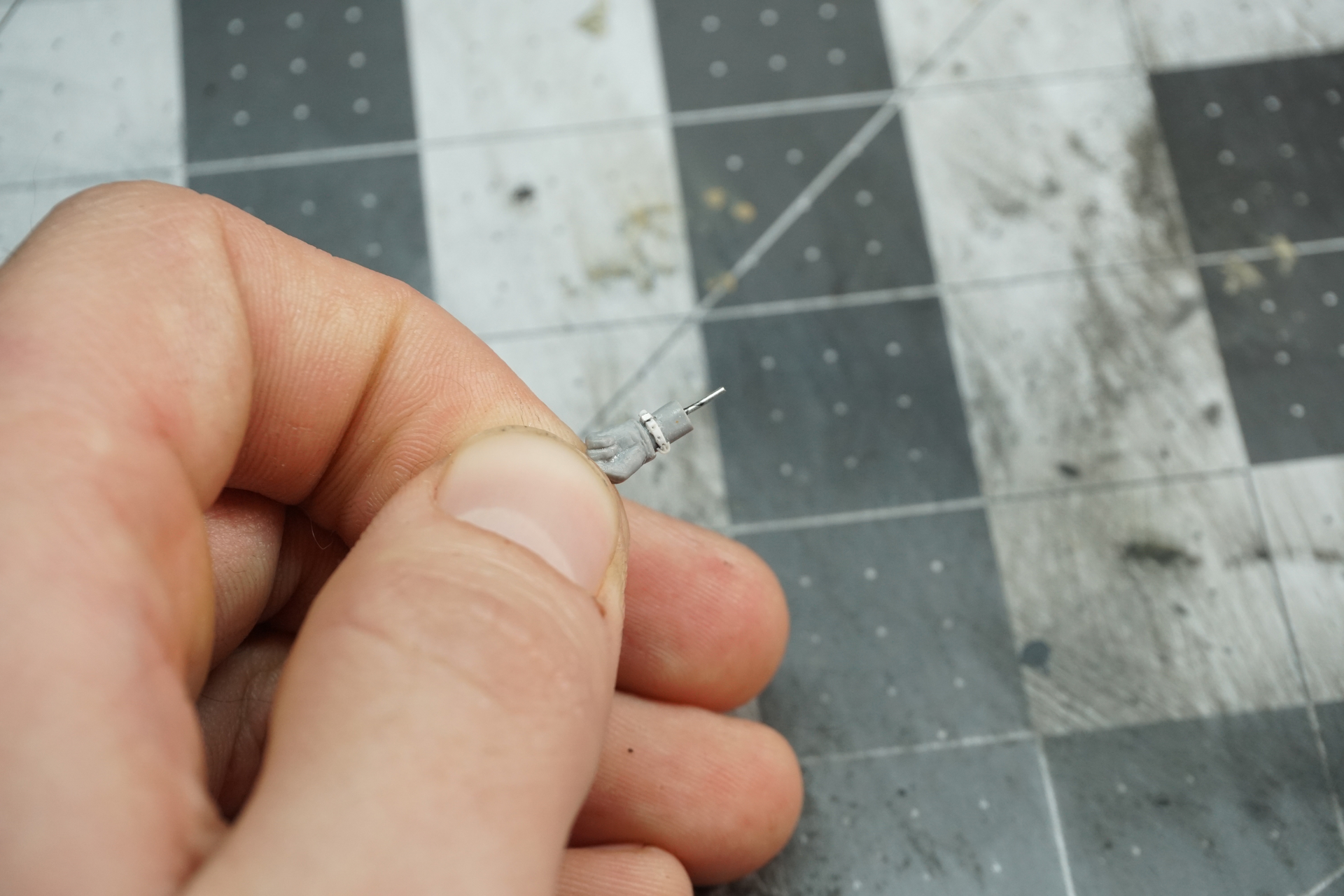

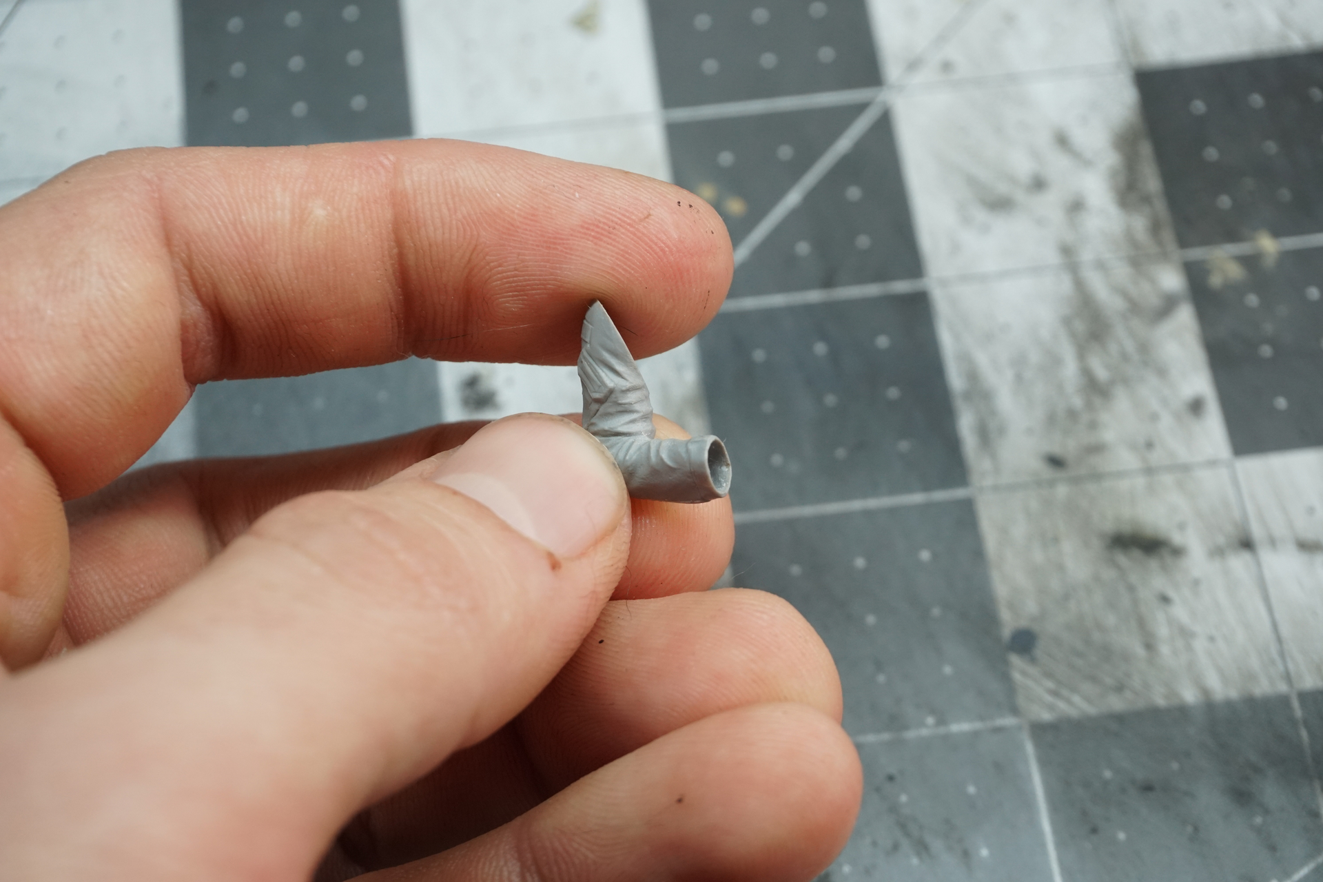

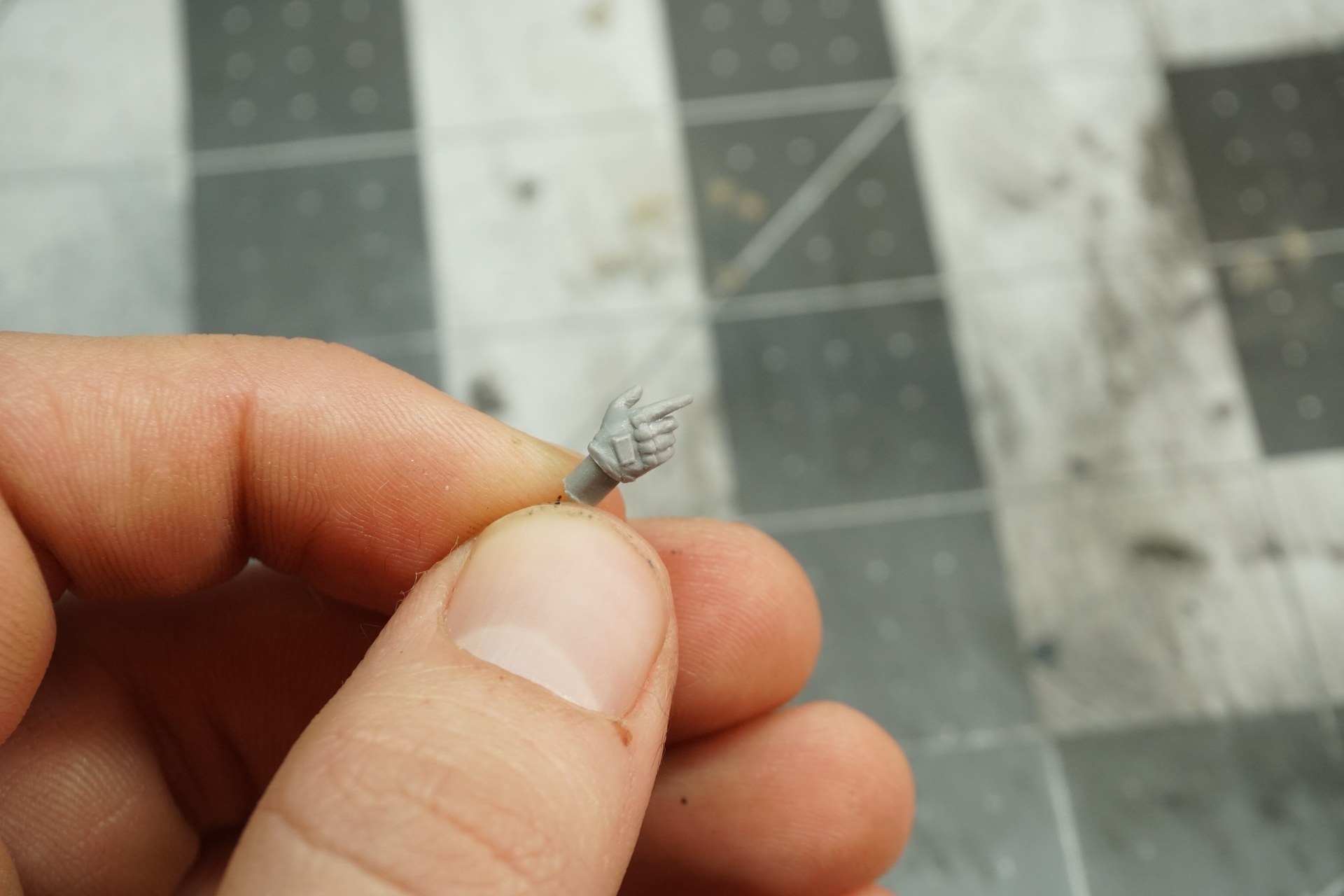

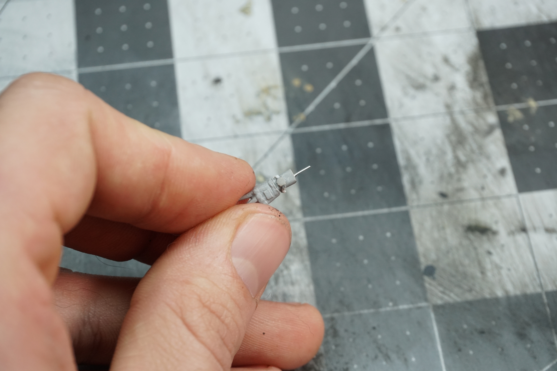

The arms got some work done with getting the hands cut off and adding forearms with spare sprues. I then hollowed out the sleeves, cleaned up the fingers, and added a 3D printed watch with a styrene strap.

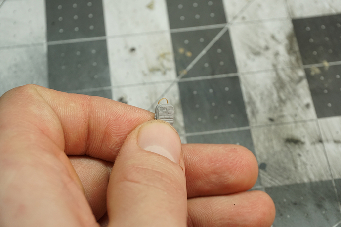

I prepared some of the pouches, but there are plenty to claean up still, some 3D printed.
Here are some of the pouches I have already prepared:

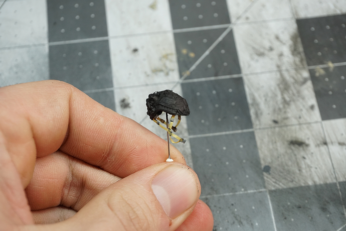

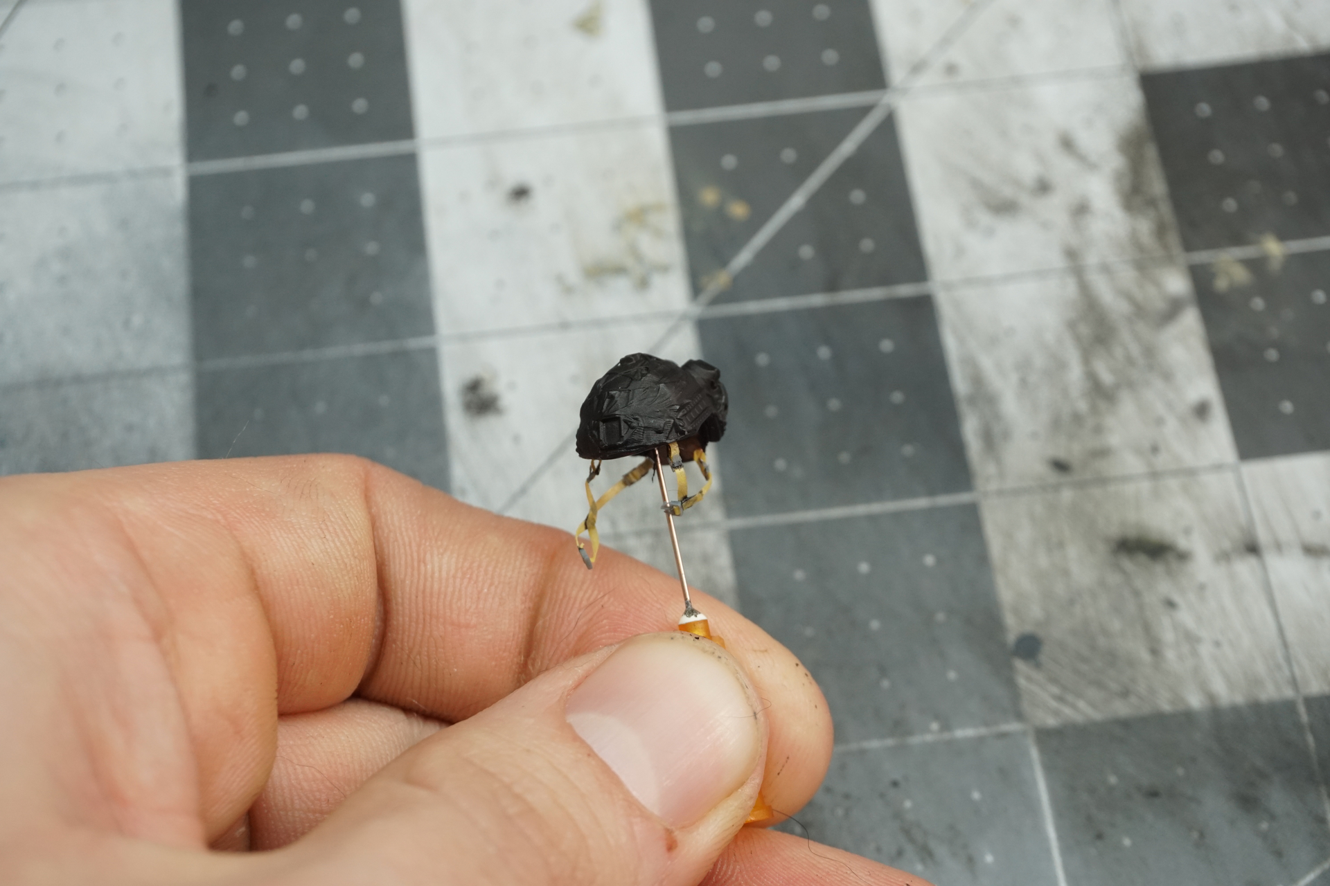

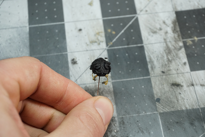

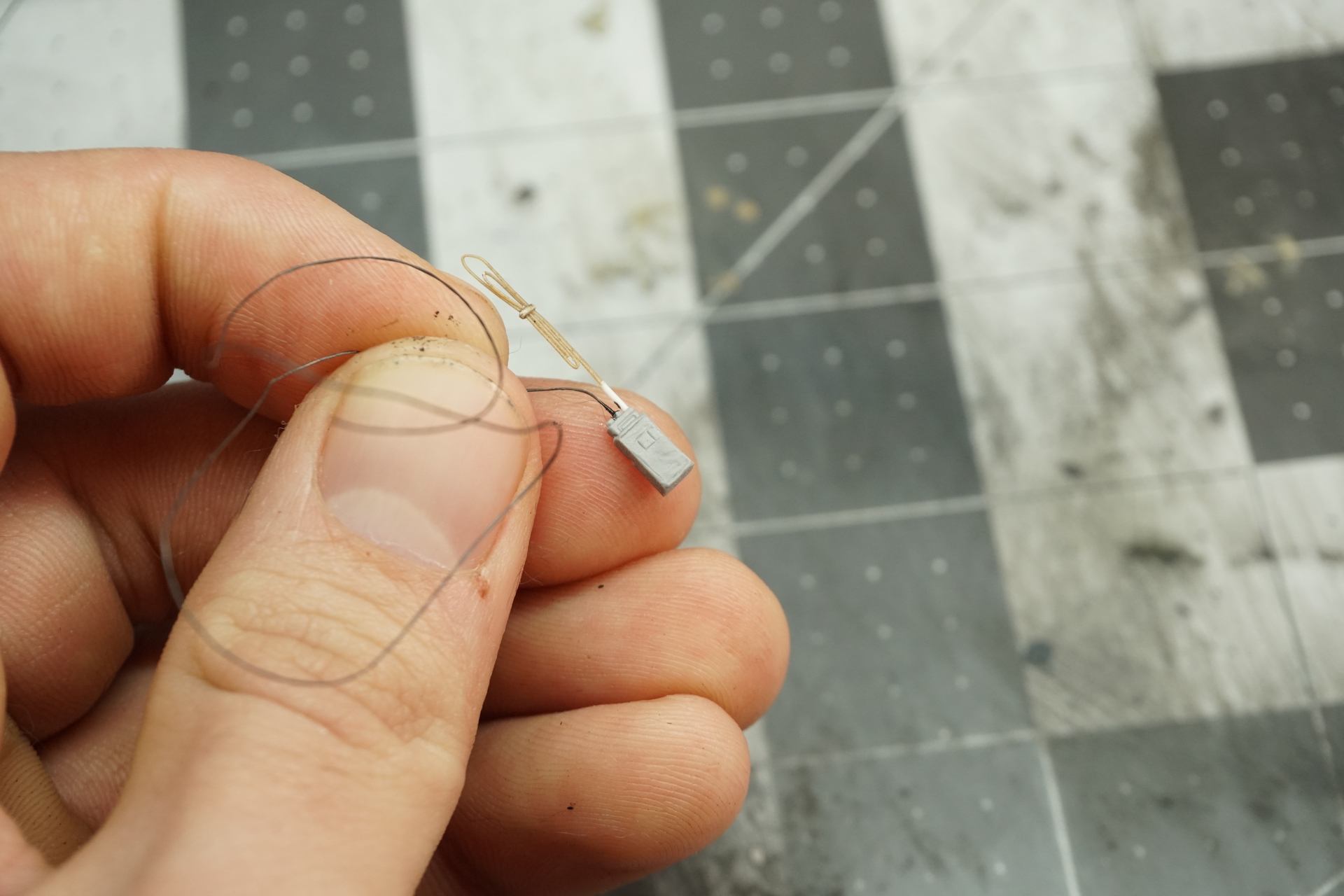

I also 3D printed a helmet, and using Tamiya tape and some tiny 3D printed strap buckles, which ended up being fully functional.

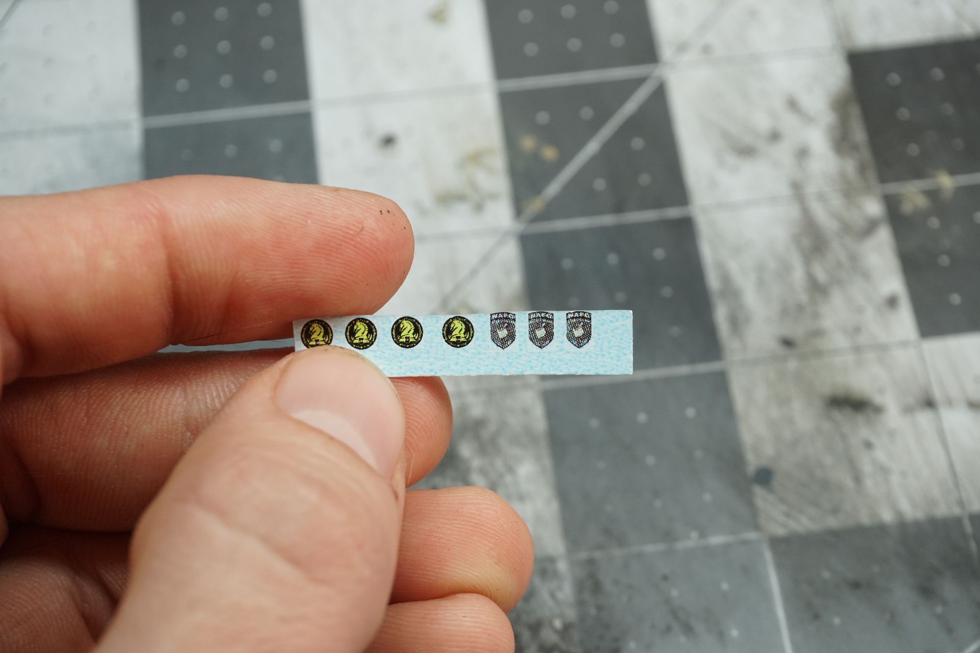

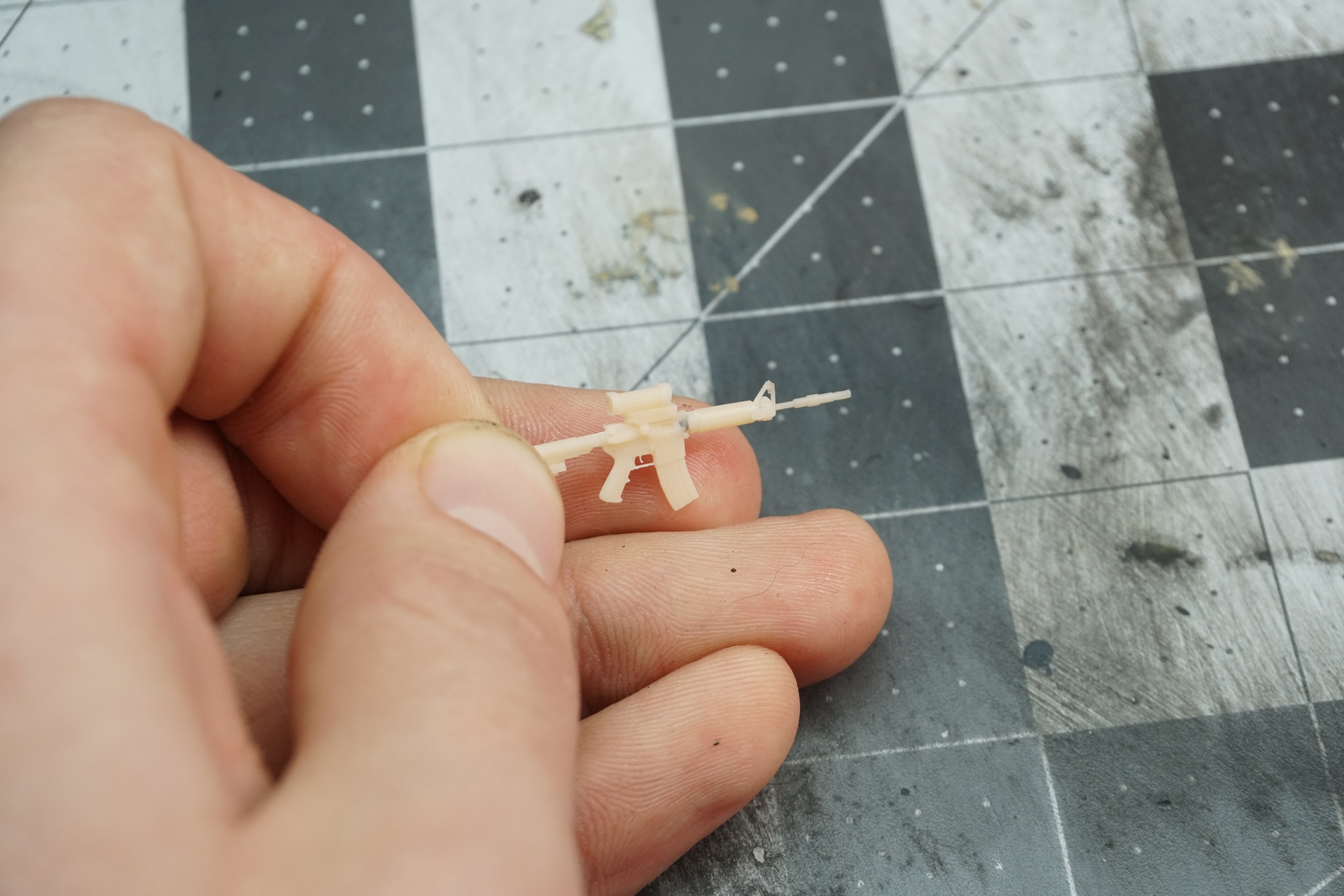

Lastly, the weapon will be a Canadian donated C8a2 that is my own design, and some patches that I had custom printed.
