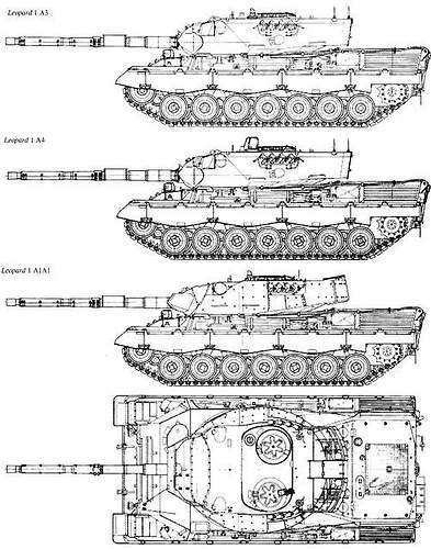

Our CPT Obvious moment: (we all know this, just sharing to help with AFVID)

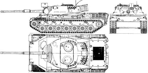

The Leo 1 turret (except the 1A3 and 1A4) have a readily recognizable small flat roof for the two hatches.
The 1A3 (look ma, no blisters!) had a rather large flat for the turret roof:
I slept on the turret roof the night the Wall came down, with 10th Panzeraufklarungs Battalione in Ingolstadt. Early in the morning, we had some VERY old schnapps!
And the hatches themselves are distinct: see the molded cover on the A3. I don’t know if the hatches are backwards/forwards compatible. So now I’ll go look carefully at the turret roofs and make more SWAGS!

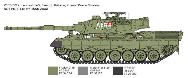

Based on the donors, ALL the Leopards would be 1A5. ALL the Oryx records indicate that three Leopard 1A5 have been DDA (destroyed/damaged/abandoned).
And here is a key AFVID feature: the 1A5 has the EMES 18 FCS, and the ORF (optical RF) blisters are removed and plugged.
