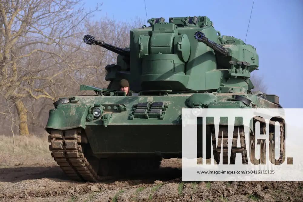

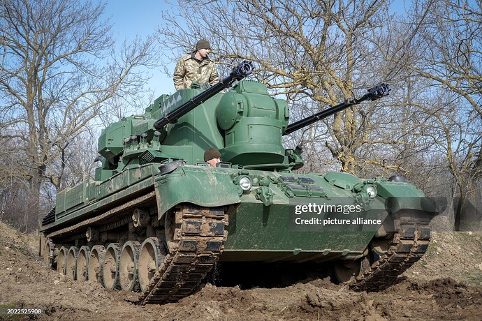

Pics of a Ukrainian Gepard…the Bundeswehr markings and registration numbers were removed before delivery.

So they dont have any distinct Ukrainian markings?
No distinct Ukrainian markings so far from the available images.
