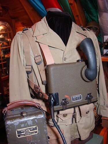

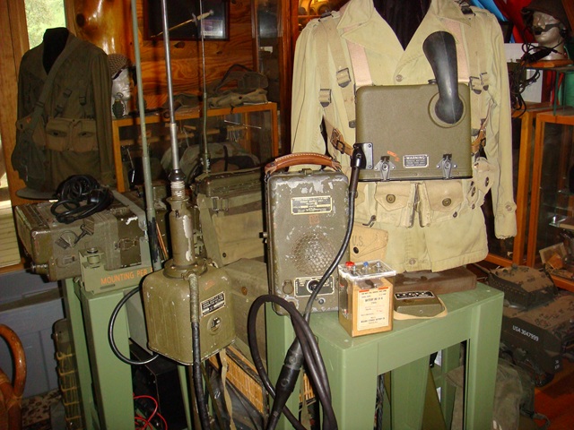

At any rate, in addition to scale modeling, one of my other hobbies is collecting militaria. I’ve recently managed to complete my SCR-511 radio set, so here are a couple of happy snaps of it and a link to the final draft of my SCR-511 Radio Set Research Monograph.

Wow Mike, just when you thought you’ve seen everything, here comes this radio set. I along with many others know next to nothing about commo equipment except for the stuff we used when I served. Even then I knew almost nothing except how to press the talk button lol. That’s a very very interesting piece of equipment. Not sexy of course like tanks, trucks, cannons , jeeps etc but amazing.
