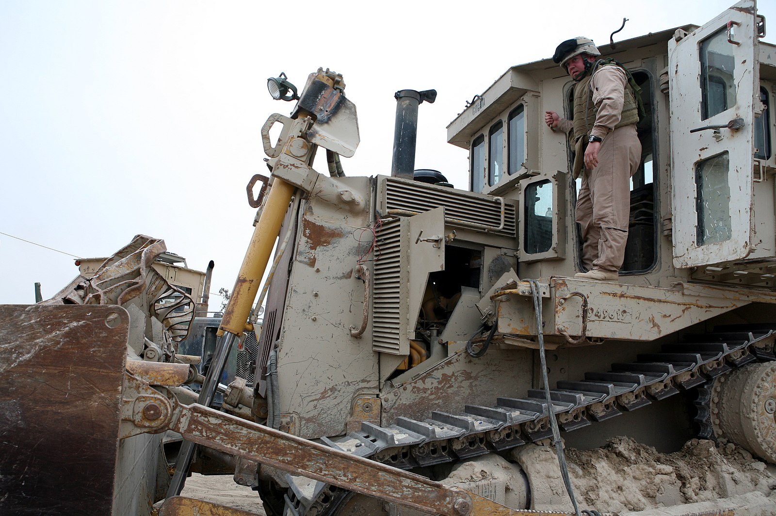

Did you mean this photo?
As Gino said, Marines don’t like advertising what unit equipment it’s belong to. Looks like the only markings are a vehicle name in the top center “Golda” (maybe).

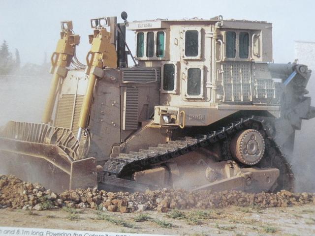

Here is another one without a vehicle name.

Another “Earth Pig” above the windshield.

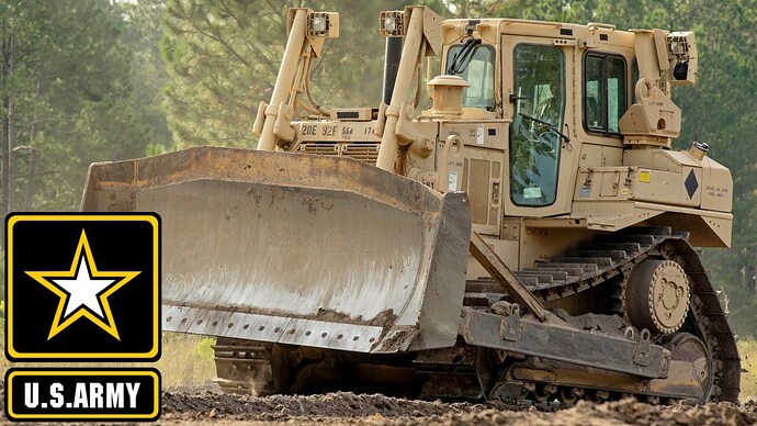

Upper right of the cab has HSC.

The Wiki caption may be a bit misleading with respect to the vehicle’s markings. Although the driver was probably a 101st troop, D9R dozers are not likely to be organic to the 101st. More likely, the D9R was organic to a combat heavy engineer battalion in support of the 101st, say 92nd Engineers or similar.
If so, the left marking could be “[parent designation such as 20E for 20th Engineer Brigade] space 92E” and right marking could be something like “HSC space [2- or 3-digit unit-designated vehicle ID].
“HSC” is short for “Headquarters and Services Company” and has equipment that is somewhat different than what a line company will have. The battalion will assign a vehicle ID such as “HSC 12” or “HSC 211”, something like that, to the dozer and that’s how the right marking would likely read. “12” would indicate 1st platoon (line company) or 1st section (headquarters company), second vehicle.
If the hull is marked, between the left unit marking and the right unit-designated vehicle ID will be a portion of the vehicle’s serial number and perhaps a black national star. That serial number remains with the vehicle no matter which unit the vehicle gets assigned to. Unit markings change.
Heavy earthmover vehicle IDs can be pretty wonky (nonstandard). Their location gets even wonkier when armored cabs are installed on the vehicle.
If the dozers are from the 92nd, there will be a black diamond painted on the side of the vehicle or operator’s door.
