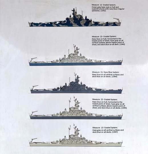

Depends on what ship, where on the ship and what Measure (camo) scheme was on that ship at the time, measures change over time.
Example, USS Alabama

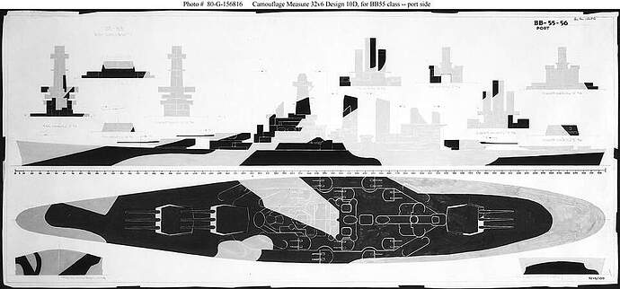

Or USS North Carolina in Measure MS-32 10D
Thank you Littorio, i see there’s a few colors he could use yeah.

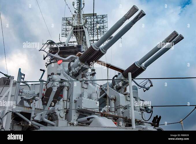

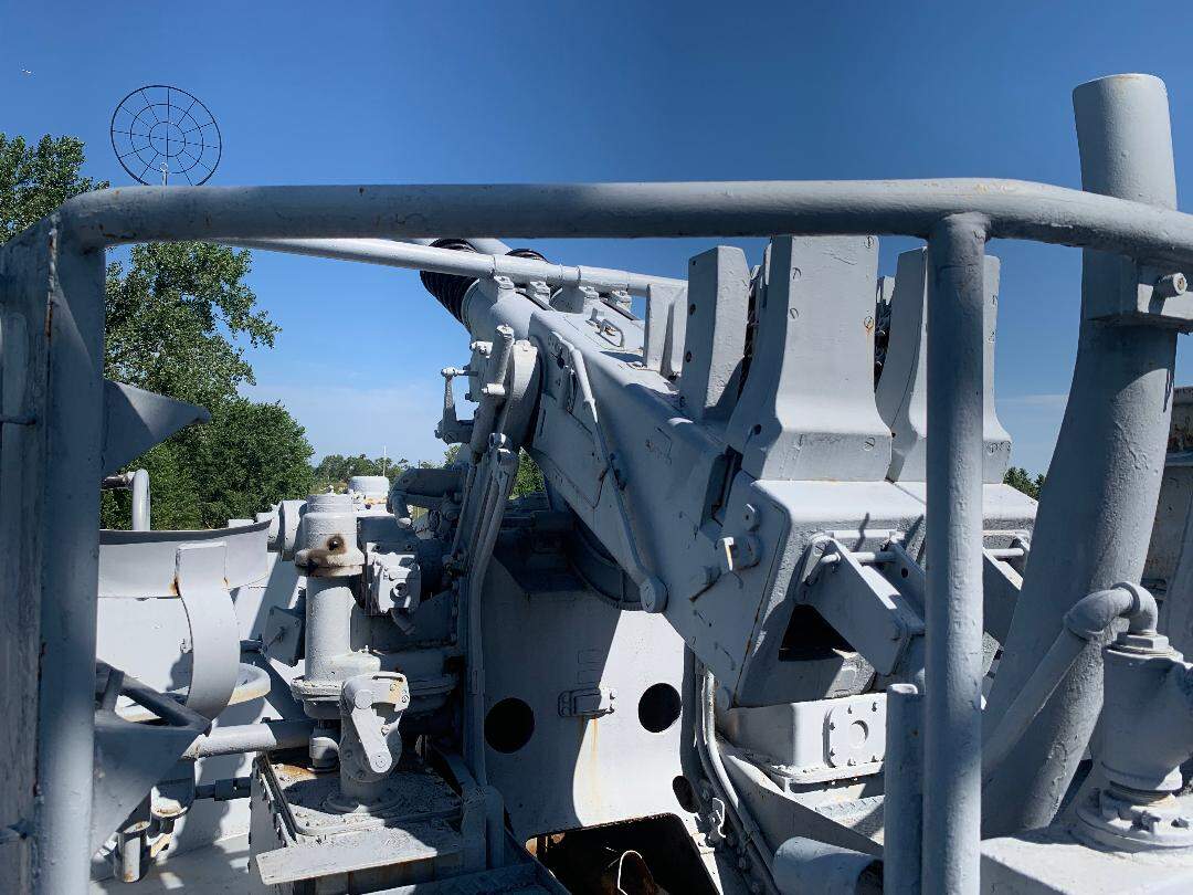

Littorio is correct. My recent trips to the Intrepid and Alabama show them in all gray only because the ships were painted all gray.
Intrepid:

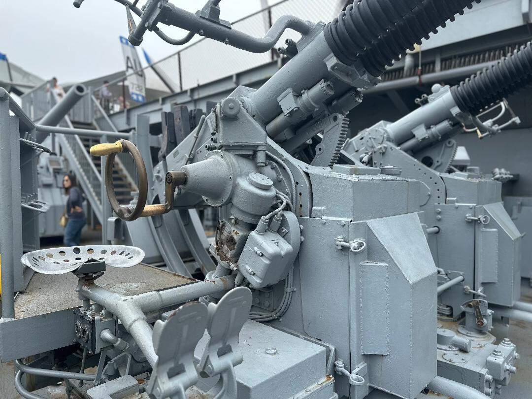

Ah, get a good walk around so you’ll know what to touch up in brass.
Alabama:
Research will show they were indeed cammoed along with the ship. Easiest references to find are deck guns on US subs, although those are smaller

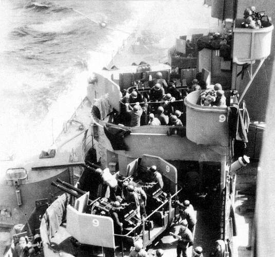

If he is making the gun with a shield, the exterior shield color should match the camouflage pattern of the ship. The interior shield color may or may not match the camouflage pattern of the ship. In the photo of USS Missouri BB-63 below, you can see the Bofors mounts’ shield exterior and interior color matches the color of the superstructure. This was common, but not universal. The color here is “5-H Haze Gray”. It is a medium gray (see paint chip below). There were actually two different Haze Grays in use during World War Two. One was a pure gray, the other had a more bluish tone, almost lavender.

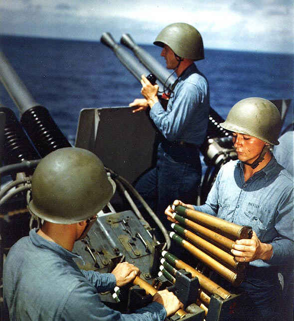

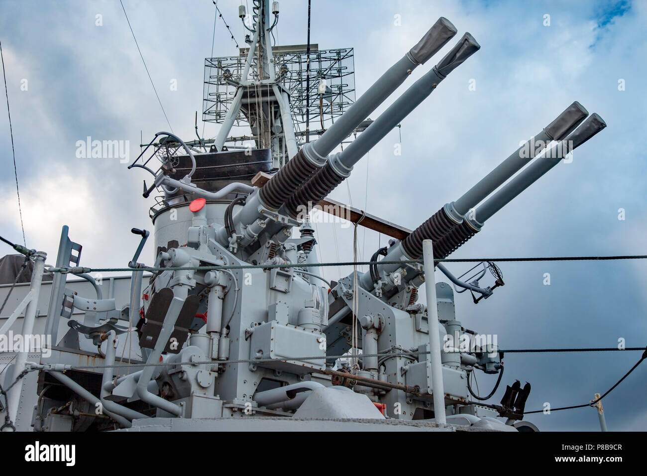

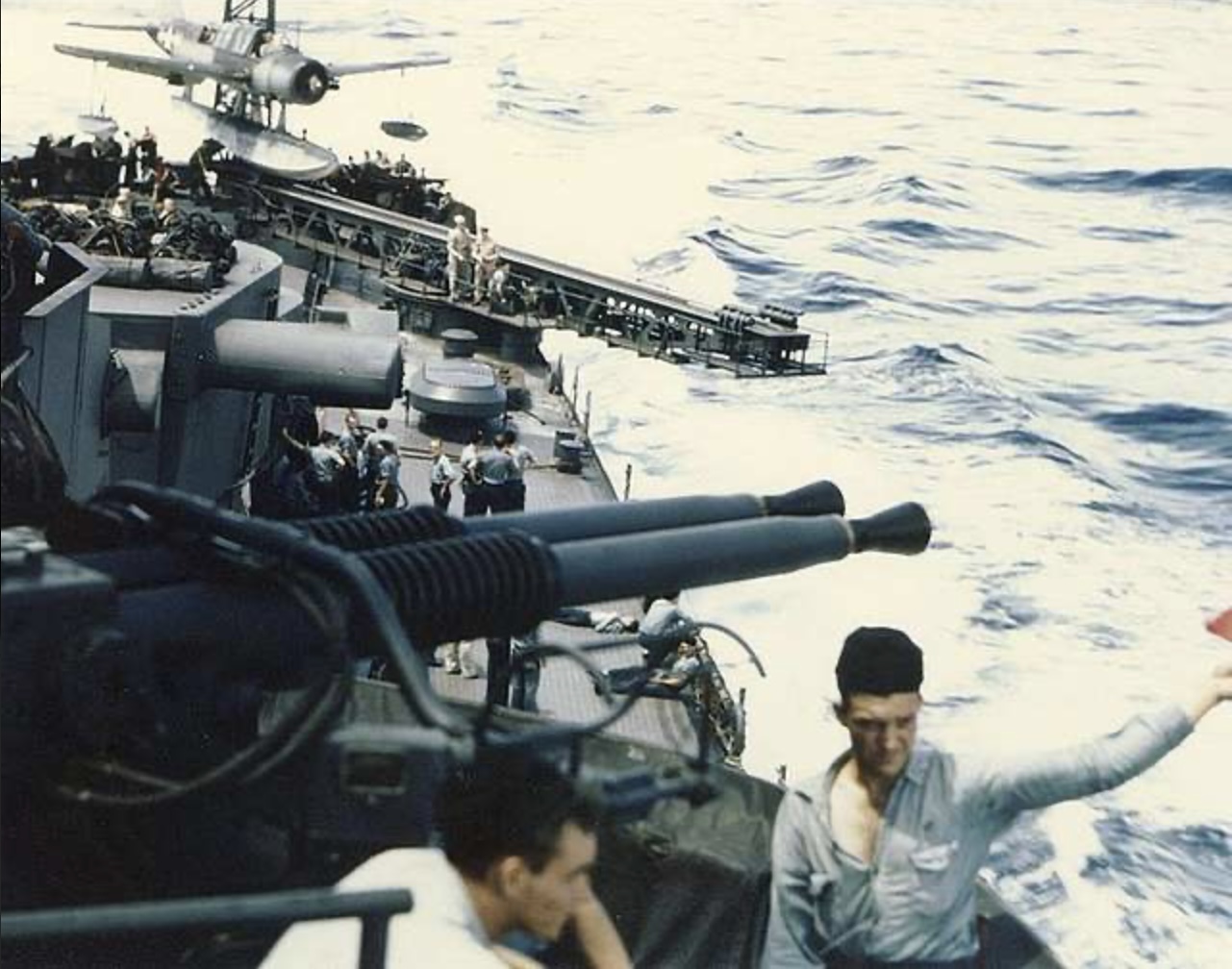

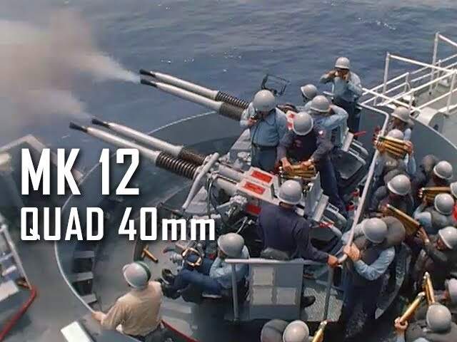

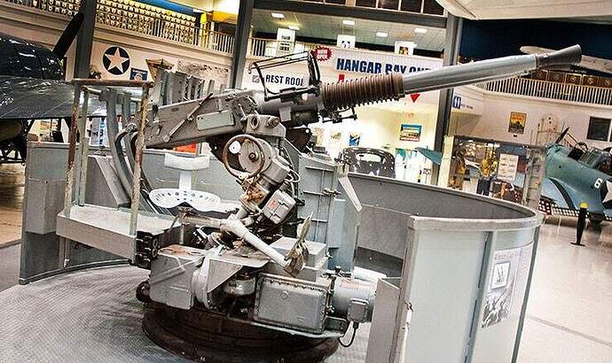

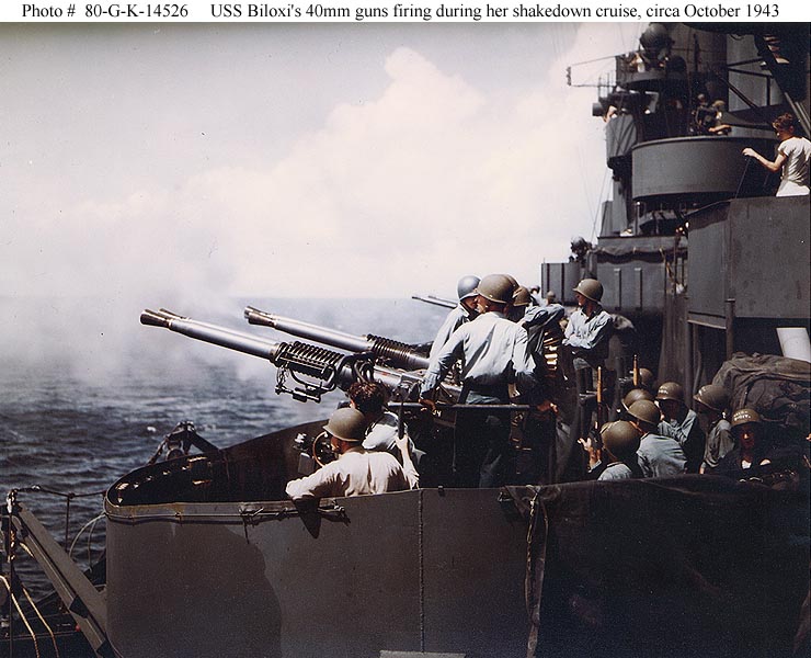

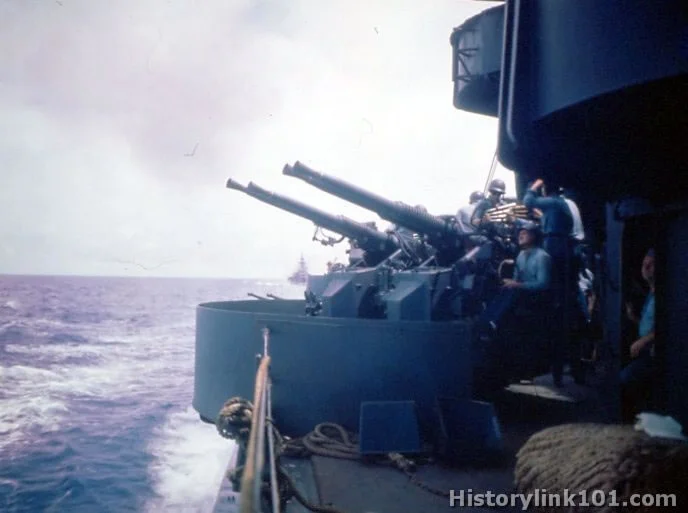

Here are a few examples of 40mm mounts in various schemes
Thanks Stik, great pics
This bottom photo would look great in a 35th dio.
