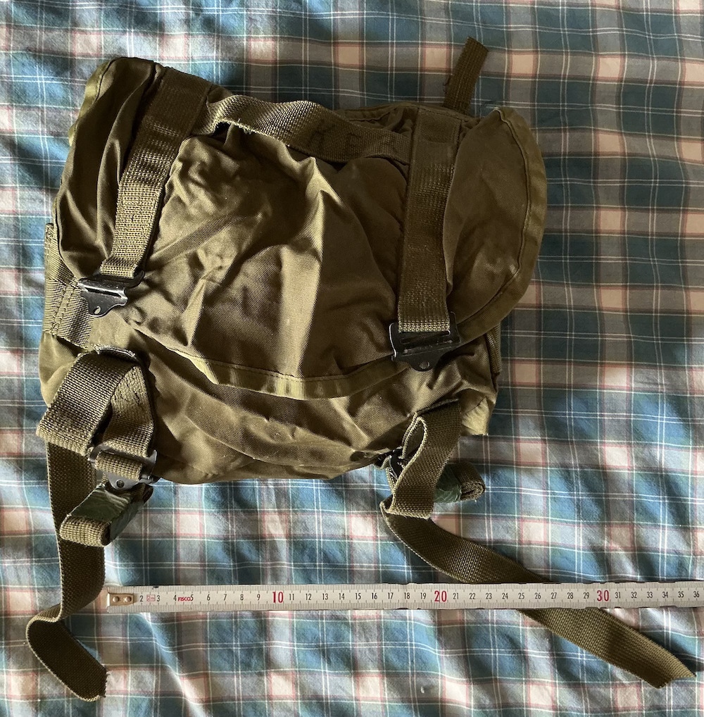

I had several butt packs during my time in service, cotton canvas and nylon. They were all pretty much identical in size. Tamiya made their new ones in the accessories set way too large. But the Tamiya ones will work ok for the lower pack of the M1945 field packs with some minor changes.
The Tamiya one are indeed far too big. Those lines on your cutting mat are 1 cm apart, so those packs are, what, 11–12 mm wide? That would make them about 40 cm IRL. The real thing is more like 20–25 cm wide when it has things in it, and about the same tall, depending on how full it is. It’s also not nearly as nicely rectangular as the model parts but quickly gets rather shapeless if you stuff soft things in it. Here’s an ALICE buttpack I had to dig up from the bottom of a chest full of semi-random kit :slight_smile:

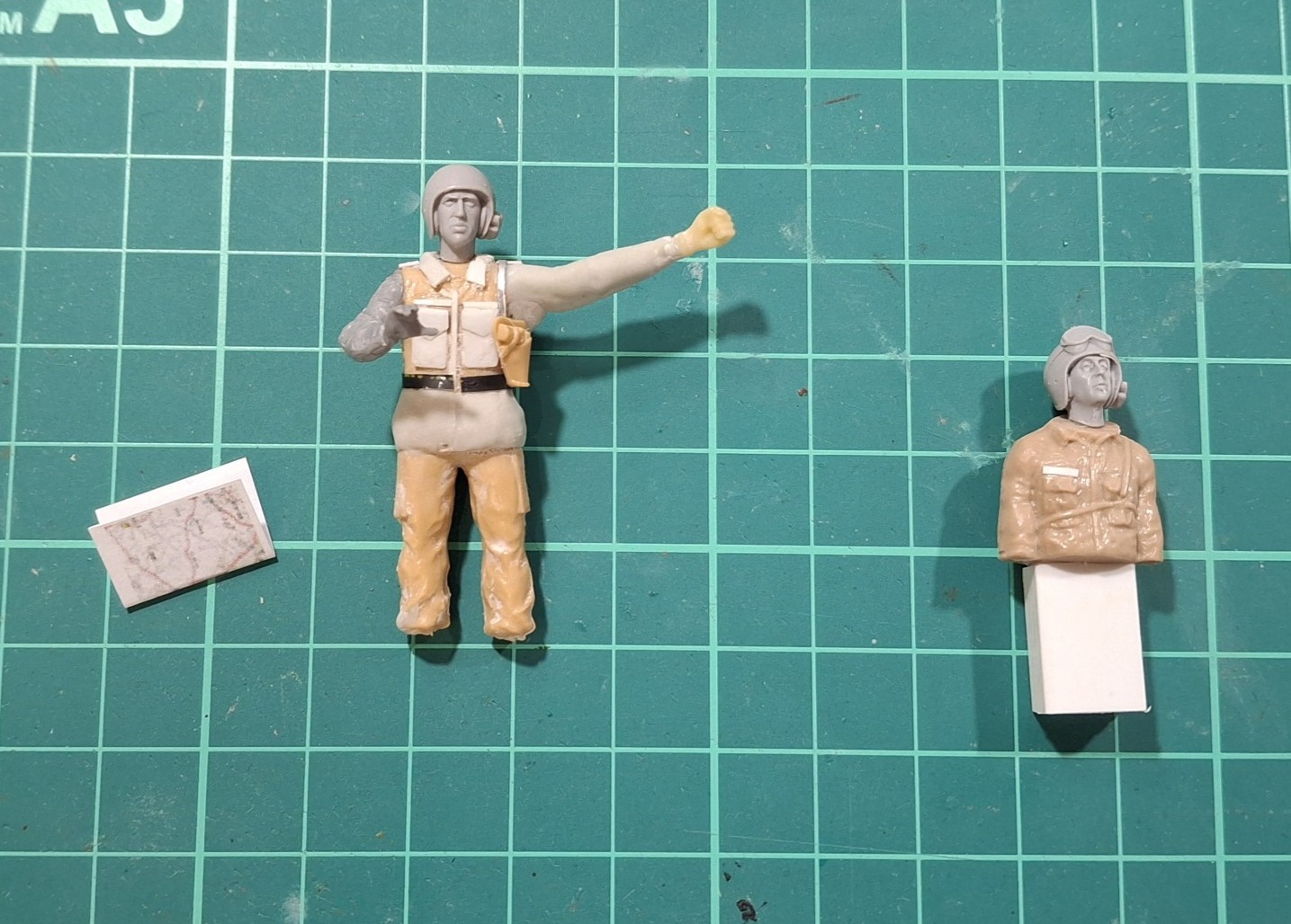

While I’m still mulling over whether or not to tackle packs, a bit more work on the figures; heads now secured though a little Mr Dissolved Putty required to touch up a bit, and the Commander figure has acquired another arm:

Somehow his arms seems a bit long…

There are, but neither of those are what I photographed :slight_smile: The large pack is basically the medium one but a little bigger overall and a fair deal taller, plus with three smaller pockets near the top, above the central one. Oh, and it can only be carried on a pack frame, as there’s no way to attach straps to the pack itself. The one in my photo is a buttpack with two slide keepers on it, for attaching to a web belt. Oddly, unlike the M1956 pattern, there are no rings at the top to hook suspenders to it, though (I’m not sure if the nylon M1967 buttpack did have those, though).

Well, not according to my scientific and meticulous research! I just held the figure up to the image (below) and enlarged the screen image until the sizes matched:
If the head was the same size I reckoned I was “on” and took it from there(!)

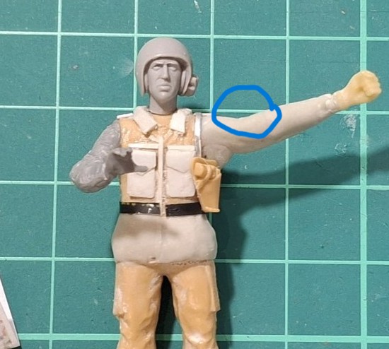

What I think I do need to do is to slightly re-contour the arm a bit:
and sand under the armpit a little more.
Thanks for the input all, re stowage; I think what I’ll do is make a prototype Butt-pack - what type I haven’t decided - and see how it looks.
Brian the arm may be the right length, but the elbow is in the wrong place! From my lifelong study of human anatomy the elbow is usually halfway between shoulder and hand… :slightly_smiling_face:
I think that’s what makes it look a bit long…
Well that’s quite some feat as I didn’t consciously factor in an elbow at all.
Clearly, more sanding required.
