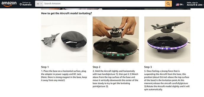

It’s made by Ruixinda - search Amazon (my link won’t work outside Oz) if interested. I guess it proves it can be done, but not so much with your own model.
I guess that huge chunk attached to the airplane beats the purpose

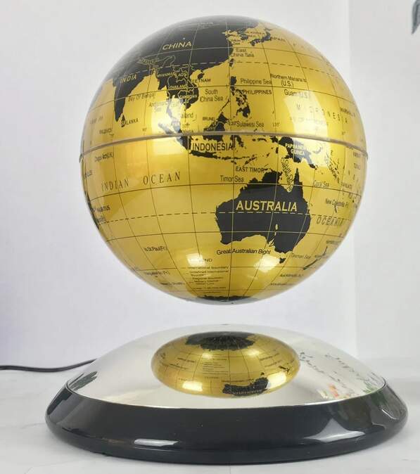

I gave my son this as a present (he absolutely wanted it):
Repositioning it if it has been knocked down is tricky as F***.
It needs electricity to rotate, it rotates by using electromagnets in the base.
If power is lost for some reason the globe falls down.
It works just fine, it hums a little though.
There is just one minor fault, the globe rotates the wrong way,
it has the “sun” rising in the west and setting in the east …
The globe/ball has a hefty magnet in Antarctica, quite heavy actually

The basic fault is that it’s upside down, if you rectified that maybe it would rotate correctly :upside_down_face:
yeah, I always have to try and try and try, it’s tricky but fun to repositioning…
