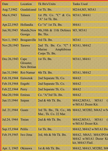

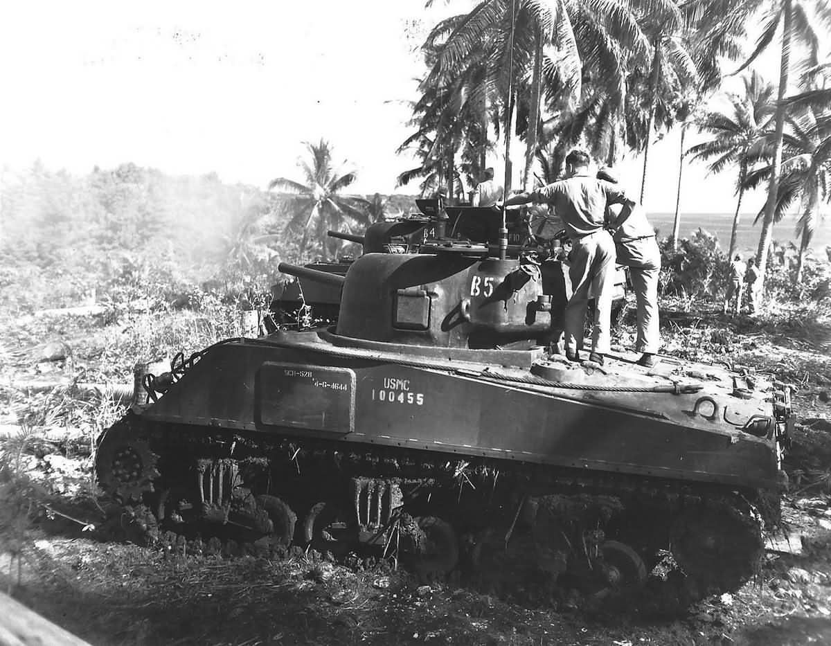

I have yet to come across a photo of a USMC Composite Hull Sherman. Army tank battalions in the PTO used them widely. But the USMC aside from one campaign in 1943/44 used the A2 and A3 in every photo I’ve come across.
Stikpusher
I stand corrected brother… My current research agrees with your info..

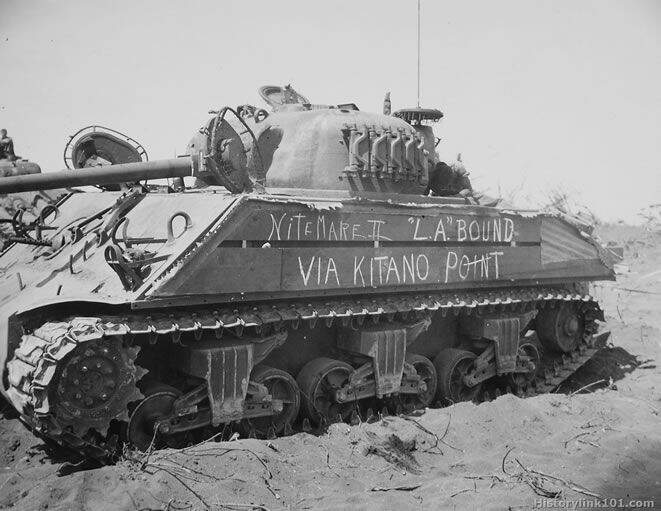

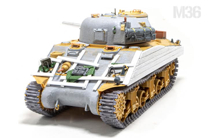

Good luck with your model.Im planning to do a direct vision m4a2 “Jungle Jim” using an Asuka kit which has Value gear add on wood armour etc.Ive also got a Tamiya M4A3 i want to add wood armour and nails on turret hatches.
This is a great model i found a picture of.“Jungle Jim”.
There was a few US Army stock A1s but as you said A2’s and A3’s for the rest of the war.

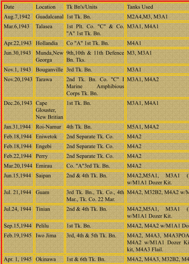

From The Evolution of Marine Tanks

I knew about the A1s being used by Marines on New Britain, but Marine armor being on New Guinea at Hollandia is a new tidbit. I was always under the impression that New Guinea was a US Army/Australian Army campaign while the Marines were busy in the Solomons and Central Pacific. Very interesting :smirking_face:
