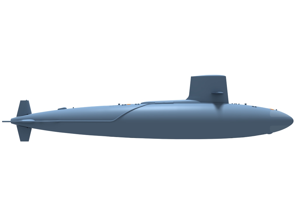

Starting the first streamlined US nuclear submarine build of the Skipjack class. I probably get asked for these from local submarine veterans more than any other SSN.

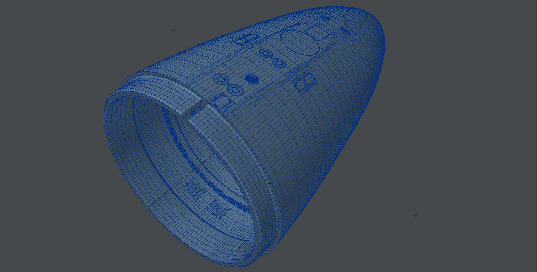

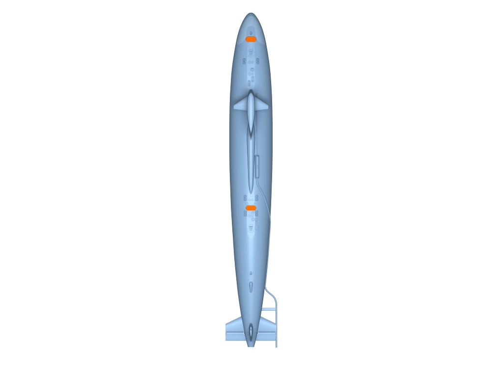

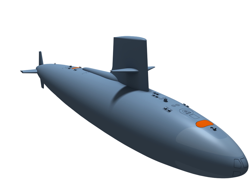

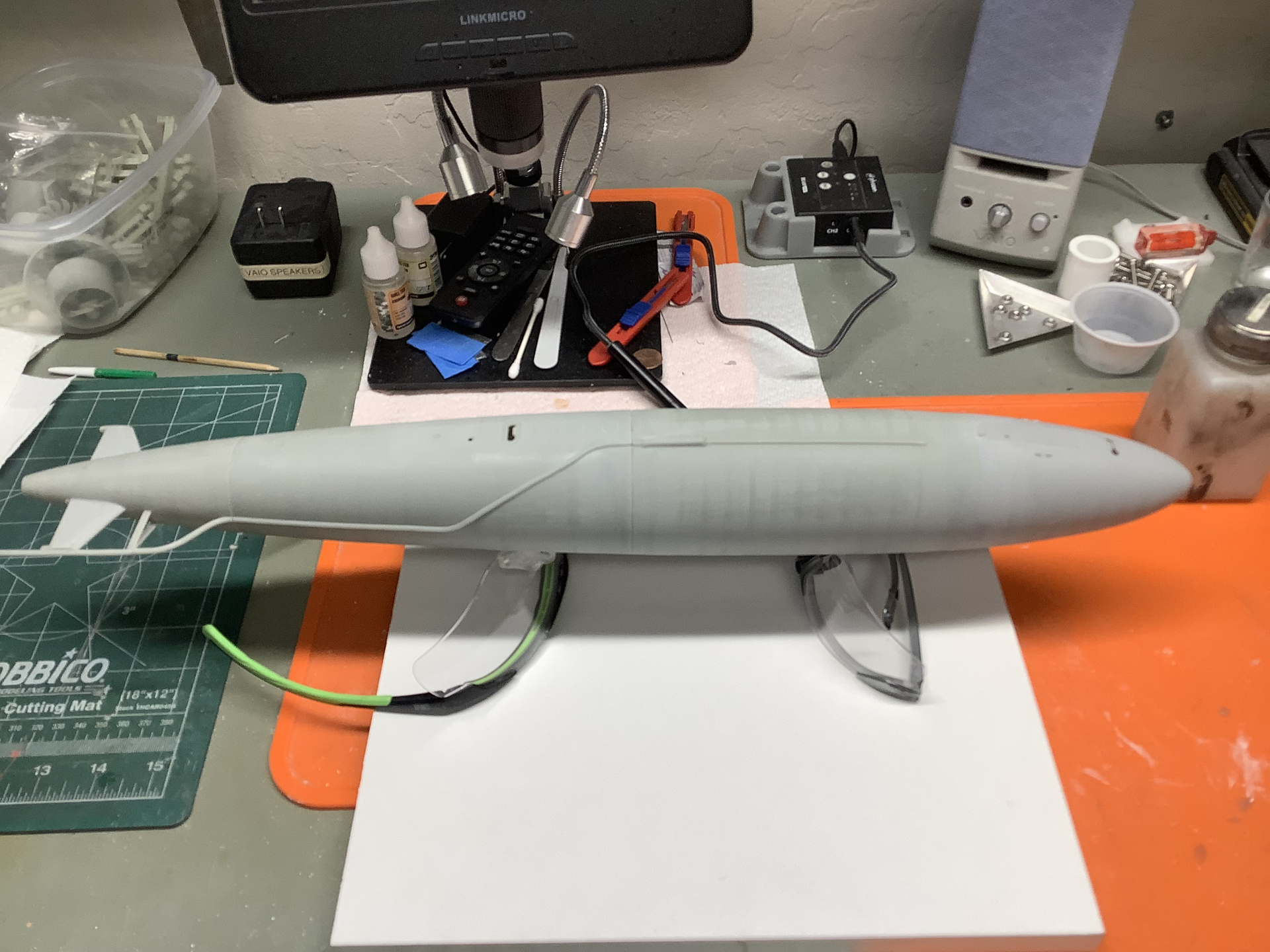

The photos are from the first (1/144) prototype print, about 21" in length. Since then, several changes have been made and once I finish modeling the final details of the outboard hull openings, I’ll print another prototype before moving on to the sail, masts and antennas, which are the visual hook where submarines are concerned, and the highlight of any submarine build.

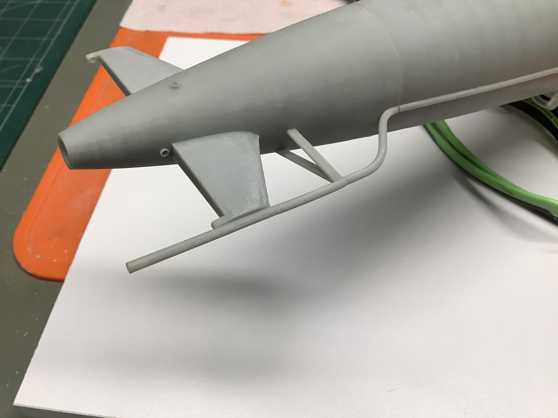

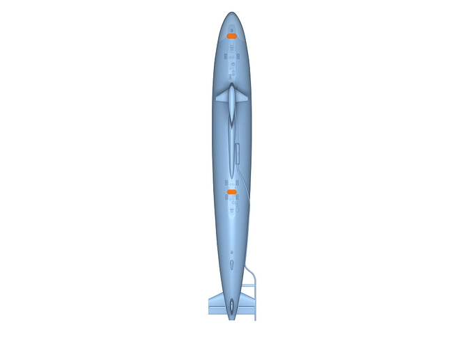

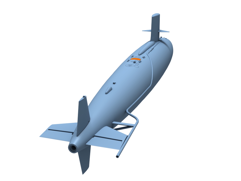

Note: The towed array stowage tube, (added in the '70’s) was deformed where it meets its two support struts. That was one of the first mods done after the first print.

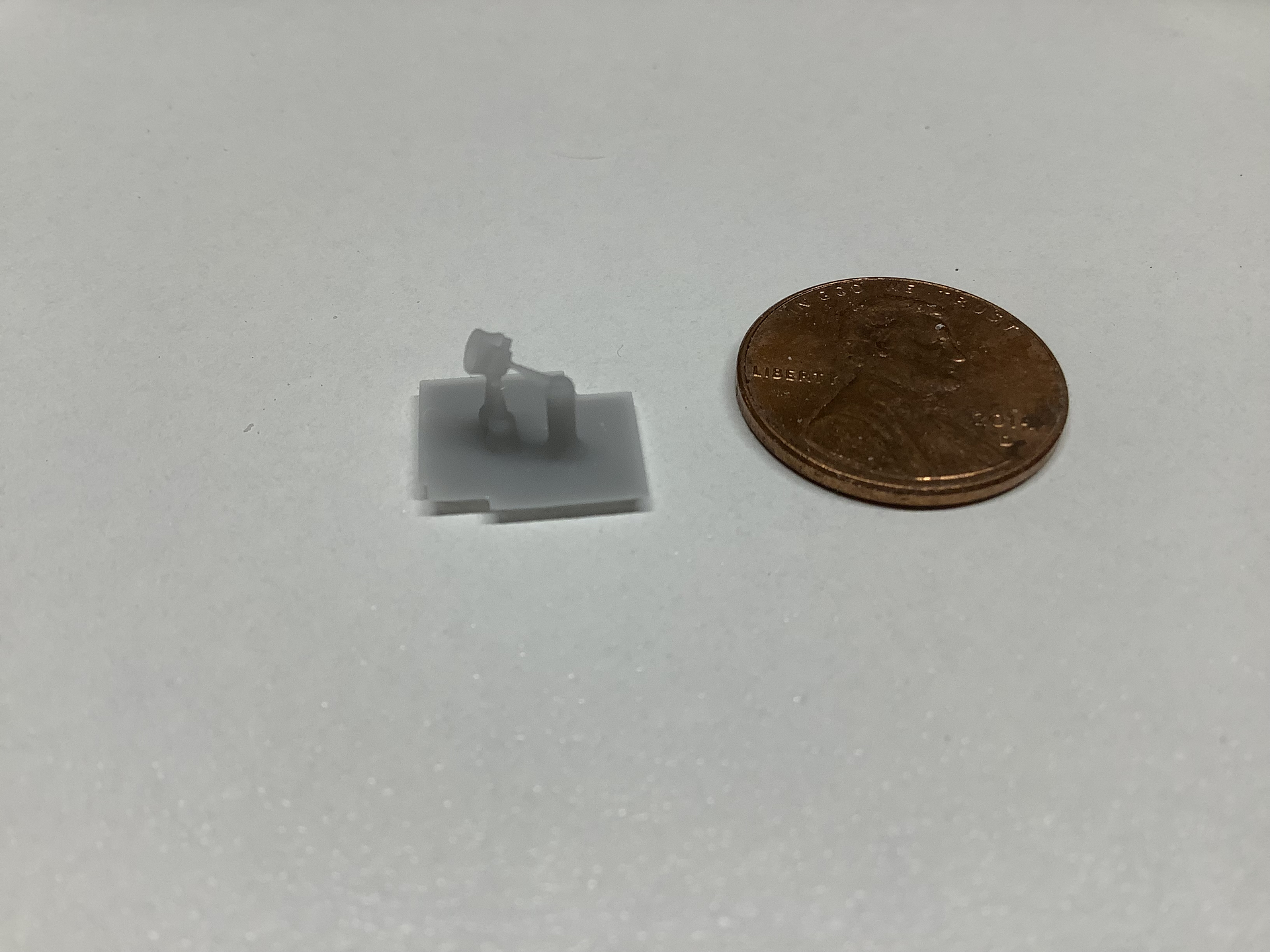

In 1/144 scale, the details are easy to miss unless you get close; in 1/72, they are very prominent.

Too busy modifying the hull to post, but after reaching (and locking down) Version 5, I’m ready to move on to the sail. This (smaller scale) model will be mounted to its base using 1/4" clear acrylic rods, instead of the fasteners I thread into the hulls from the bottom of the base for the larger (1/72) models. There are too many mods, (both external and internal -for ease of printing) to list, but I’ve received some great feedback from former crew members. There are two versions of this hull; an early and late configuration. The final V5 hull sections should be finished printing this afternoon.

Creating hyper-detailed 3D submarine models isn’t half as challenging as building, highly-detailed, “3D-Printable” models that consistently print well. V4 had a horizontal tear across the EPM (Emergency Propulsion Motor) which required extensive internal support changes to ensure the MBT flood ports would print in thinner areas without resin clogging them. Typically, I use my airbrush compressor set to 60 psi to blow resin out of thru-holes and indented details before I ever begin cleaning the parts with IPA. Resin printing is a mess, but the details and minimal sanding for a smooth surface is compensation.
