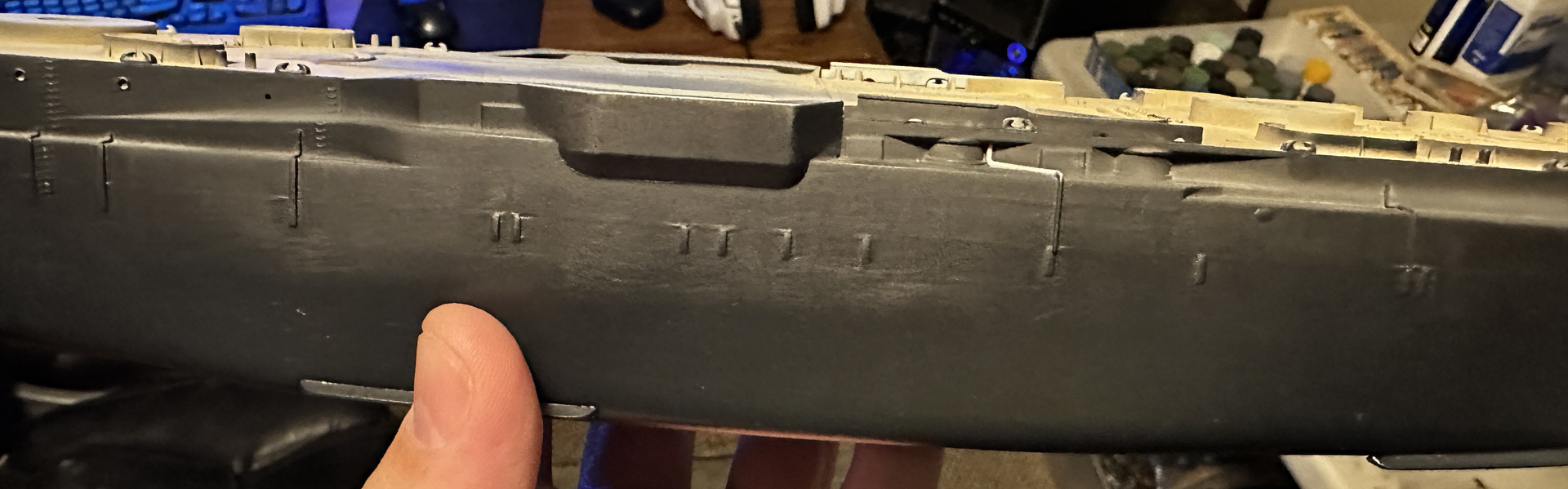

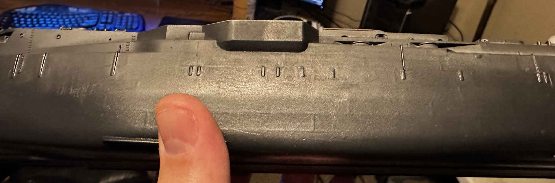

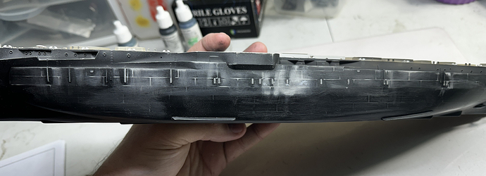

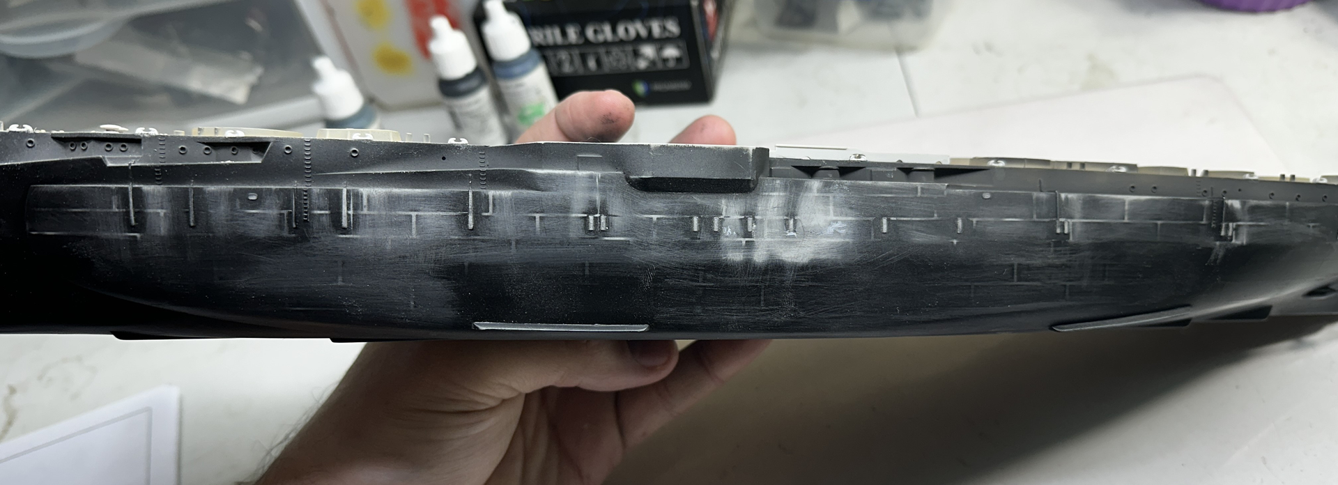

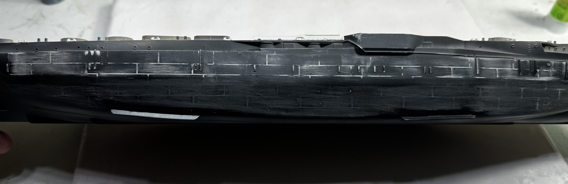

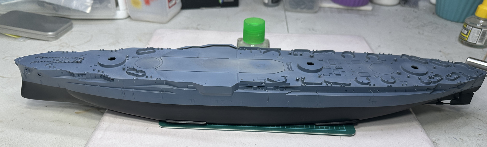

This weeks progress. I applied my black to the hull and the massive plate lines were still showing up. So back to sanding I went. I have hopefully gotten them all knocked back.
You can see just how much more needed to be sanded.

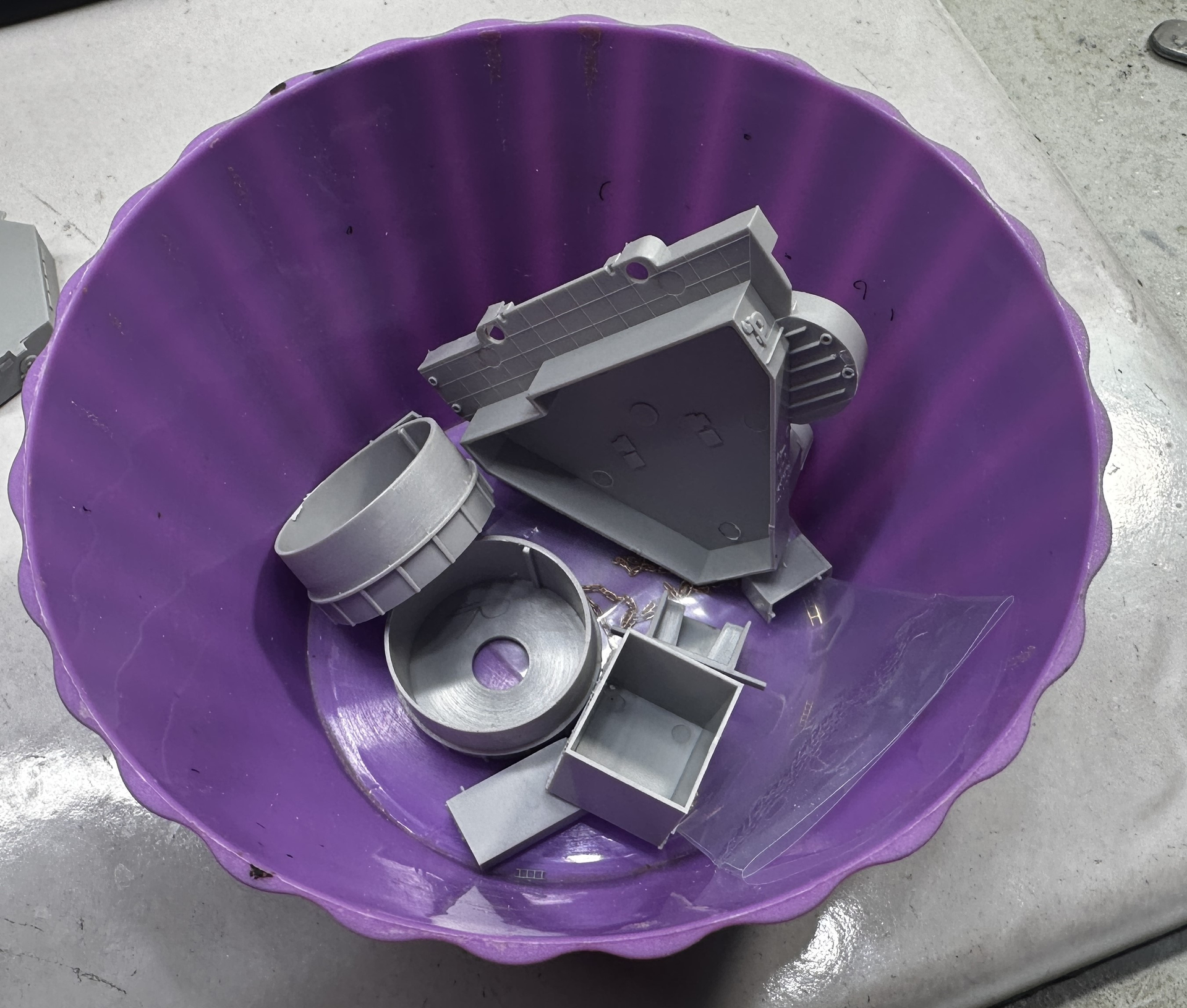

Lastly my Tub O’ Superstructure :smiley:

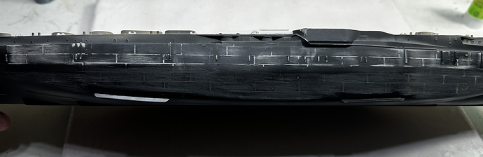

The black is back down on the hull and I am pretty happy with the result.
I also achieved what I wanted which was to leave just the faintest impression of plating. If you look at the ship directly side on it looks pretty smooth.
But if you angle it a bit to the light is reflecting you can still see the plate lines. I know they are still massively overscale but they are honestly pretty invisible most of the time.
MUCH better hull plating!

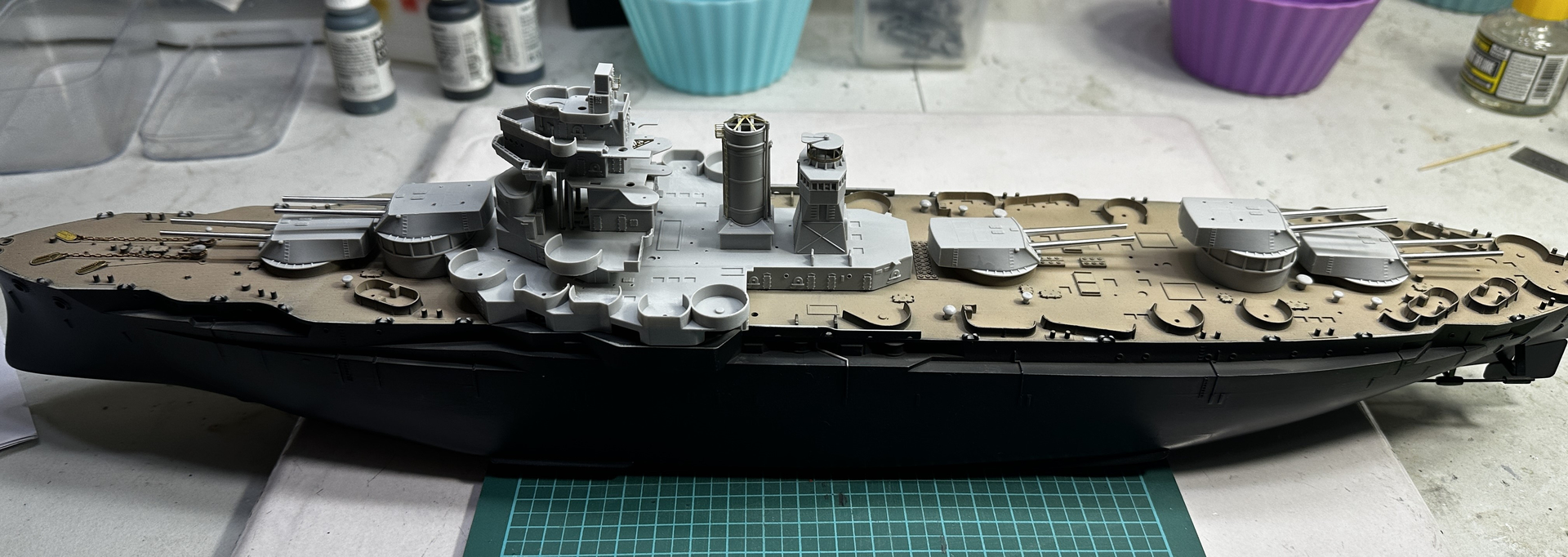

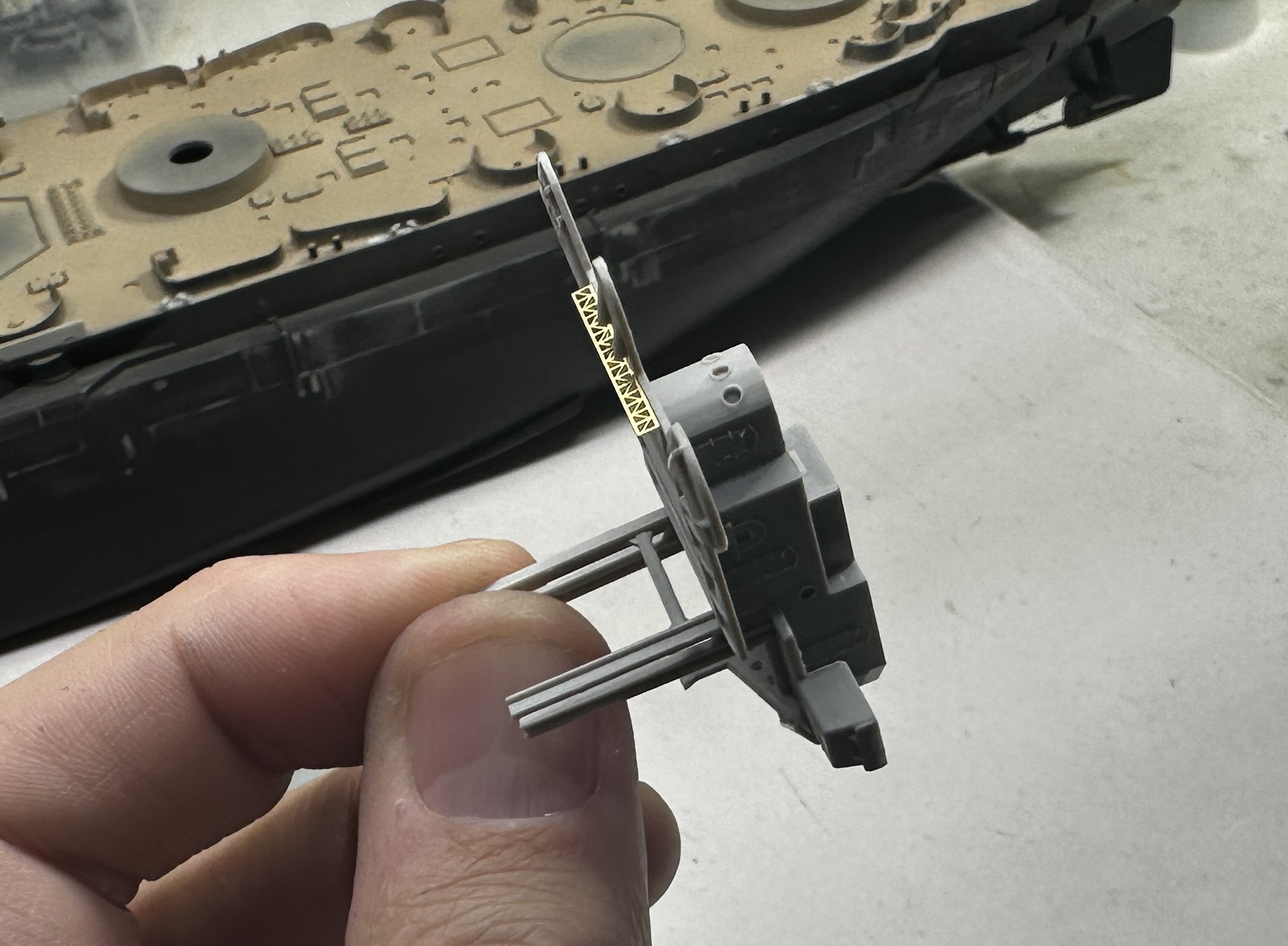

Bit more work done on Texas over the last few days. Main focus was on the turrets which were a bit finicky with the turned barrels but overall came out looking good. Also worked on some superstructure bits and added some of the main deck gubbins such as the mushroom vents and anchor chains.
Here she is dry fitted. Starting to look like a real ship now.

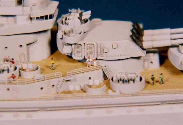

The most striking aspect of a museum ship is, in my opinion, the presence of civilian visitors.

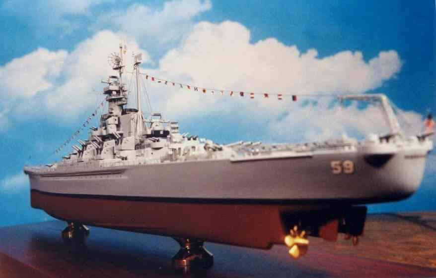

On my Massachusetts build there are lots of people on board - even women and children! These unexpected, non-uniformed characters in bright clothing really help sell the museum ship narrative.
Other clues would be non-military flag display such as the fully dressed ship with two U.S. national flags, and the waterline painted much lower than in service since the museum ship rides higher with no fuel, ammunition or other stores aboard.
In the case of the Texas there is the additional clue of that all-black underwater hull!

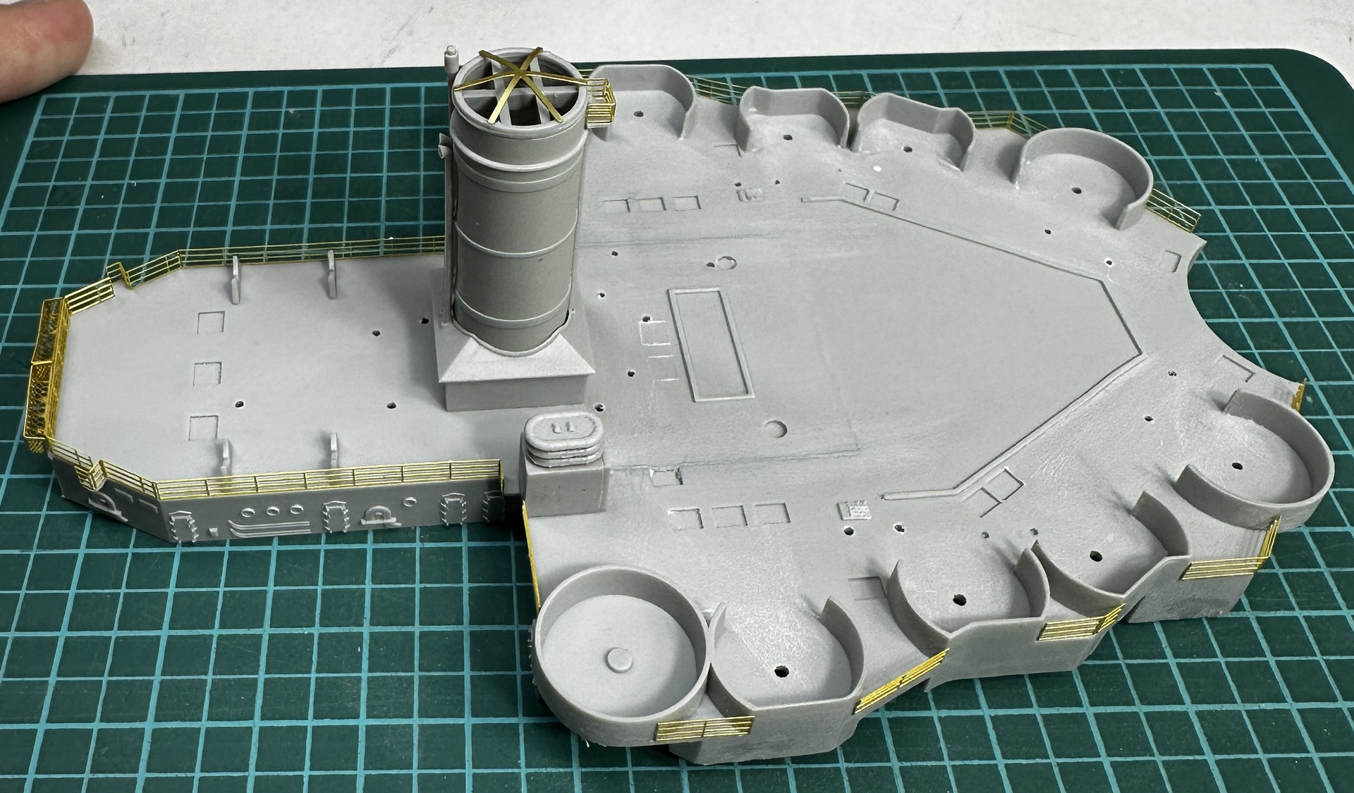

The majority of my subassemblies are built from their plastic parts. Now I need to start adding the PE.

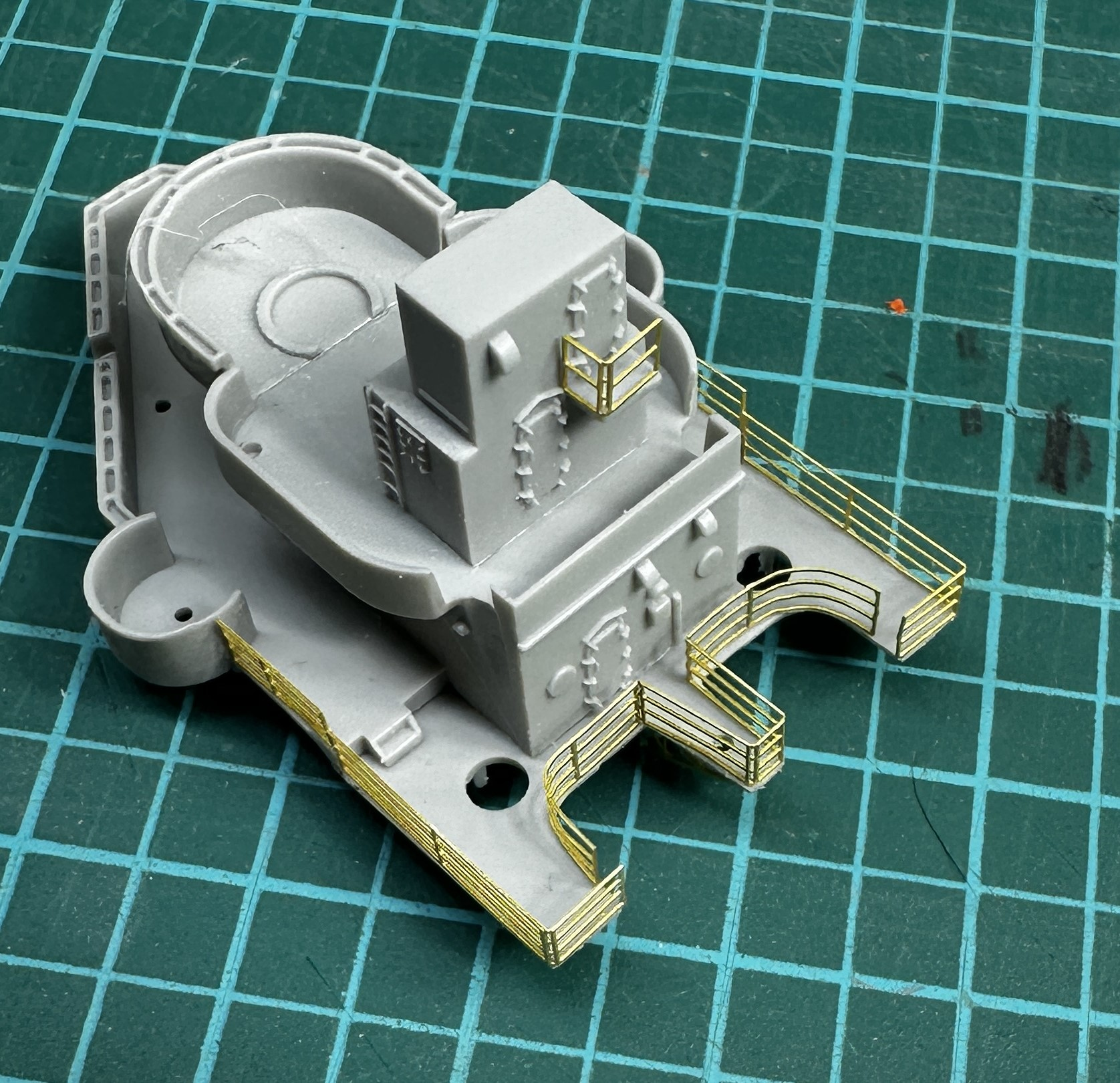

First up is some railing. I am pretty happy with how this came out since it had some fun curves to do. Not the worst but curves are always a pain.

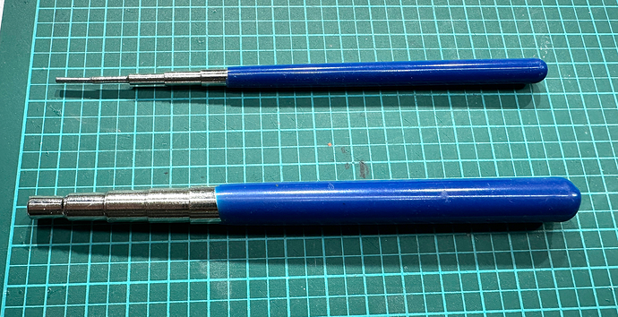

For now I have my trusty mandrels. Got them cheap at Michael’s a few years ago and they work pretty well.

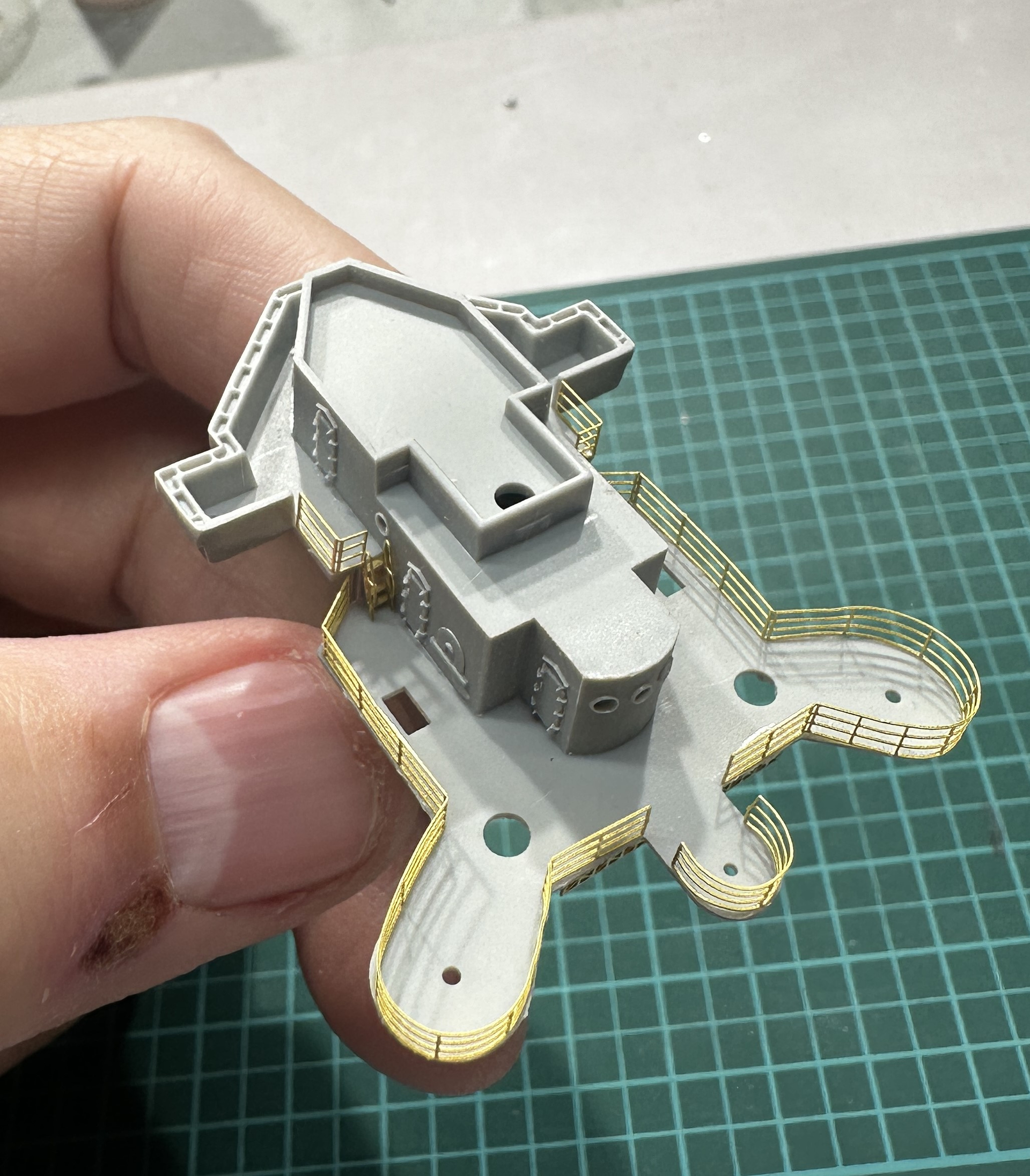

Did more PE work today. Mostly straight runs but a few more curves and fiddly bits.

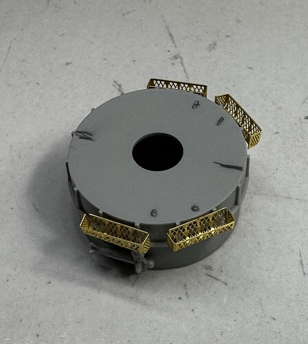

Float baskets added to the forward barbette. I am enjoying the railing. Its nice and chunky so takes a bit of a beating and is forgiving of mistakes when bend in the wrong areas.
Railings and baskets added to the first deck level.

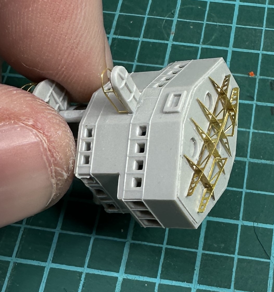

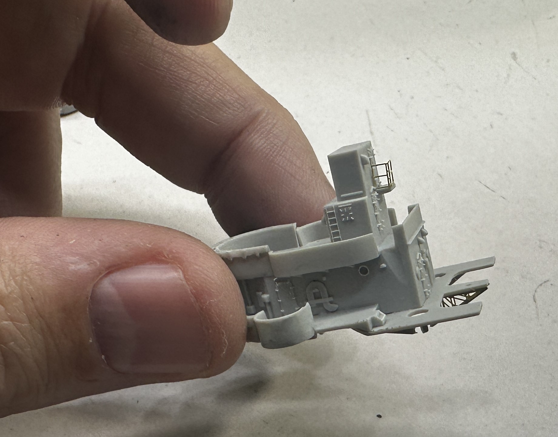

Topmast - Top
Topmast - Bottom. This was fiddly, trying to line these all up and get them to stay in place.

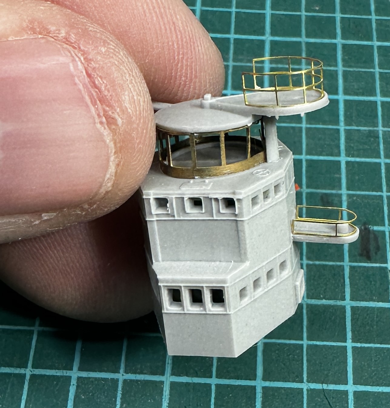

More bridge superstructure.
Still quite a bit of PE to add to these areas before I can get some paint down. However I am getting there.

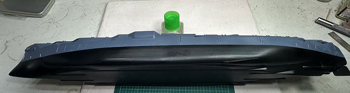

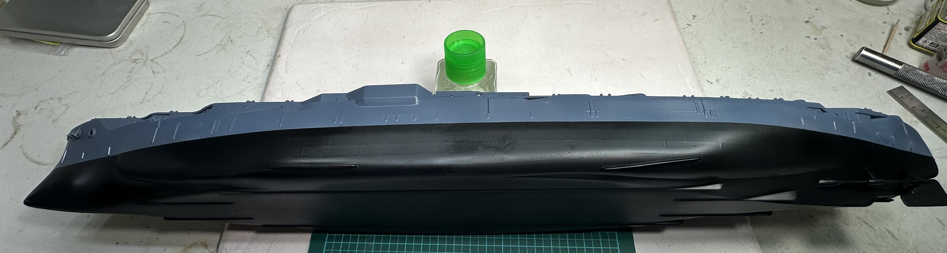

Slow going on Texas over the last few months but there is finally progress. I have put paint down on the hull and superstructure parts.
This shows a good example of the sanded down plate lines just showing through. Still overscale but its good enough for me since they are barely visible.
Not going to lie, the black lower hull just looks weird to me. But it is a nice contrast to the blue.

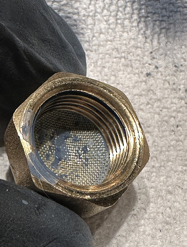

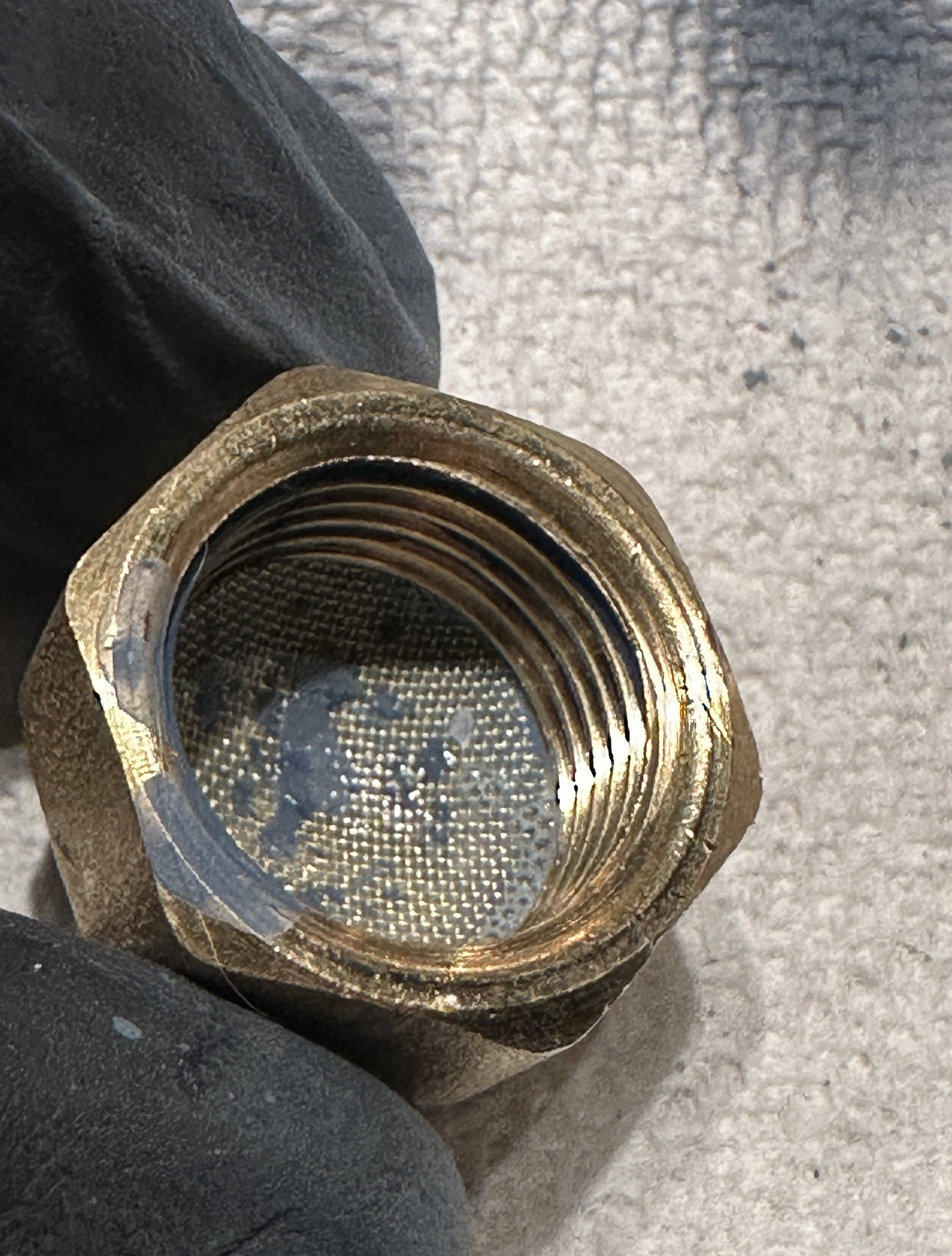

I had the devil of a time getting the blue down. I used a mix of Vallejo paints and they are older bottles. Lots of gunk and particles which kept gumming up my airbrush.
I went online and found a great video about making my own paint strainer. 100% credit to the “Airbrush Down and Dirty Tricks” channel.
Airbrush Paint Strainer #tutorial
Using a brass nut and a pipe strainer I was able to make a pretty effective strainer for about $10 and which will last me forever. After using it I had no more issues. You can see how much crap was left behind after straining.

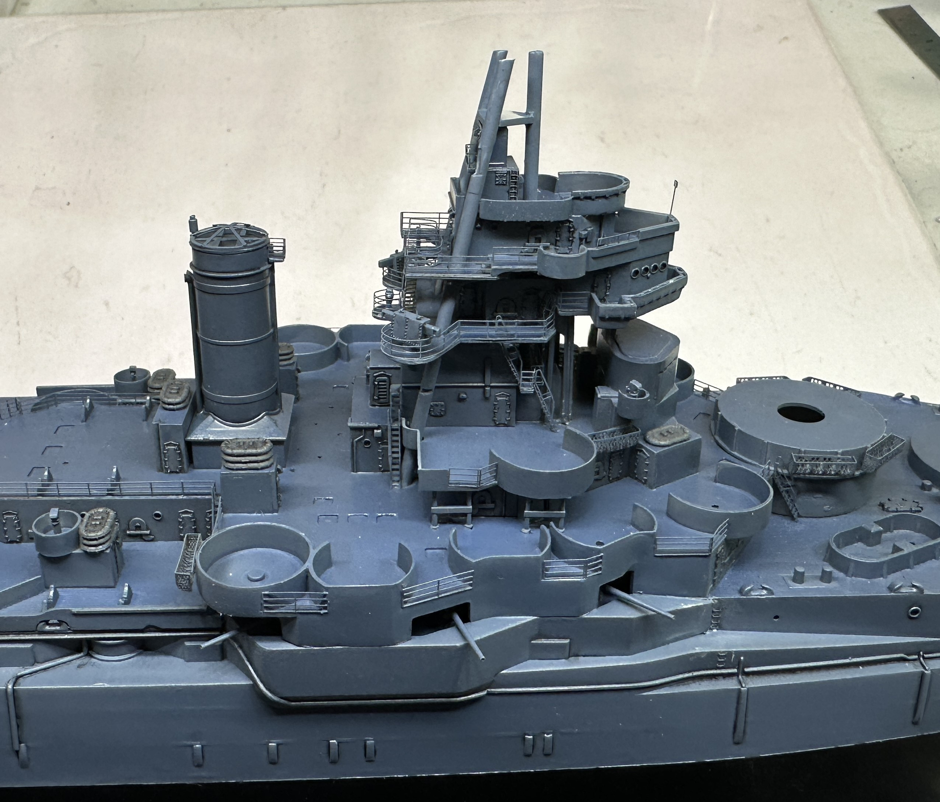

That being said, I was able to spray and pinwash the superstructure and have slowly been adding it to the ship. It was not as easy a process as I would have liked and its been messy. Lots of touching up to be done.
Still, looks pretty good :slight_smile:

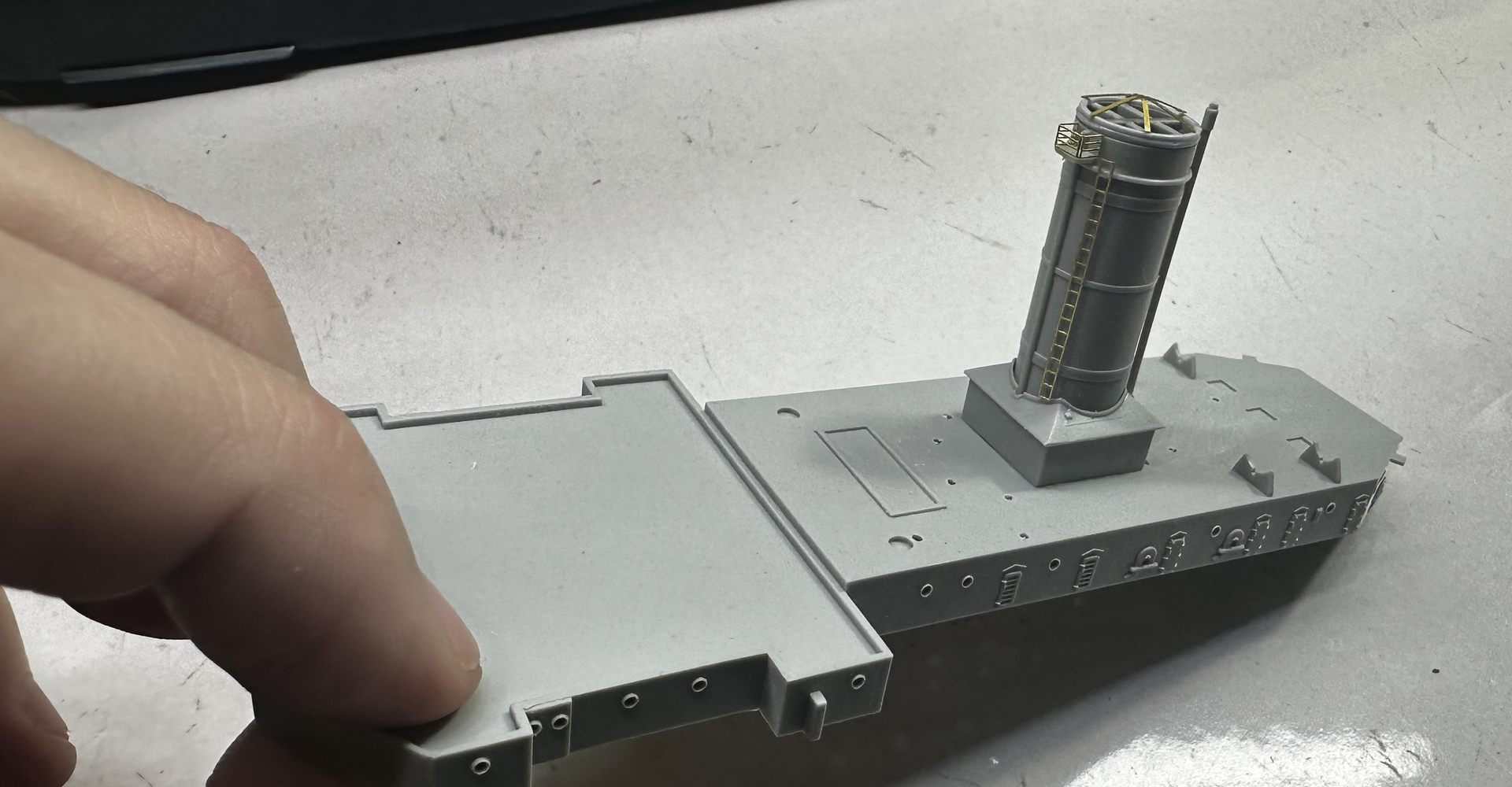

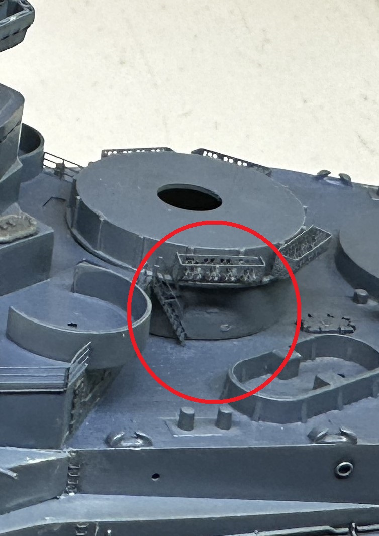

A word of caution to anyone who see’s this while building Texas. The instructions are vague about the placement of the paravanes on the forward barbette and seem to indicate they be glued towards the back. Don’t do this as I did because that will block the placement of ladders later on.
You can see where I had to pull mine off here. Fortunately those marks should be covered once I reattach them later.
