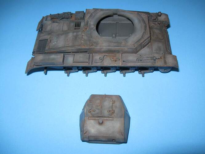

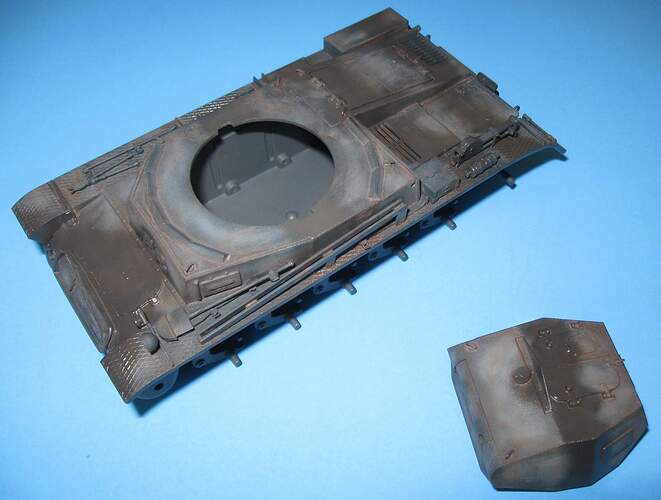

More progress on my wayward Panzer II.
Using 91% alcohol and cotton swabs, I removed as much of the Vallejo paint as possible without damaging anything. Even after three or four days, alcohol took the Vallejo paint right off. To my surprise, it also took off the Model Master enamel Panzer Dark gray!
I washed the model again and will repaint everything in the next day or three.

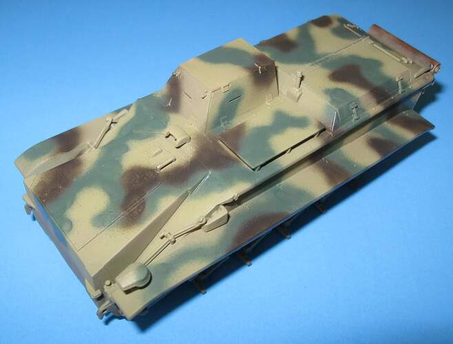

This is the Bogward IV I pulled out of the trash, performed surgery on, and repainted. My airbrush has too settings–clog and splatter.

From what I see on the Borgward camo, your paint is too thin and/or too much (pulled the trigger too far back).
Clogging may be caused by insufficient pressure or needle too small, in any case cleaning the tip of the needle usually solves the problem.
