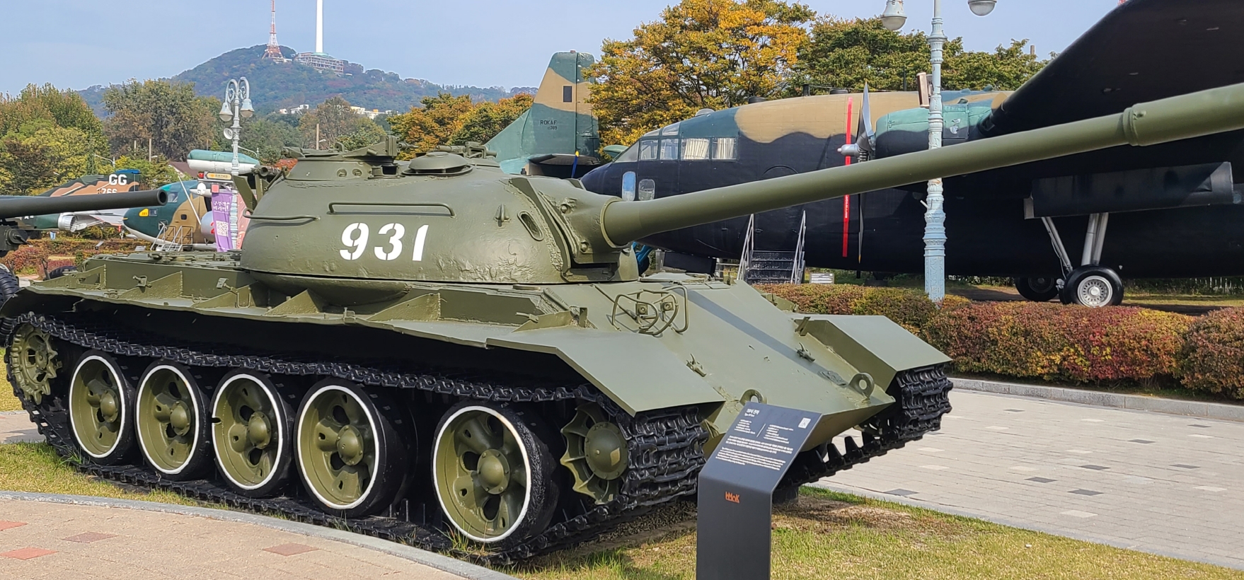

At the War Memorial of South Korea, a Chinese-made Type 59 main battle tank and a Type 63 light tank are on display. The official description claims that these were captured by South Korean forces from North Vietnamese troops during the Vietnam War. However, the reality is more nuanced.
During the North Vietnamese Easter Offensive in 1972, these tanks were abandoned following joint air and ground attacks by the U.S. Air Force and the Army of the Republic of Vietnam (ARVN). Then these Tanks were captured by the South Vietnamese force and gave it to South korea as a gift to gratitude of participated the war.
By 1972, most of South Korean combat troops had already withdrawn from Vietnam, leaving behind only small numbers of non-combat personnel stationed in major cities. Therefore, it is unlikely that these tanks were directly captured by Korean forces in battle.

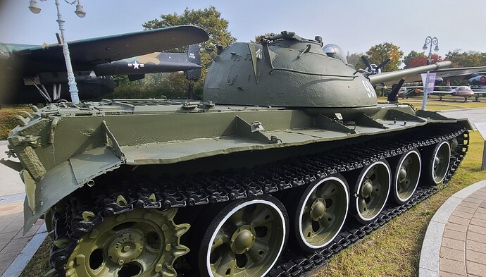

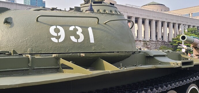

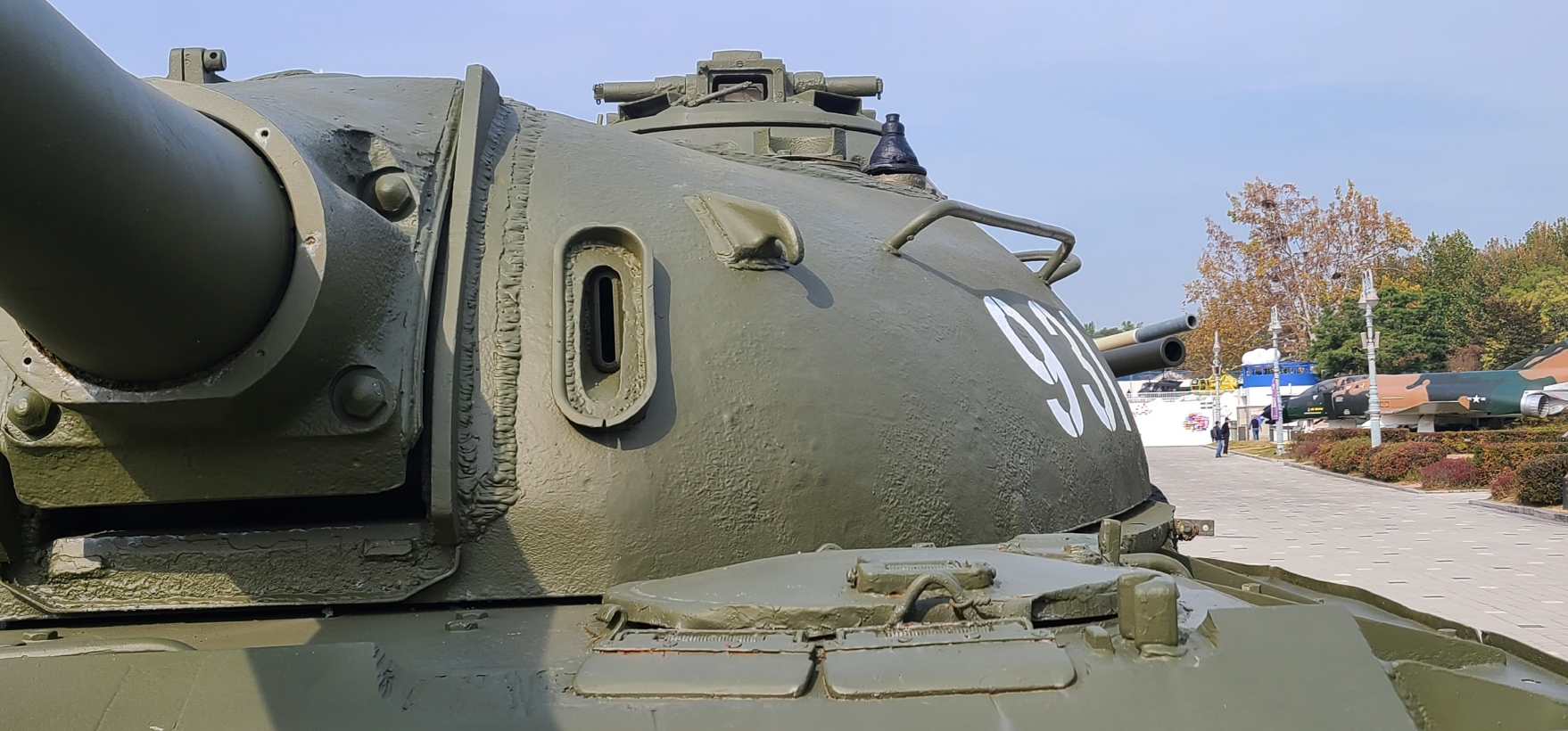

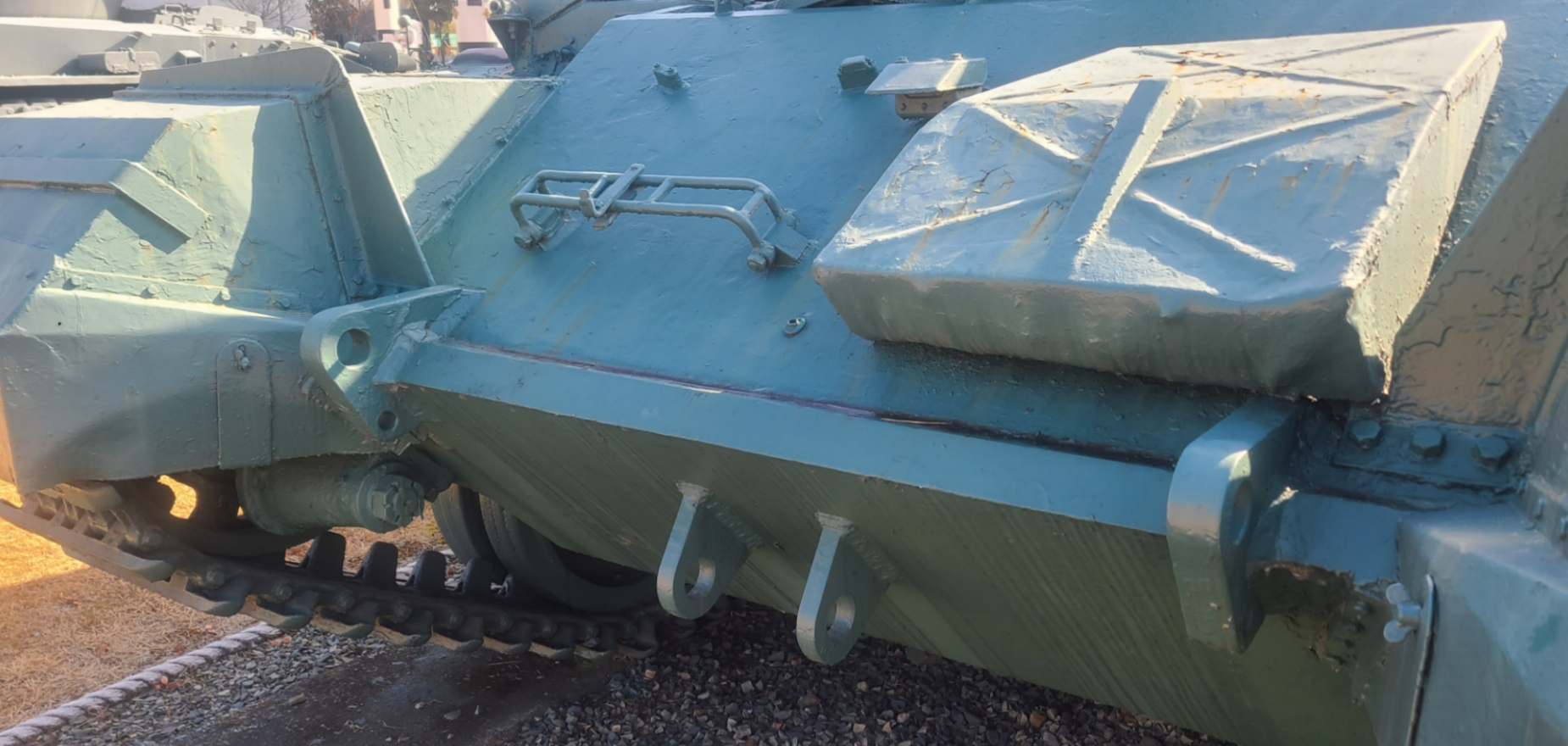

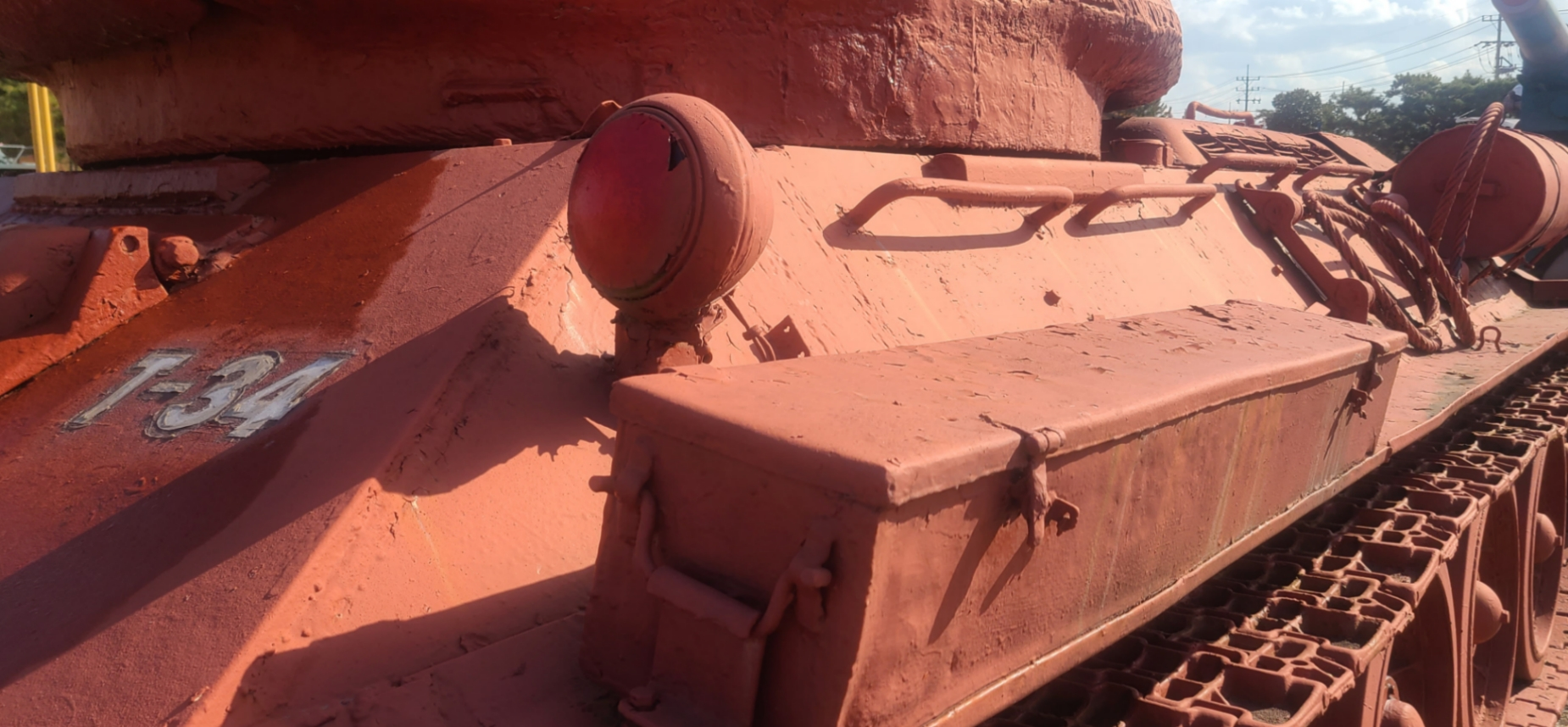

These exhibits are merely empty shells. because, there is no tool boxes on side of hull.

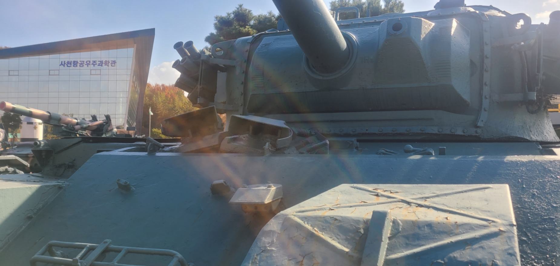

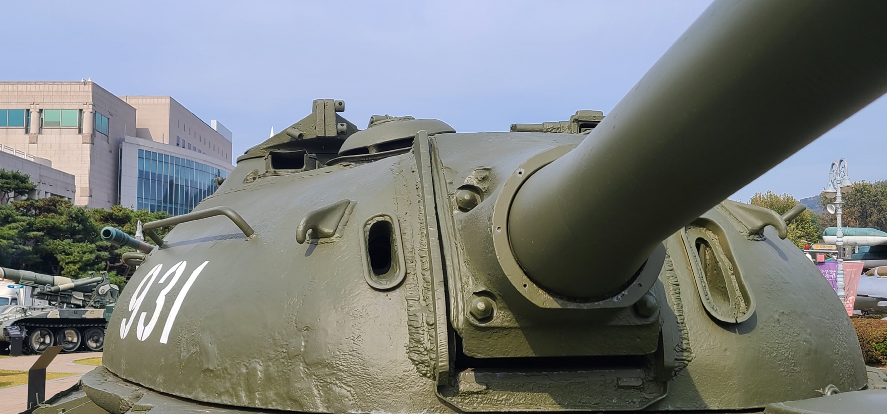

No Mantlet cover and Coax MG, and bulletproof window of gunner’s scope.

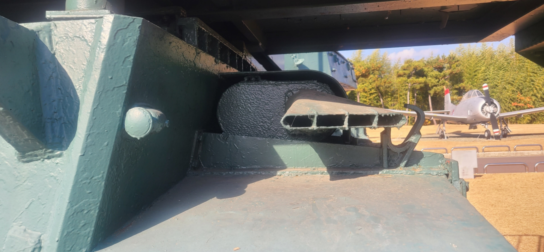

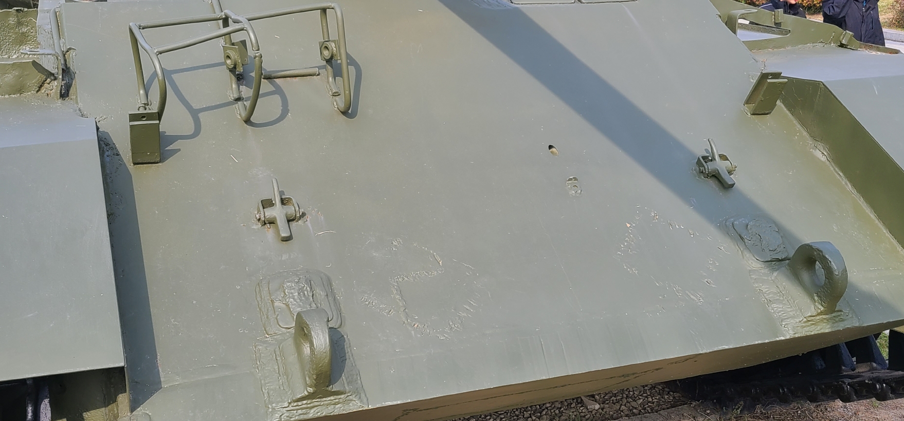

there is no headlight and splash board. and the shackle was removed and changed something else. It appears to have been modified to allow easier lifting or drag by crane.
Also, They removed original front fender and replaced hommade looking design. Who did this? In 2006, The Army of 80th Repair Battalion did it. I don’t know why they did that.

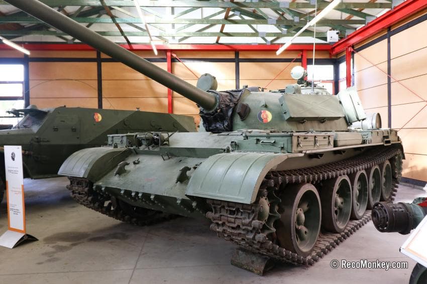

This is what it should look like originally.
They removed auxiliary fuel tank installation too.

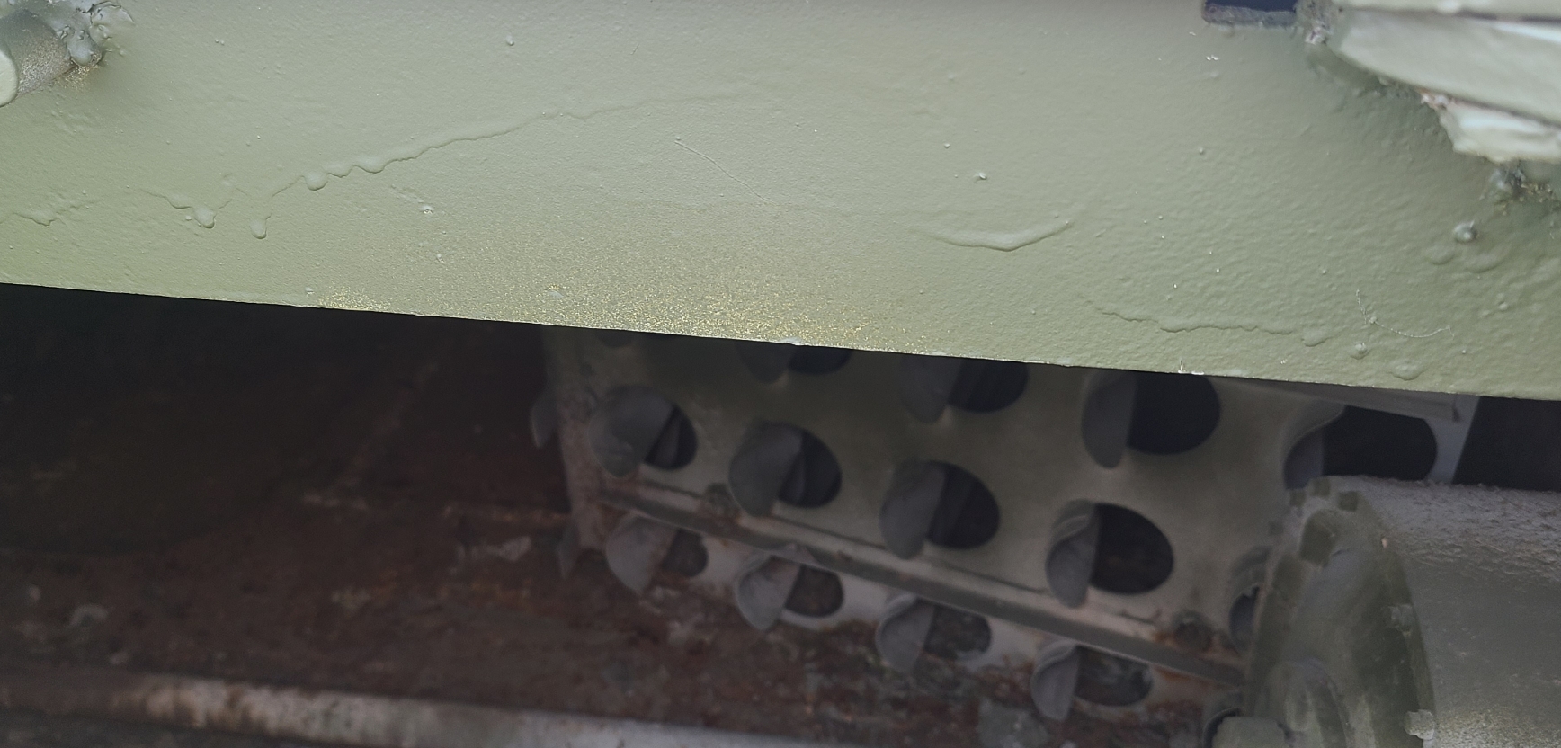

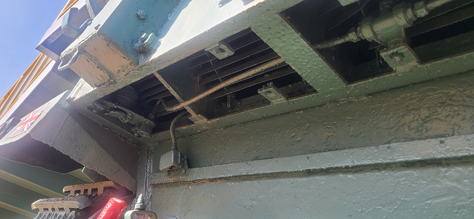

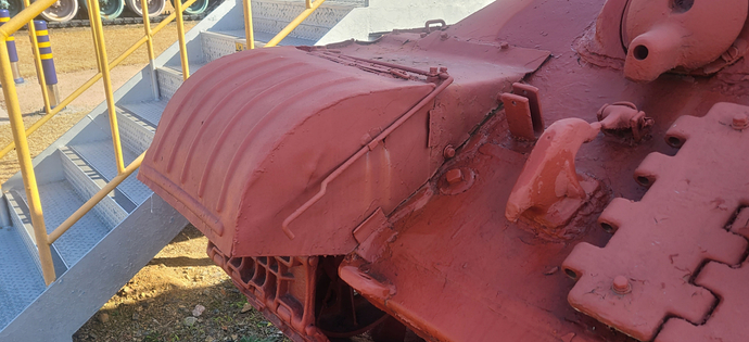

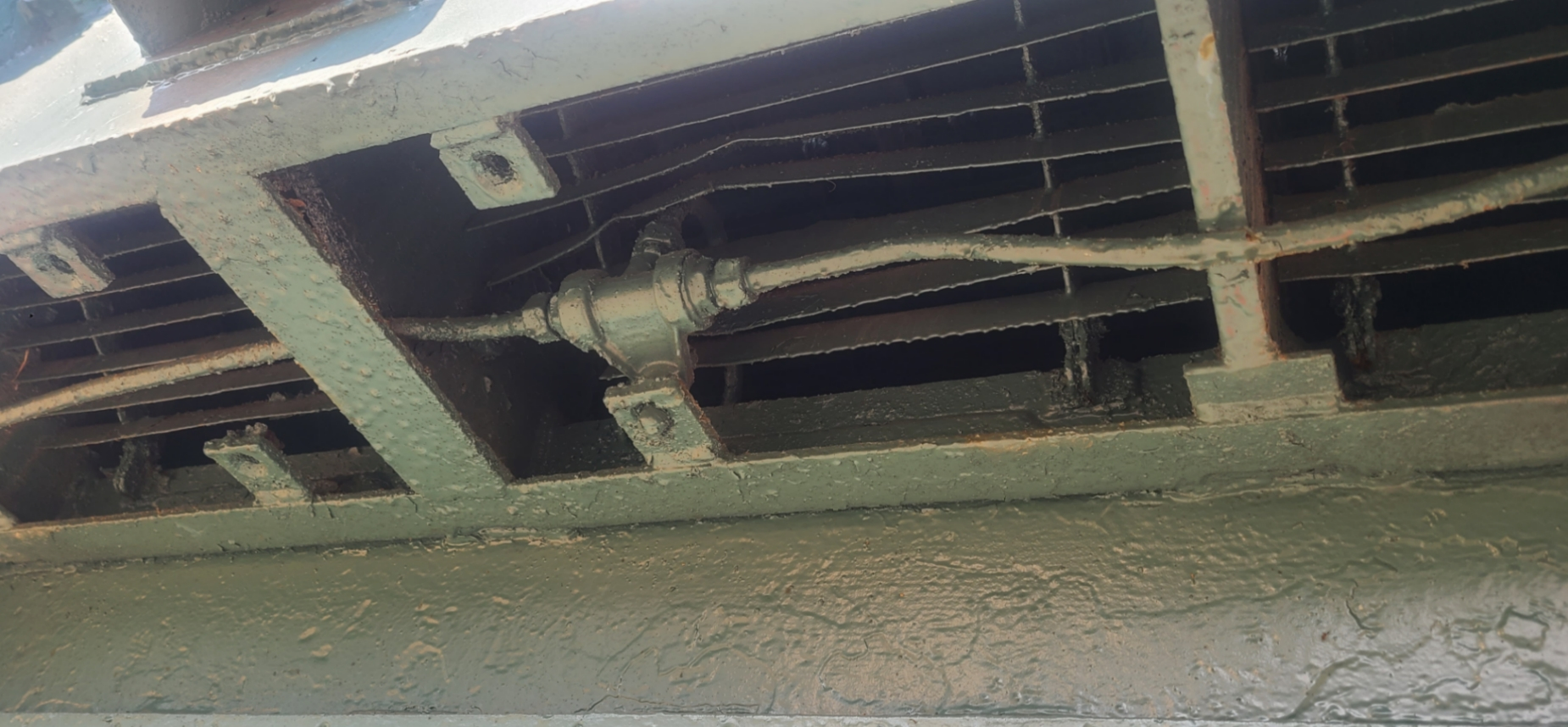

The transmission door is missing, so you can see inside from here. There is a Main ammunition racks. this racks has been moved to engine location. idk. There is no engine, transmission anything at all. so that’s why shackle is removed and changed something else.
There are no single fuel tanks either.

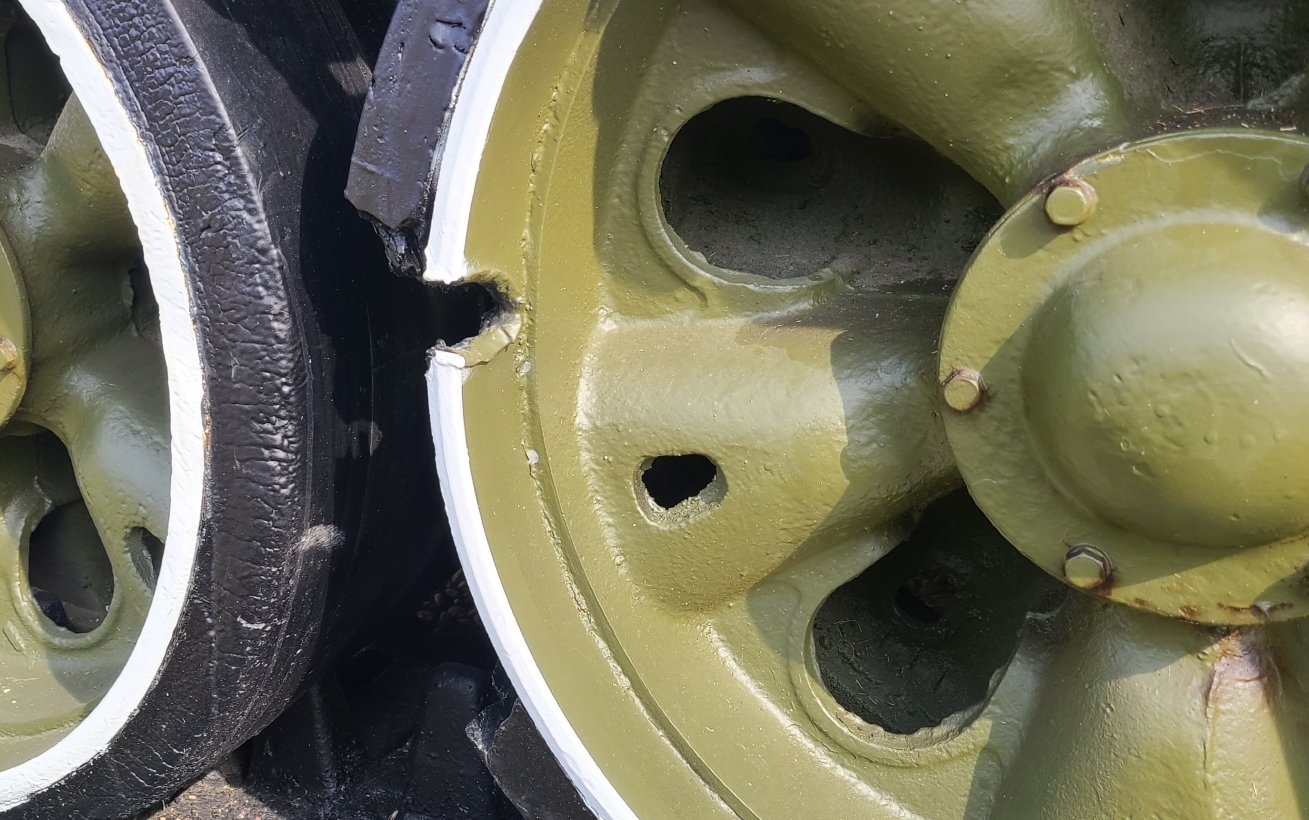

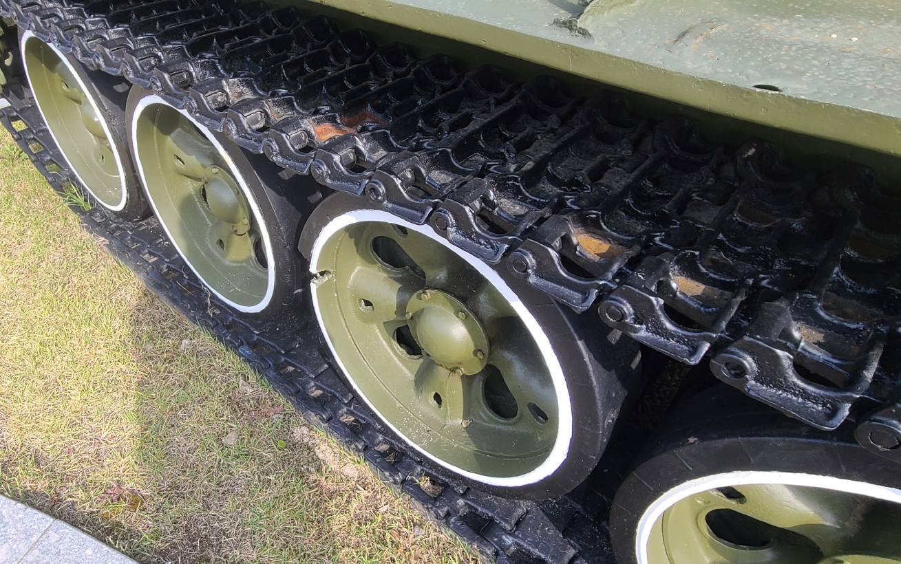

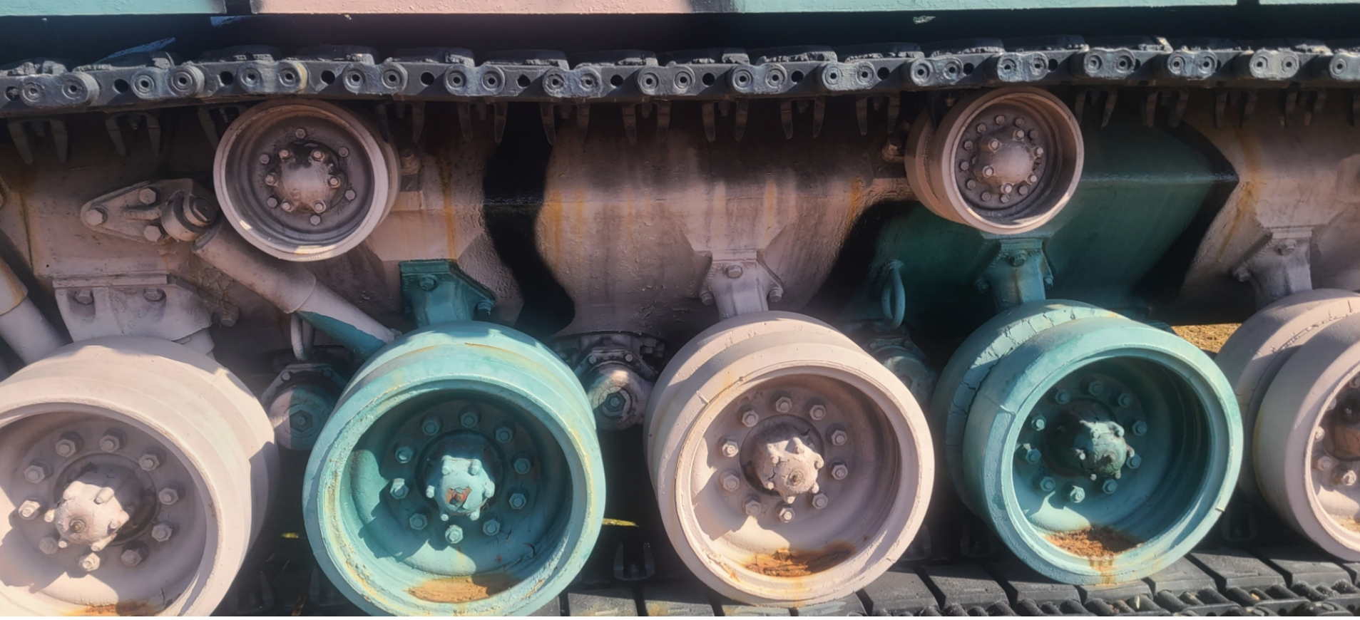

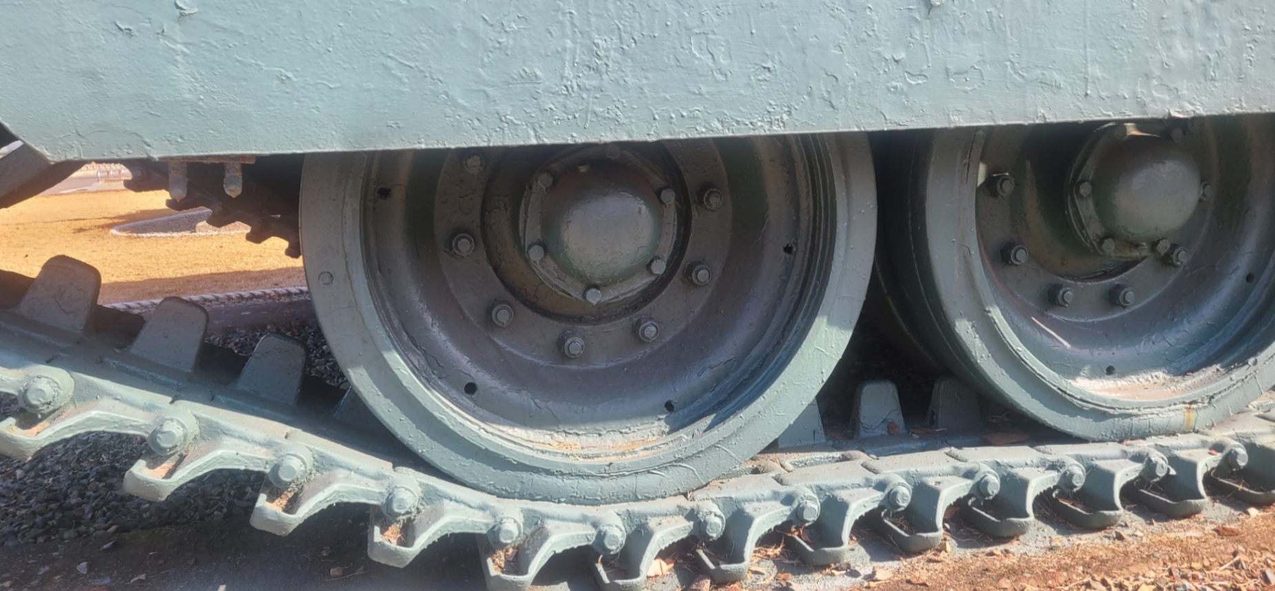

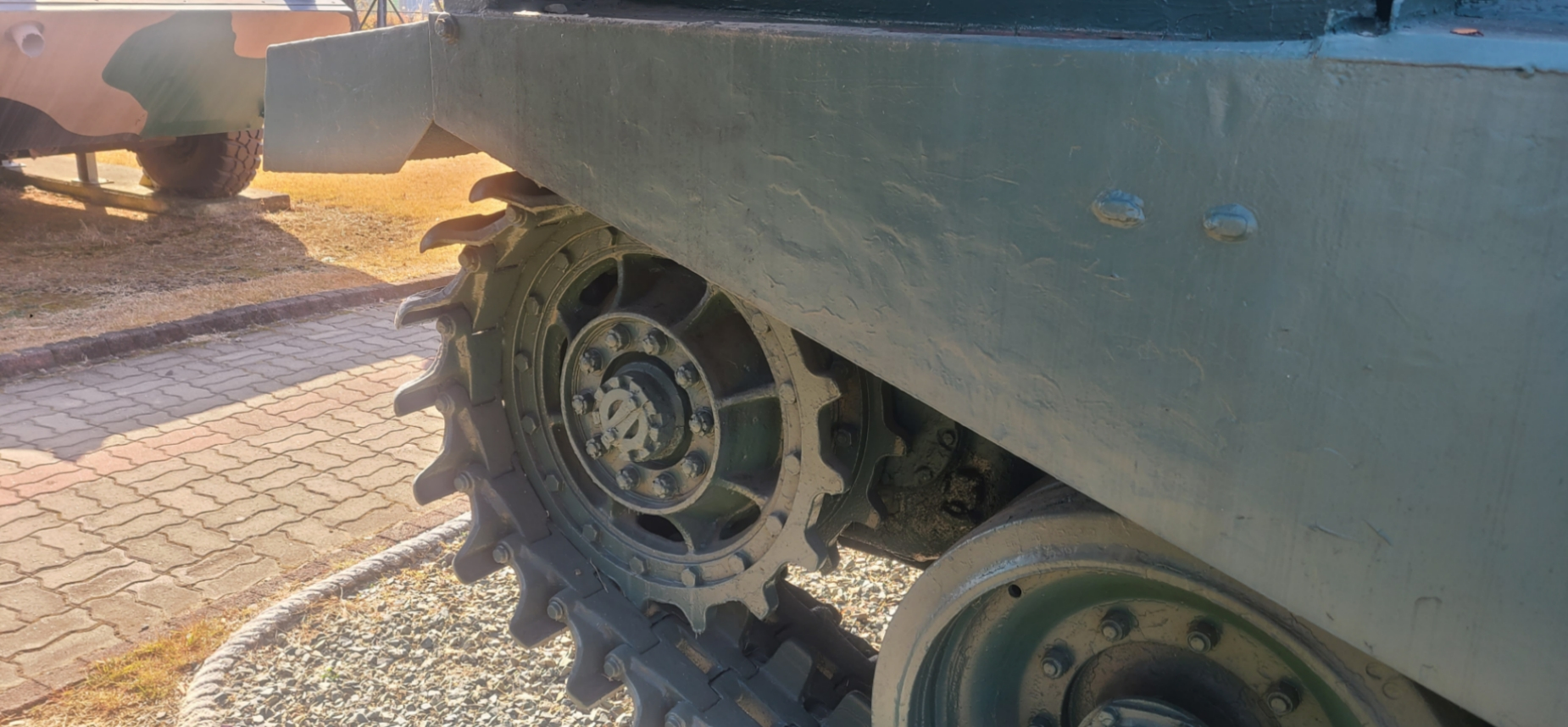

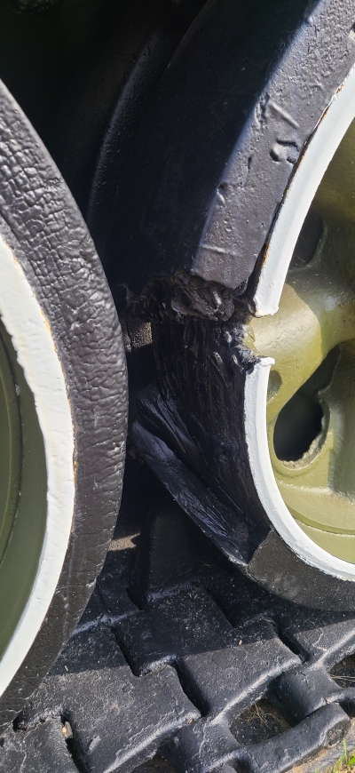

There is a visible hole in the front of the wheel and the rubber has been violently torn away. It is presumed that the damage was caused by shrapnel from a nearby detonation of a 105mm or 155mm high-explosive shell. or a direct shot of Recoilless rifle or M72 LAW, Idk.
