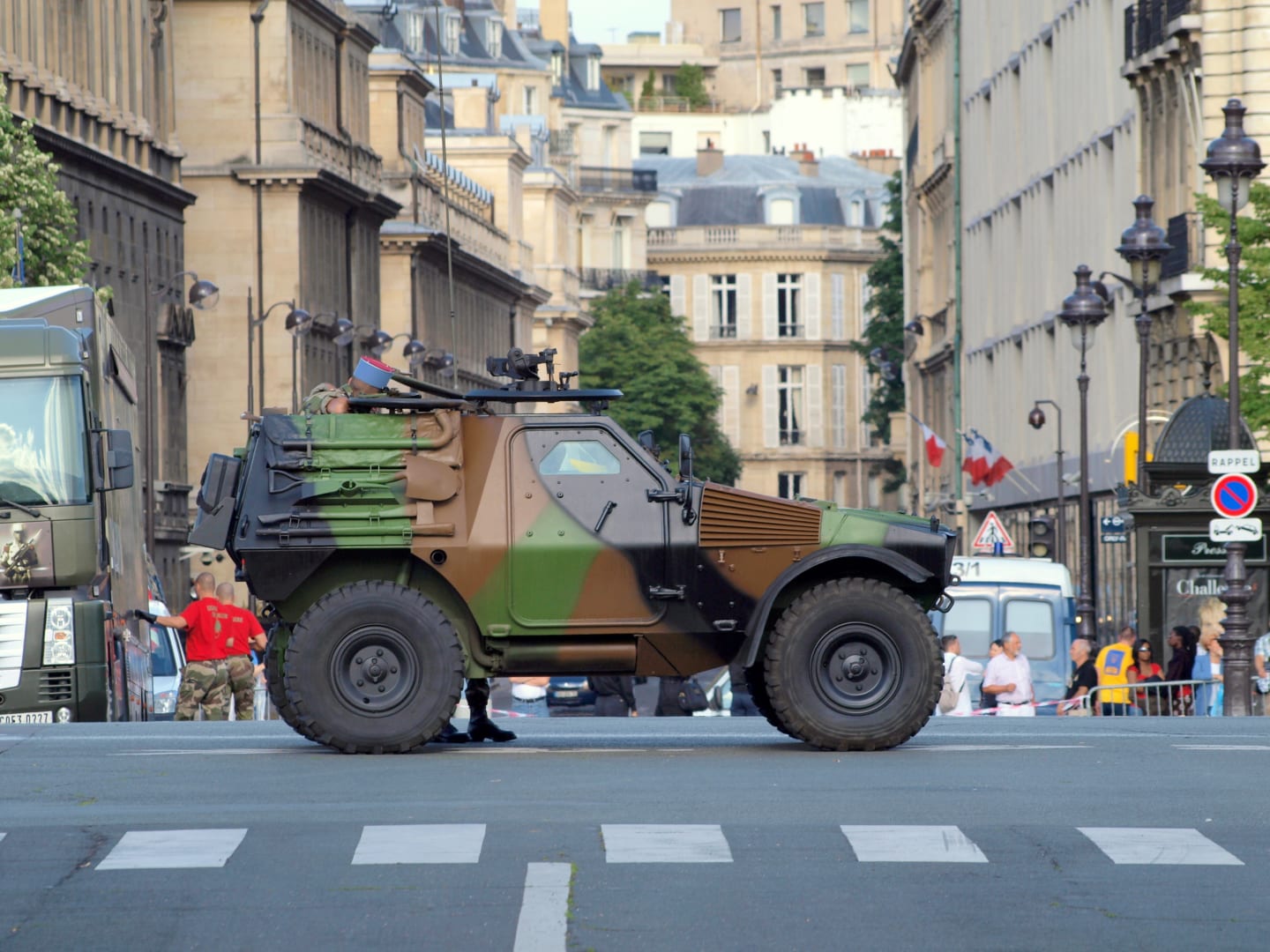

The first picture shows a short wheelbase VBL. The second one shows the long wheelbase VB2L.
2 more views :
VBL
VB2L
In this view, the one in the foreground is a VB2L, the oher is a VBL
Right, so I’m gathering that my postulation was right: all the straight backed VBLs ARE VB2Ls, then.
It makes sense, but then tank encyclopedia confused me. Just goes to show why you never rely on one source for your information…!

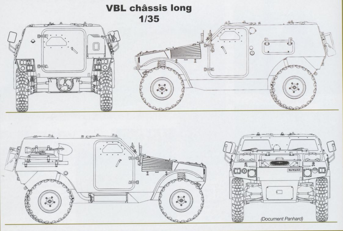

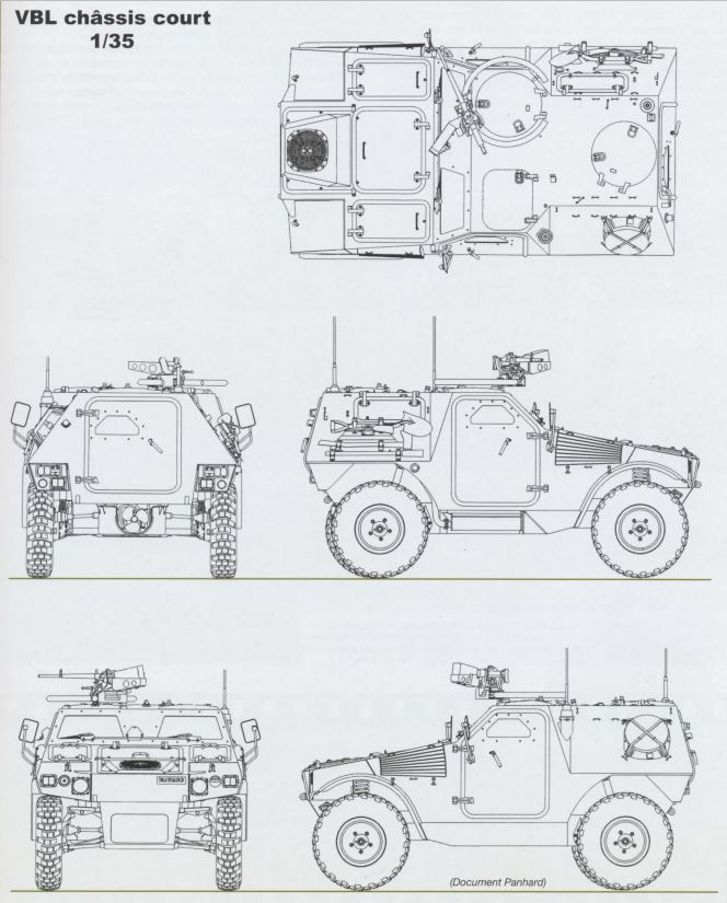

VBL
VB2L (a.k.a. VBL Chassis long)
Cheers, that last image will be very useful; I was planning to do a long-base anyway after I’d finished the short-base, and that will give me a more solid basis for the dimensions than just adding the extra 200mm by eye.

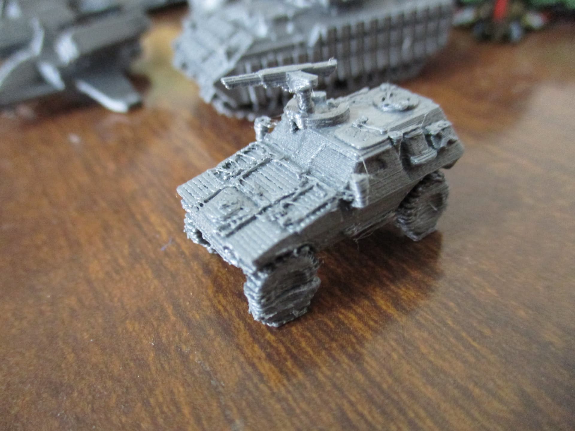

Sorry to disappoint, but I’m not a 35th scale kit modeller, I’m afriad; I make CAD models for 3D printing for wargames at 144th scale. (Moderns (i.e cold war onwards) is one part, but my true love is starships and scifi ground forces.)
I actually finished the VBL yesterday and did the first print on my FDM printer. (I have a couple of print houses, actually one of which does resin when this will be released.) So here’s very quick and dirty picture before breakfast - basically no clean-up or anything.
You willl, at least, be pleased to know that the guns are required to be rotatable (principally for the set of rules used, which is designed to simulate real-world tactics).
If you’re wondering, the little block on the bottom of the wheels are required for printing, since, basically, you can’t print wheels; I tried cutting off about 0.3-0.5mm off the bottom, but even that tended to fail (about 25% of the time), whereas the block at least ensure they stick.
