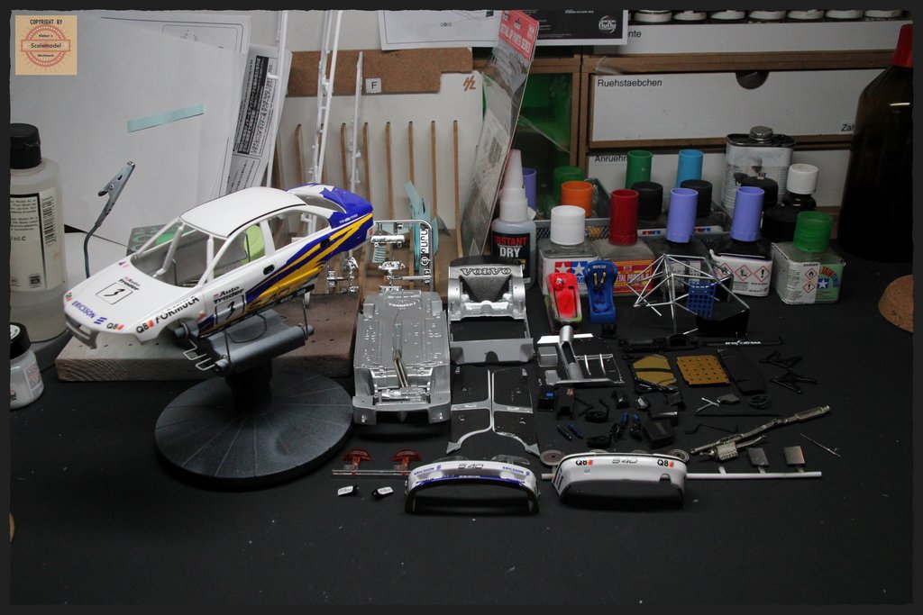

A good 95% of the parts have been cleaned and prepared for priming. Normally, the car kits have at least one casting sprue in black.
Here, all of the casting sprues are white, except for one in chrome and the one with the windows.
Therefore, almost all the parts had to be removed from the casting branch so that I could prime them properly.
The roll cage and some parts were glued together. This is easier beforehand.
The struts in the window cut-outs of the body remain in place until assembly.

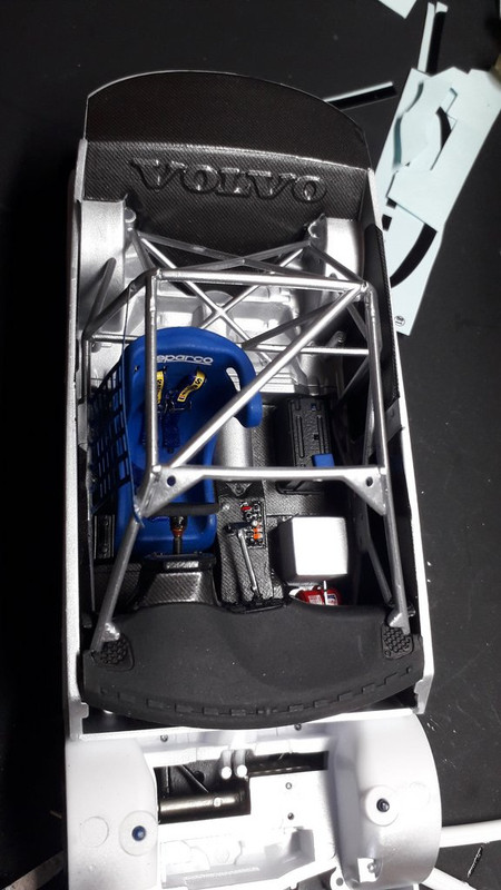

After priming, the left side is painted in white, the middle in silver and the right side in black, semi, gloss or matt.
The seat and some areas of the dashboard
are first painted in textured paint and then given their final color.
The brake parts and the parts underneath are primed with Alclad and then get their metallic colors.
I will use ZeroPaints White Primer as a primer. Application with the airbrush, 0.4 nozzle and ~ 2.0 bar.
All parts have been painted with different colors.
Brilliant White and 2K clear coat from ZeroPaints were used for the white parts.
The silver is MB Petronas Silver, also from ZeroPaints. Clear coat was not necessary here, the silver is semi-gloss. That’s enough for the inside.
The seat and dashboard were painted with a textured paint from ZeroPaints. As I only had it in black, I later added a coat of blue from Tamiya.
A little Tamiya red for the towing eyes and the fire extinguisher and the black parts are painted with Tamiya Semigloss Black as a base. This will later be 80 % covered
covered with carbon decals. It is therefore only used as a primer.
Finally, some parts with Alclad, brake disks, gearbox and the exhaust.

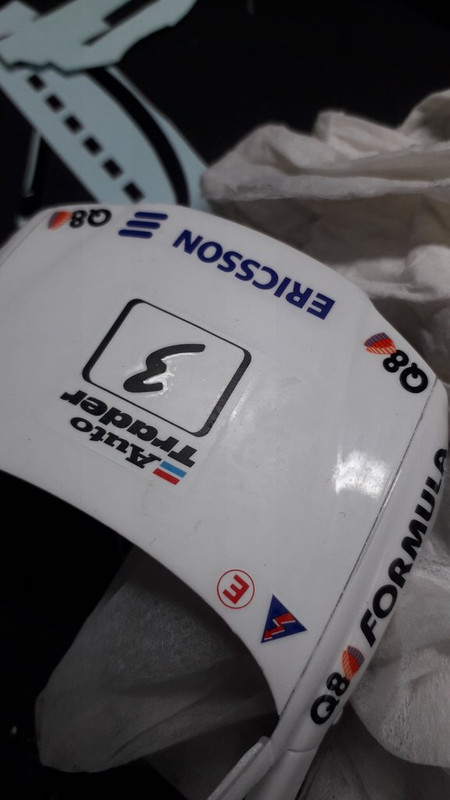

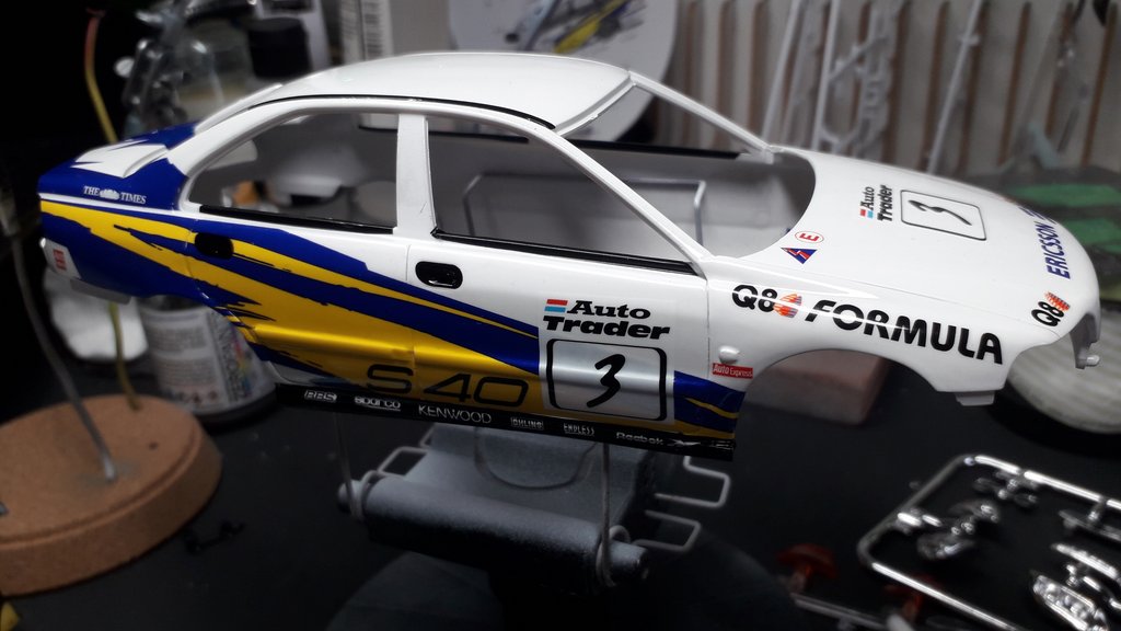

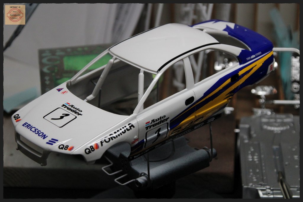

The body took longer than expected.
But it’s done, all the decals are on and the clearcoat worked too. Now let it dry for 2/3 days, sand and polish.
All other parts are painted, decals are applied and etched parts are also attached.
The seat and fire extinguisher are also finished.
Let’s put it together.

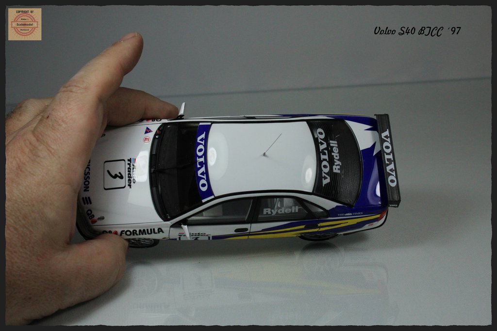

And I also sanded the body. 2000/3000/7000 sandpaper .
Then I started polishing the roof, first with coarse sanding paste, then with medium paste. It’s smooth now.
Already quite good. When the bodywork is completely polished, a final, fine polish is applied.
Then a ceramic sealant.
Now, the first model for 2024 is ready.
