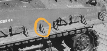

Here is an image of the M4A3E8 version which looks like a stamped piece of metal.

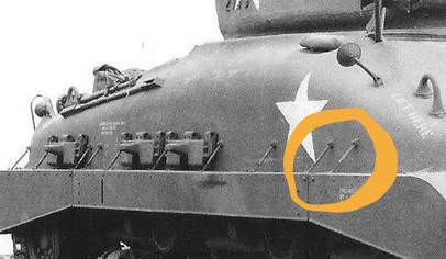

Here is the M4A1E8 version which had a threaded adjustable rod. My guess is so that these could be lengthened and shortened around the counters of the cast hull? that way all the supports would carry their proper load instead of them having to cast different ones for each section of the hull?
