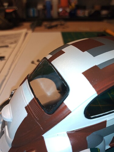

This is the only bit of the kit that has disappointed me up to now… Some parts of the chrome work, headlight surrounds for one.
They have done it so the sprue connects dead centre at the very top in plain sight.
Now, I have never used Chrome parts before so I don’t know if there’s a way car /auto builders cut off the Chrome parts, but to me there was no way to remove the part without damaging the chrome… It will be staying as it is sadly unless there is a way to get a bit of chrome effect back …I might of heard people mention a chrome pen ? Can’t remember…
Anyway, the chrome does look nice… And I need to do more silver layers on the from wing indicators.
Because there is no way, chrome is added on top of plastic so it cannot get under the sprue gate.
The pen that some use is molotow liquid chrome pen.
Cheers Ryan… That name rings a bell now. It is a shame about the chrome though…

When I try chrome, I like to strip all the chrome. Then add whatever material back to be chrome back as one. It can be chrome pen, paint or bare metal foil. I think some have even sent parts back out for rechroming but know idea who or where that would be at what cost.
Yes I use the Molotow Chrome pen for the cylinders in hydraulics, mirrors, etc. They come in different sizes. I have even seen a video where a guy breaks open the pen and uses the liquid chrome in his airbrush!
He is a bit heavy handed here, but you get the drift…
Yep, you can try cleaning up the nub where you cut off the sprue, then touch it up with the chrome pen, that should fix it.

Don’t keep rubbing the tip back on forth on where you have already painted it on the kit like some guys do That just lifts the slightly dried edges and ends up with lumps. If you have to, do it in a couple of layers, making sure it is dry in between.
