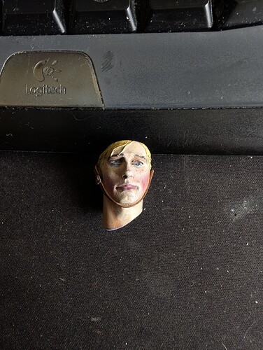

The face is done:

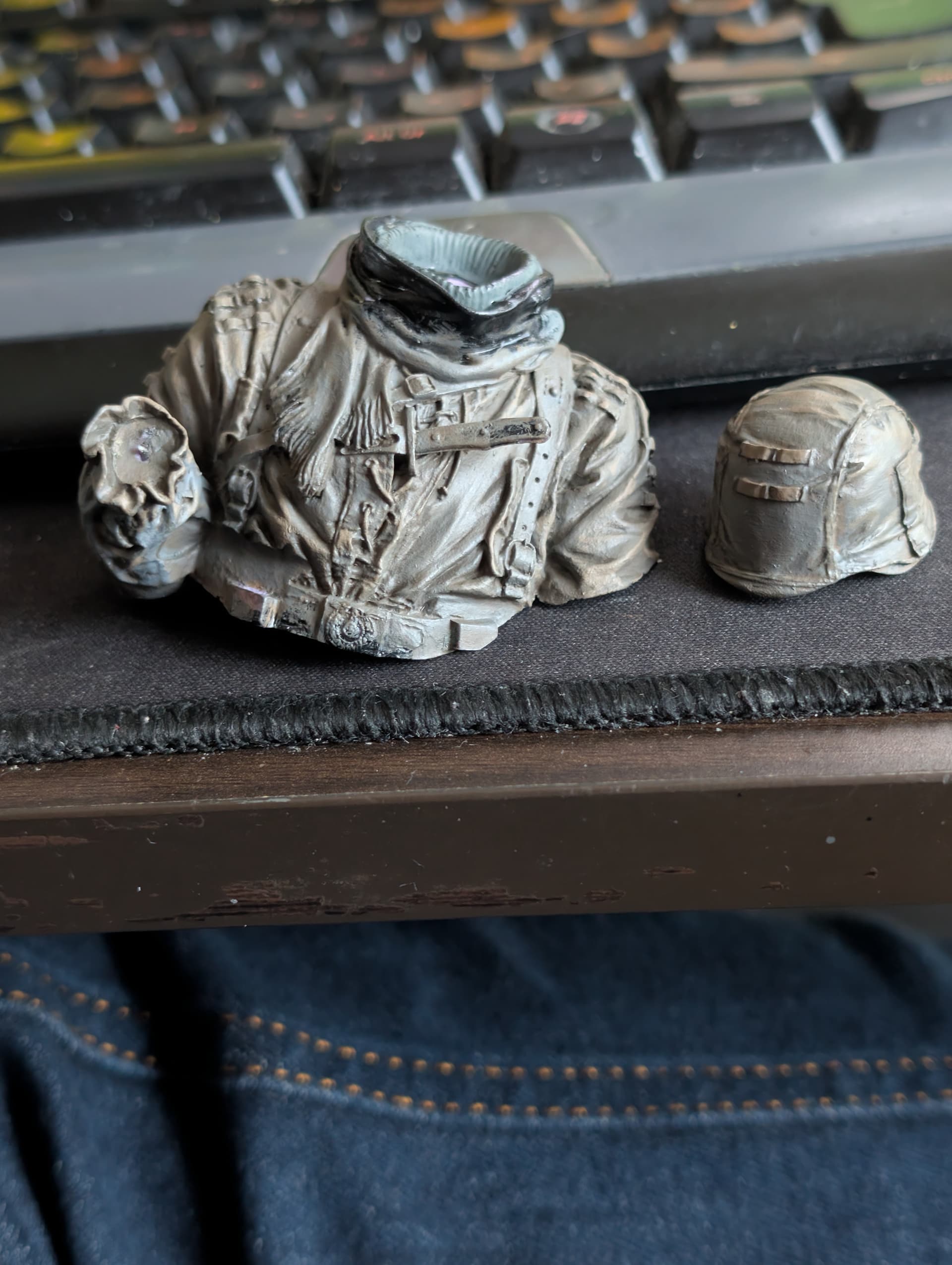

Now comes the hardest part: the camouflage uniform in pea pattern.
Base colour and high and low lights are on…

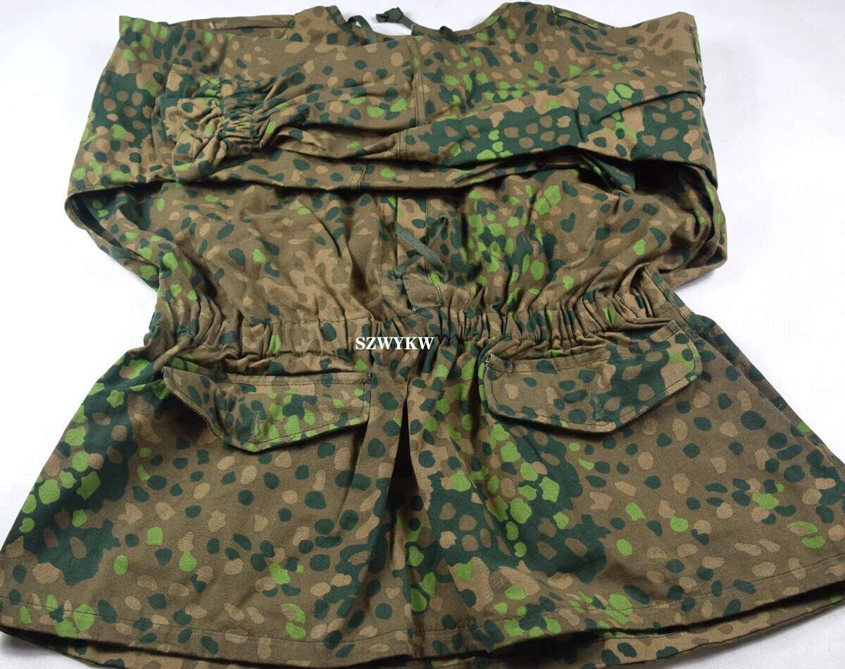

I don’t think it is possible to rush this in any way. I will have to painstakingly try and replicate the original pattern:
Before you get started, the figure appears to be wearing the late pattern camouflaged smock which would be in “Oak Leaf” or similar rather than “Pea”. I’d be interested to know the provenance of that colour picture of a smock in “Pea”. It looks a bit bright to me, suspect it’s a modern fake. In 50 years of studying the Waffen SS, I’ve never seen a photo of a genuine “Pea” smock. You have to understand they are not just different garments, they are different materials. The smock is cotton “duck”, the “Pea” clothing is drill, a completely different fabric which totally lacks the showerproof qualities of the smock. Smocks were screen printed, a laborious process. By contrast the “Pea” pattern clothing was machine printed, not an option on the smock material. The “Pea” smock pictured also lacks the white sections in the print where the patterns fail to overlap properly and the fabric shows through; this is very characteristic of genuine clothing.
Thanks for your extensive reply… If the smock is a different pattern, the colours will be different too! Darn! That means that the set I bought is basically useless… I will have to see what colours I need then…

It is from a Evilbay ad..
The seller does not claim it is an original smock, yet he does not say it is a replica either…

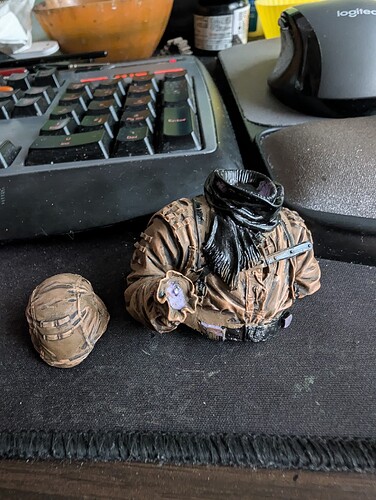

I think I managed to come up with a suitable mix (all colors from said set):
Base: a mix of Waffen Brown and Basalt Grey.
Shadow: Burnt Umber
High: base+some Light Earth.
The result:

Yes, that looks like a pretty good base for the Autumn camouflage. The colours are particularly difficult for this version, as they are all pretty non-descript. I always mix my own colours anyway and still use Humbrol, so can’t really provide any guidance. I did my creases with a sort of thinned down brown wash; if you follow Calvin Tan’s advice he suggests putting the darker tones of the camo in the creases, but to get a realistic finish, you can’t always do this. Here’s my Tamiya 1/16th infantryman, if that’s any help. My aim in painting this camo is more to get the “feel” of it than get too fixated on colour and pattern.
Excellent job on that camo and the figure overall, very nice!

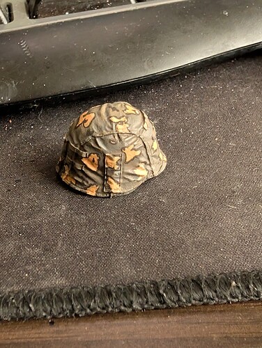

I tried to get some camouflage on the helmet as an appetiser. What do you think?
I think it’s good; every uniform is different through various conditions.

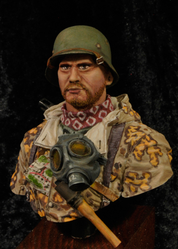

It’s been a while (5 years), but I used the Scale 75 (War Front) colors directly from the bottle.
I love your approach of capturing the feel of the camo pattern rather than replicating it exactly, as it makes painting camo far less intimidating to those of us modellers with more rudimentary painting abilities.
