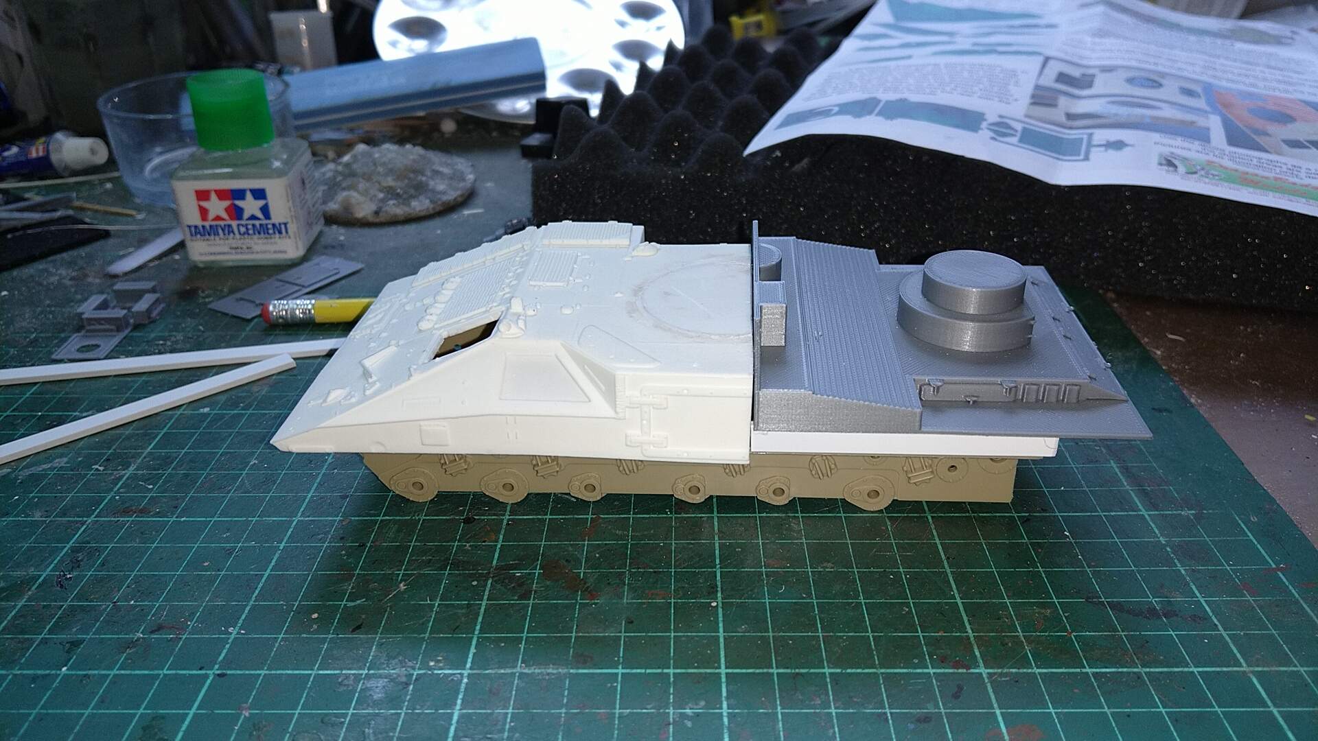

Academy warrior, with Scorpion miniature models warrior 2 top, which is an exclant kit (this is seconds piece not fit for sale) with dragon badger models conversion, ( do not buy, it’s bad 3d printing),
Is there any way you can smooth that out?
I was going to get the AVRE conversion but was warned off due to the quality of the printing!
There is a 2part clear resin to put over, will show a picture later when home again. Family members bought it a birthday thinking something different for me to do. Not knowing the issue.
Frank, please post about the 2-part resin, I have a similar issue to address…

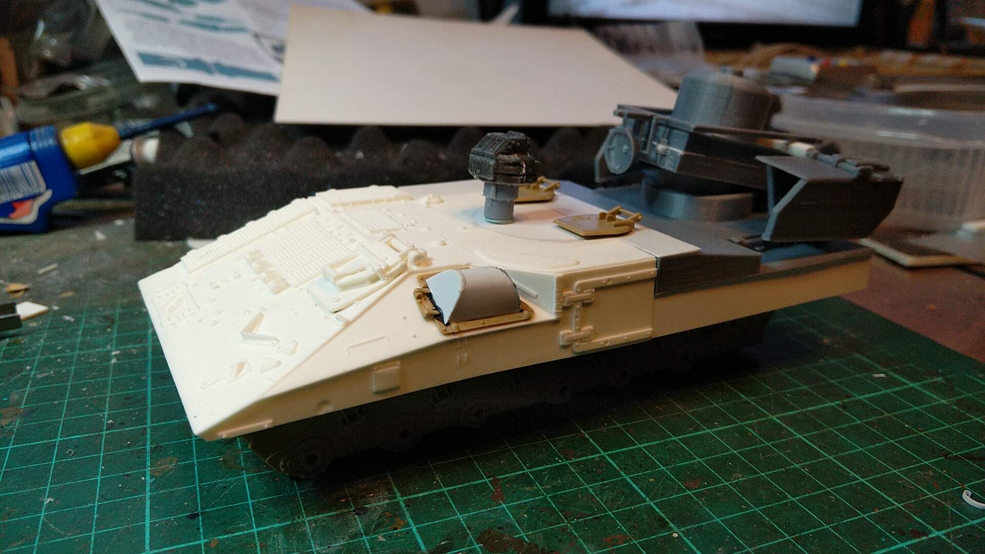

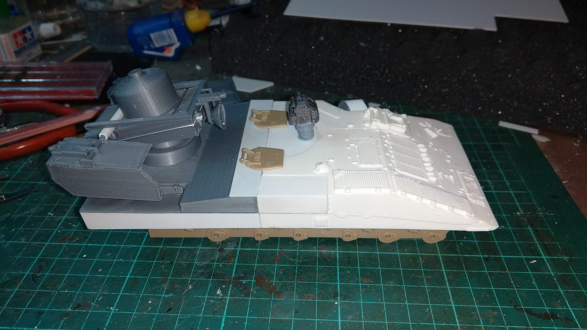

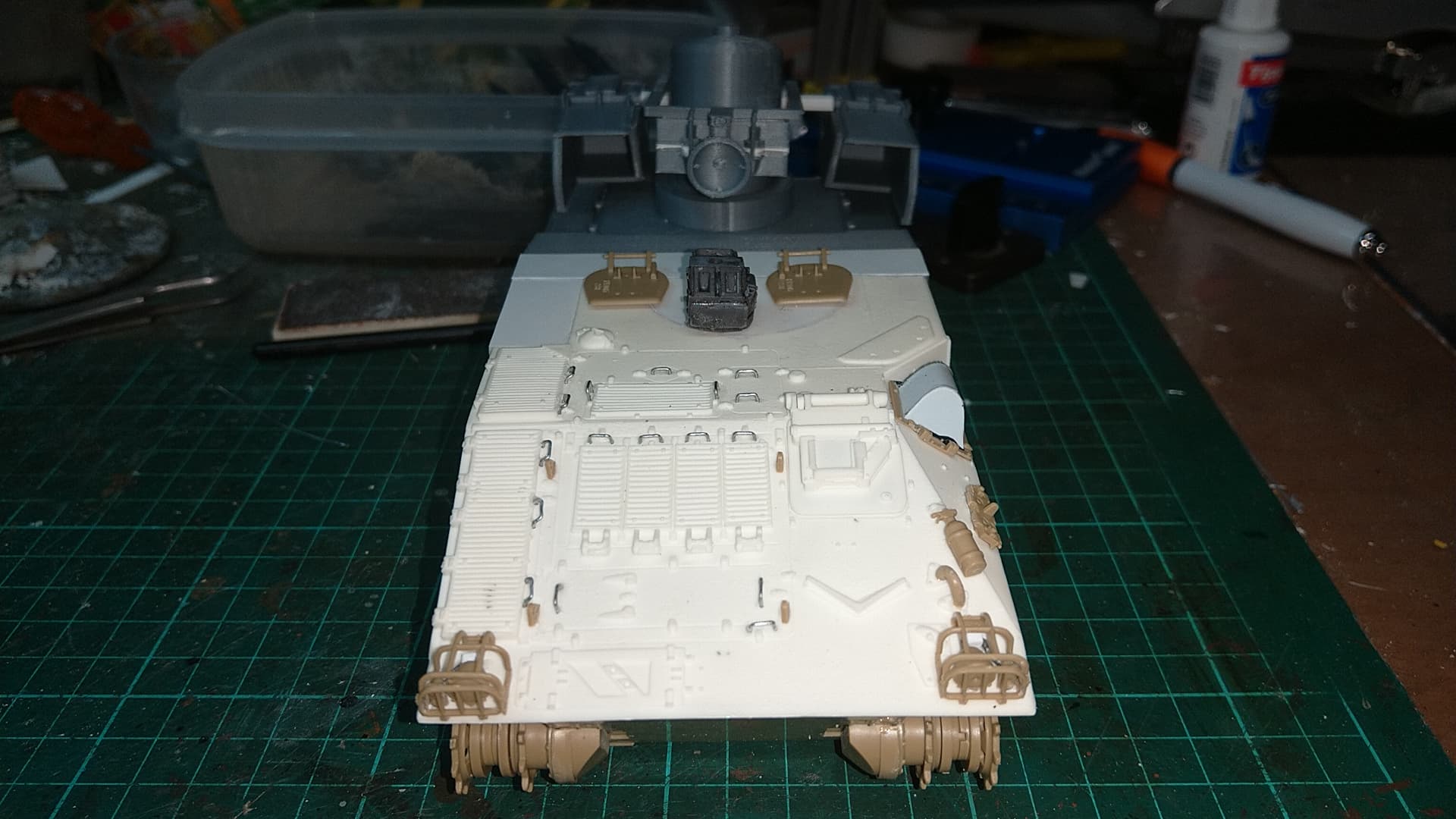

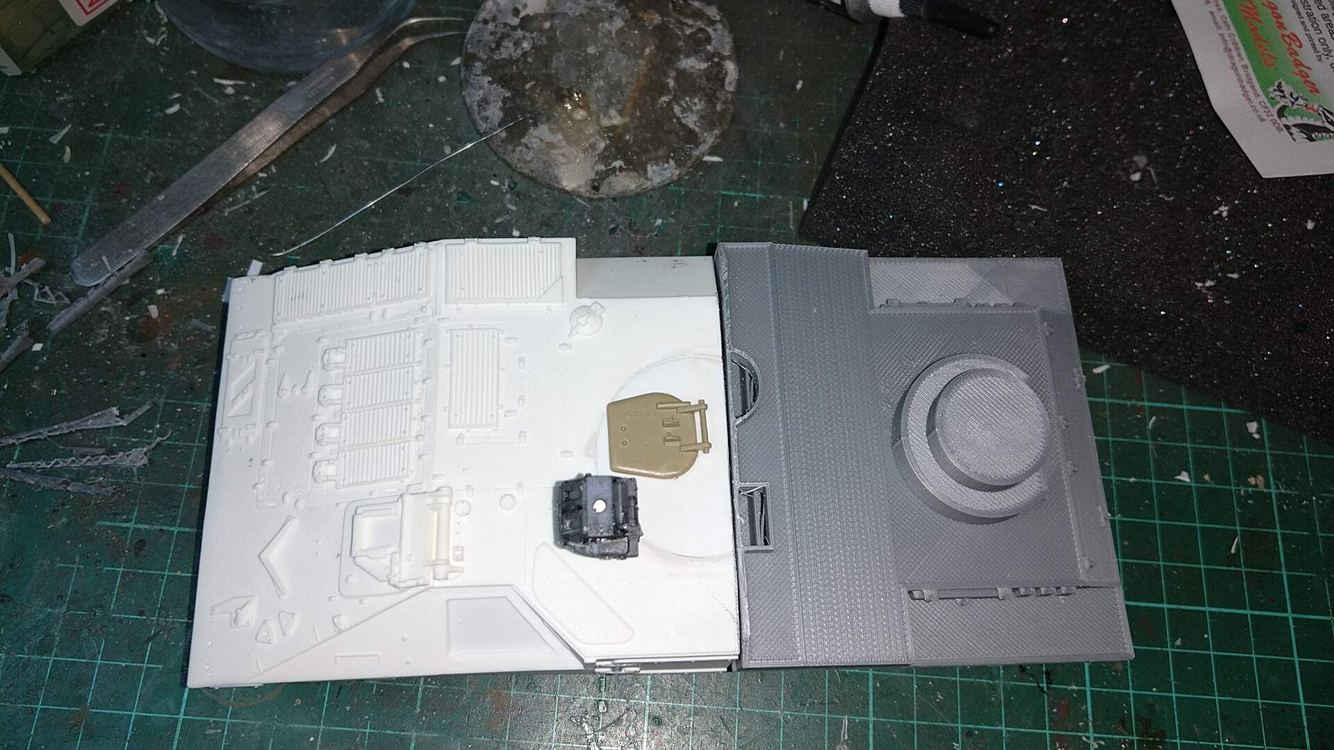

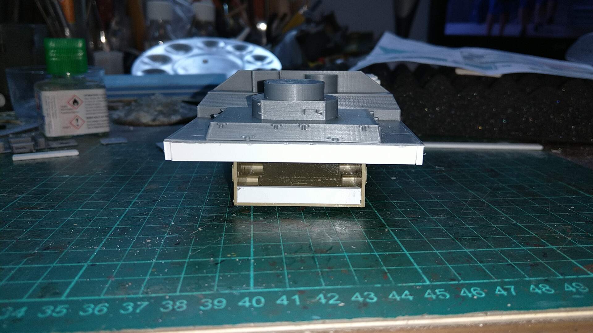

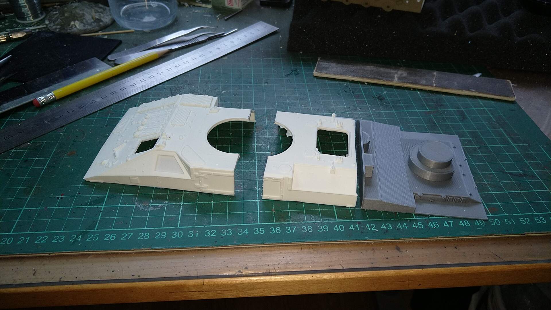

Update, other project has had to take priority, but able to do some today,
Still working out setup, reload storage
Hi Frank

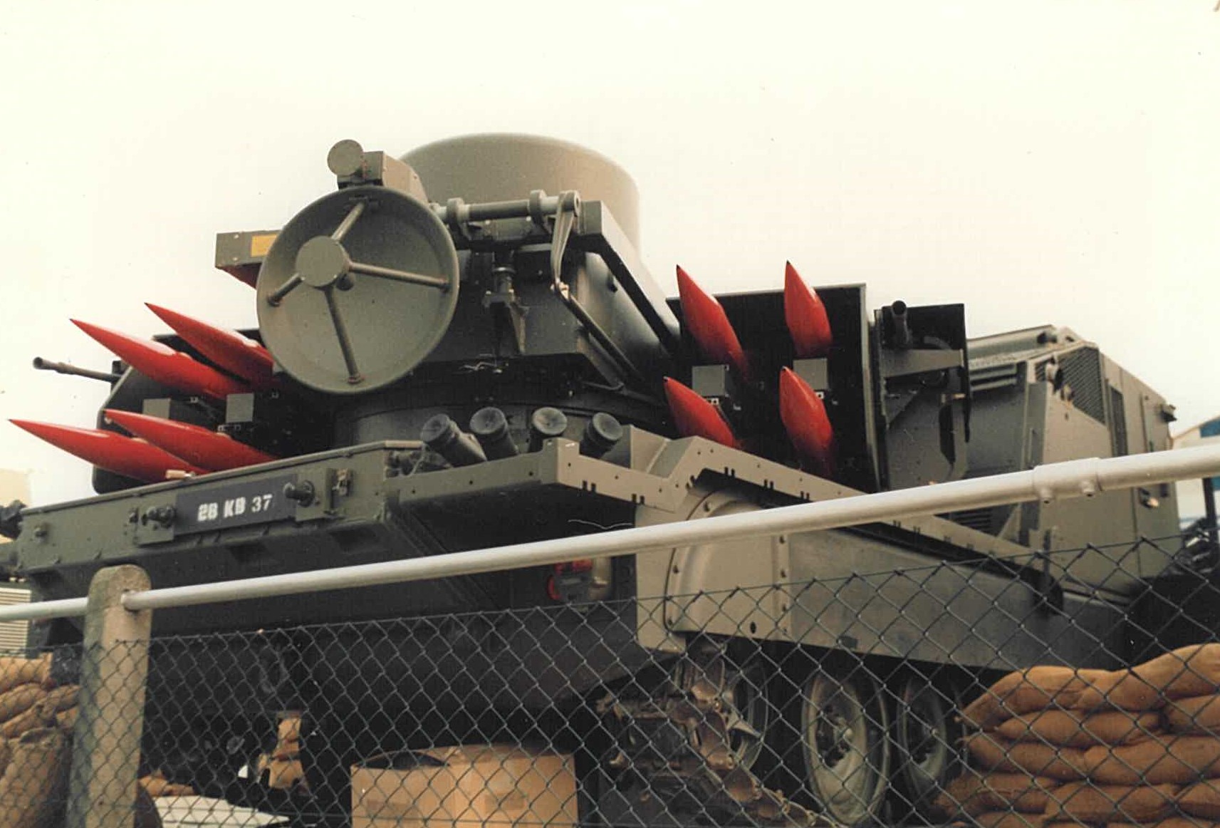

Nice work. Any thought about adding a 50 Cal outboard of the missile boxes? I saw that done on a Tacked Rapier at Farnborough in 86.
Mal
No Mal,
bad enough correcting this one, to some resemblance of a proper vehicle, have you seen his site and crap prints.
That would have caused a lot of problems aiming it,

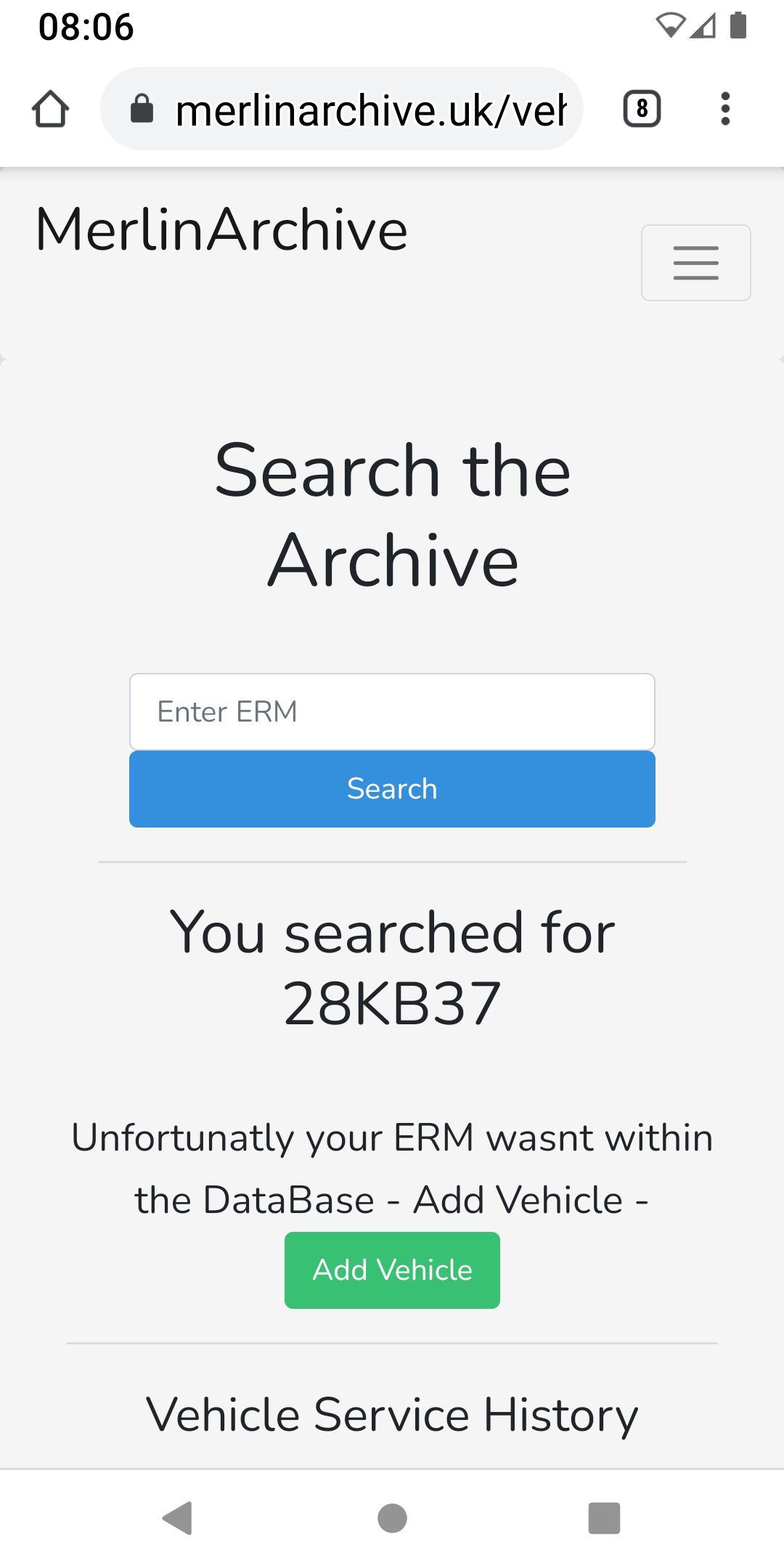

pity the registration plate has no match for history.
Hi Frank
Does that mean it was a dummy plate, or just not recorded?
Thought the installation looked rather crude, but interesting idea.
Mal
Dummy plate, yep. Just a sales idea or subdefuse for russians.

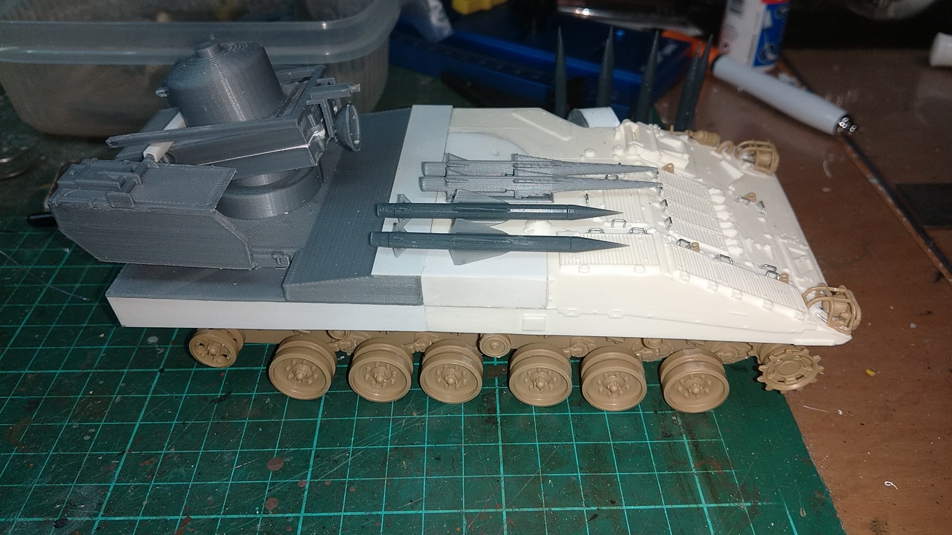

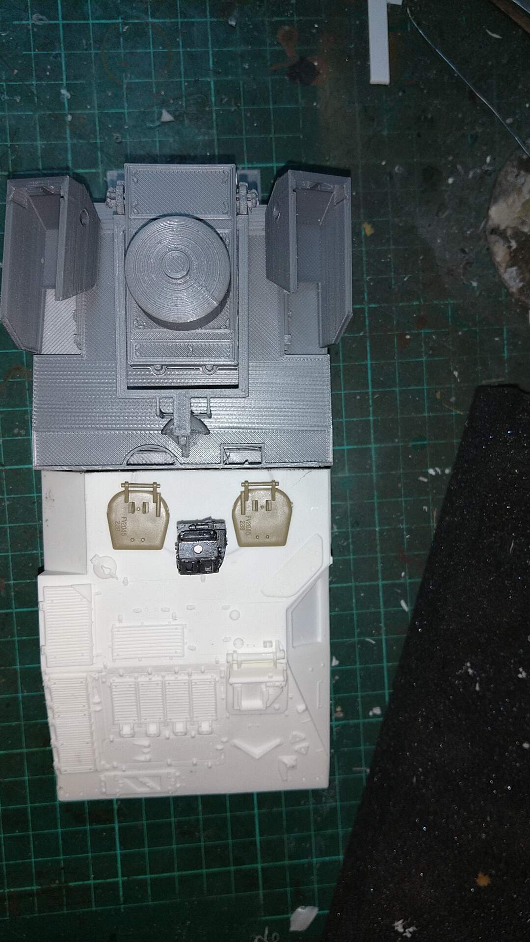

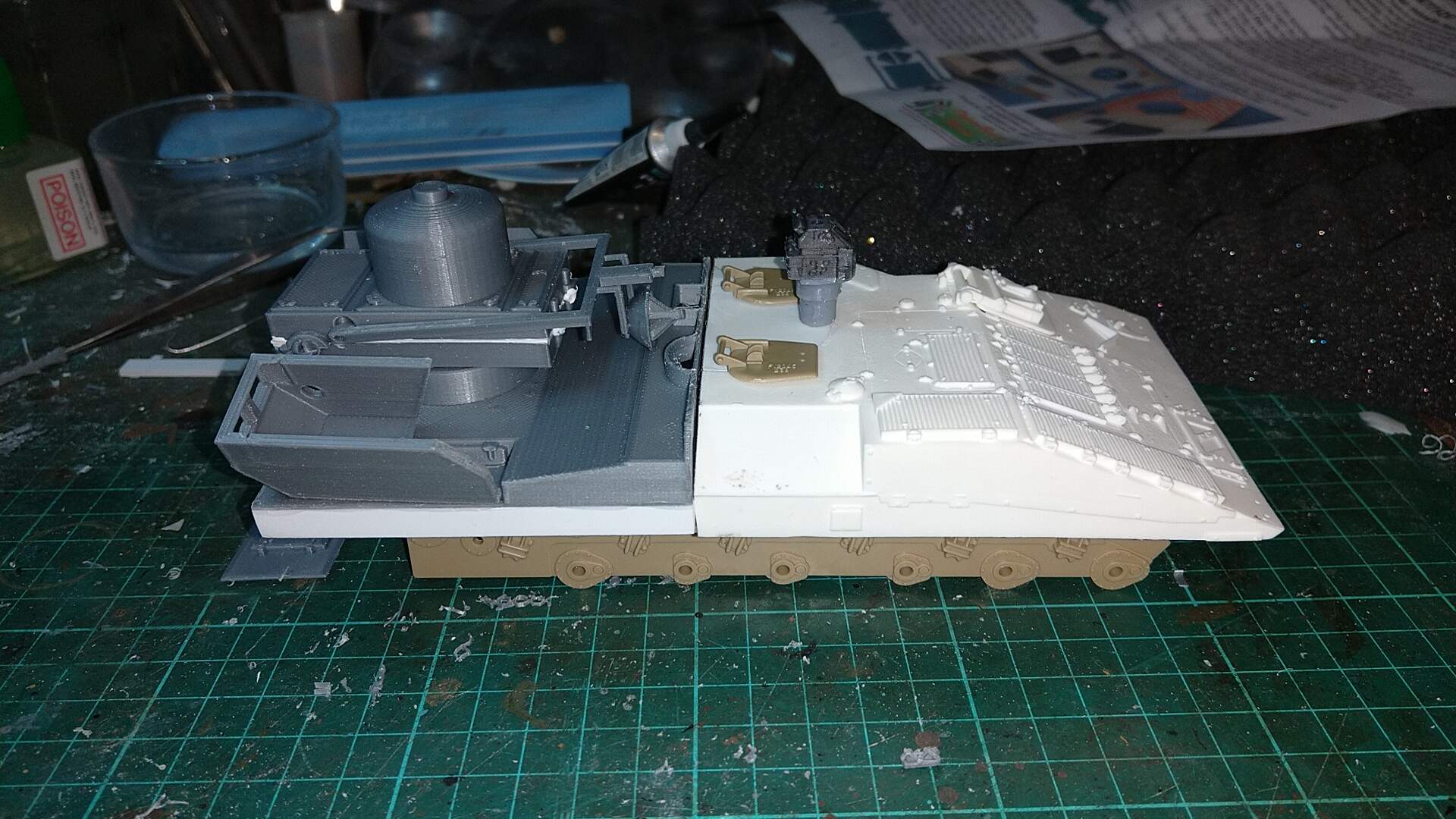

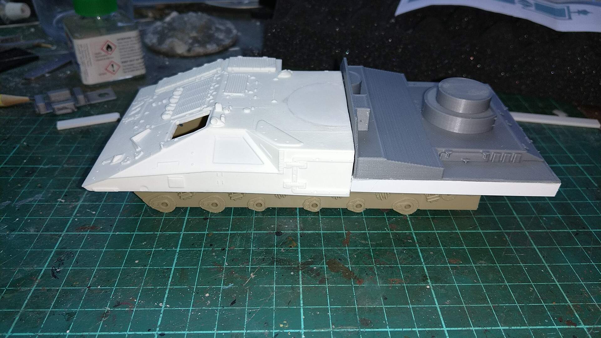

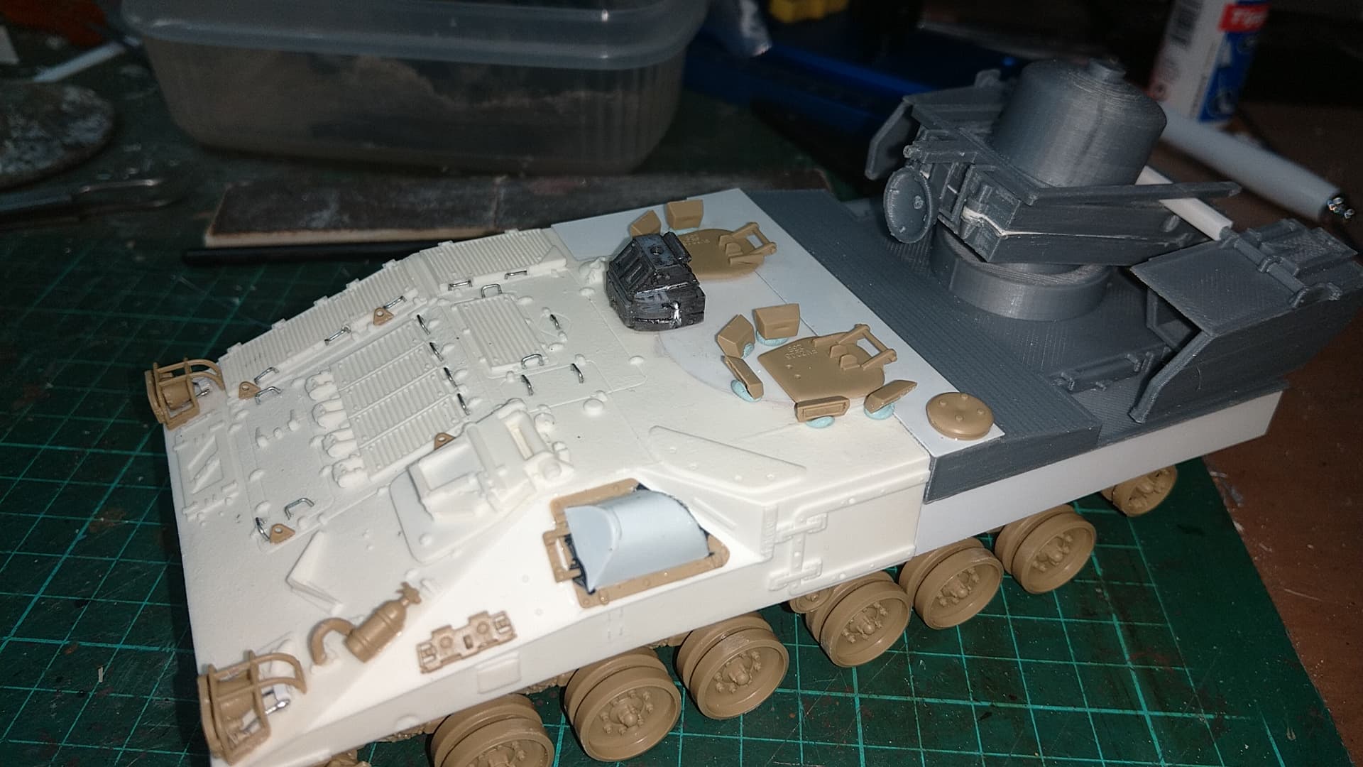

Not done any work in a while, update on warrior/ rapier,
still a lot of what ifs to sort with it.
forgot to add had a friend make some proper rapier missiles.
Coming together nicely.
Mal
