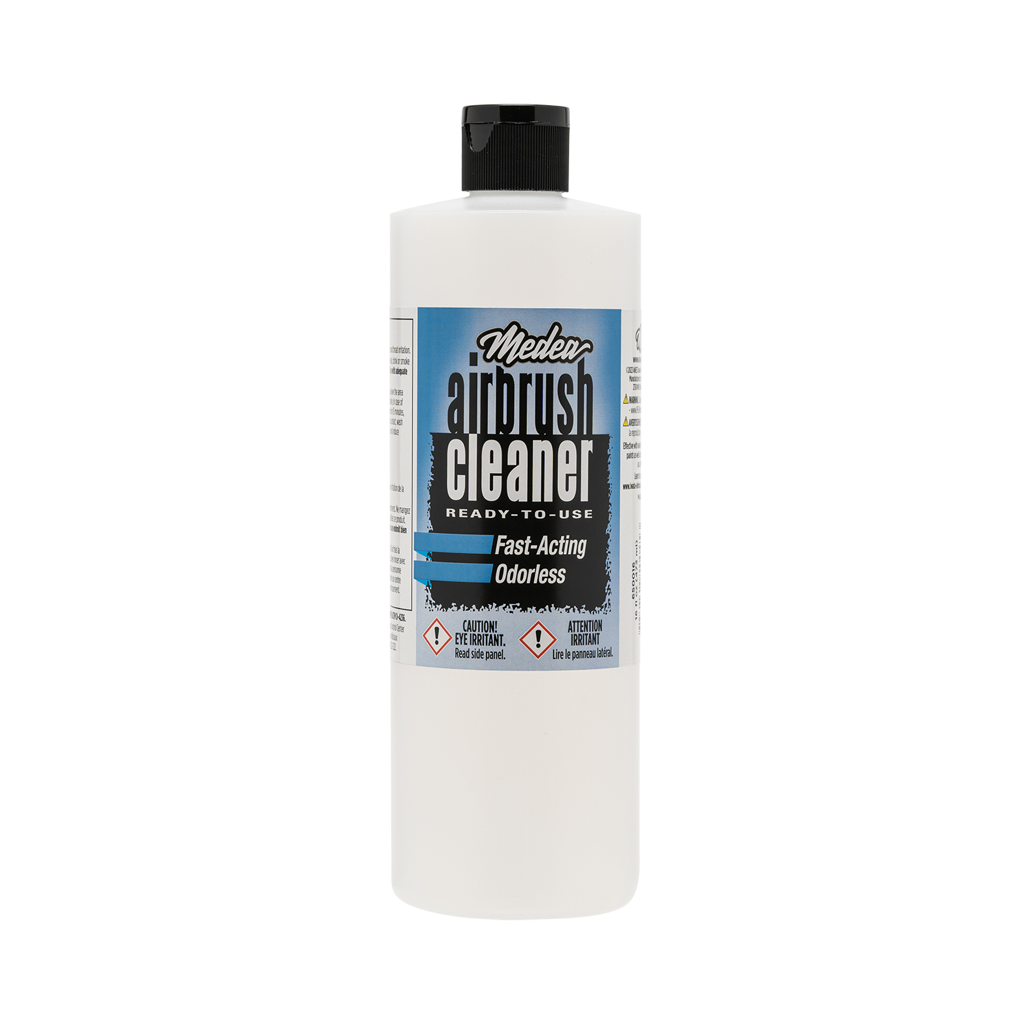

I am uging this with acrylics and it seems to do well and has little to no odor.
Yeah I think Medea is pretty good- works for most acrylics. Vallejo’s cleaner is decent too. I really love Premi Air’s ‘Foaming Airbrush Cleaner’ though- it always gets into those hard to reach places with ease and lasts quite some time too.

I’ve been using ‘Medea Airbrush Cleaner‘ for several years now. I also use Isopropyl Alcohol for deeper cleaning. :sweat_drops:
