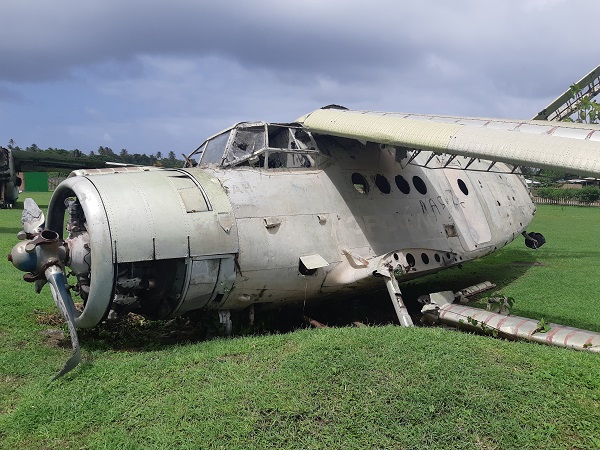

One in Aeroflot colors was captured in Grenada by the USMC at Pearls Airport
and left there….
