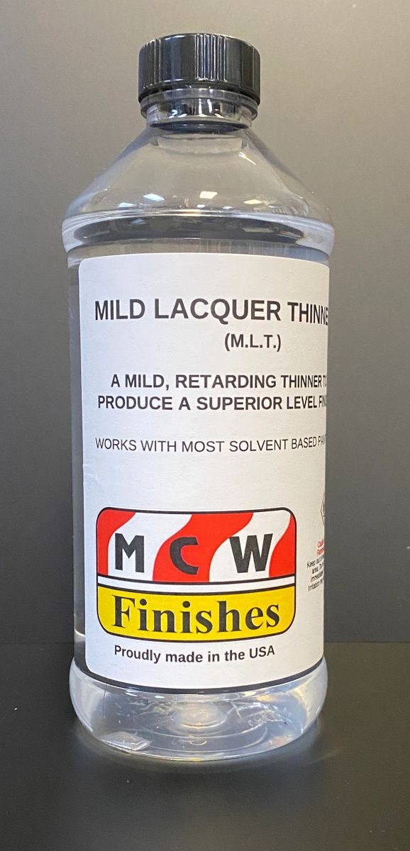

Haven’t use it myself but seen at Nationals that there is new Mr Leveling thinner replacement by MCW that looked to work with Vallejo paint.
Awesome that we can call them both “MLT”!
Yeah, probably best to call it MCW MLT to avoid the confusion that will happen in the future.
Maybe a perfect product… increasing the already huge variety of painting and finishing products on the market. I wish them succes…
but will probably never try it because trying yet another thinner while I am perfectly happy with what I have can possibly lead to disapointments without added value for the quality of the kits I make.
No matter how tempting it is… :slight_smile: :slight_smile: :slight_smile:
On this side of the pond, sometimes Mr Leveling thinner can be hard to come by or it has been in the past. Adding in other issues and having a domestic product is good for folks over here.
