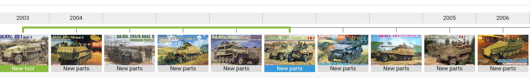

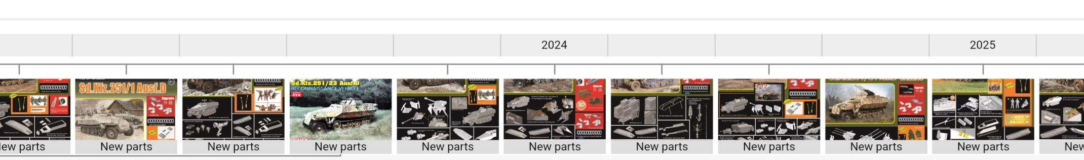

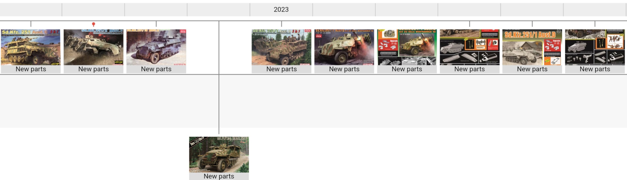

Rex, first my opinion of Dragon in general then to the 250 & 251 to set the context of I how see the manufacturer in general…
…Dragon got way better over the years but the roots of their 251 go back to ~2003…
My only build in that fantastic list of 251’s is the 2023 pop of the 251/23. My other 251 builds were these kits, the year they released and a terrible 1970’s Tamiya 251/C :nauseated_face:

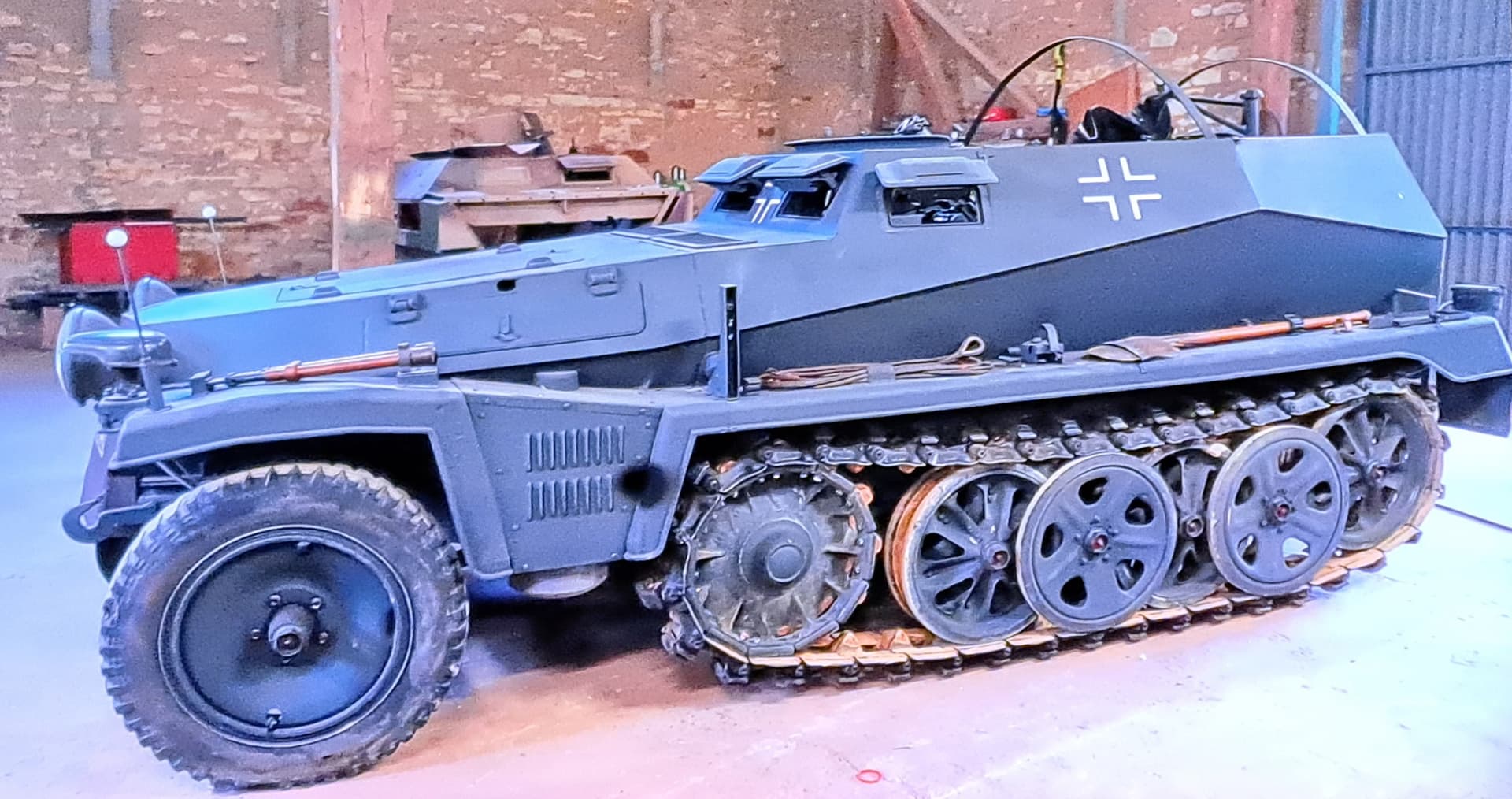

I picked up that 250/3 after seeing a video on YouTube of the only known surviving and running German AFV that fought at Stalingrad.

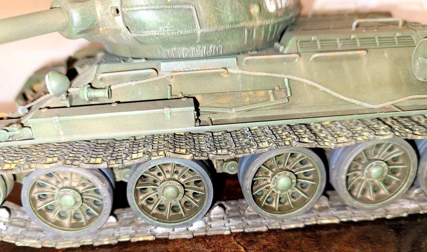

My trio of Dragon T-34-85’s were all terrible.
That’s unacceptable mold quality to me.

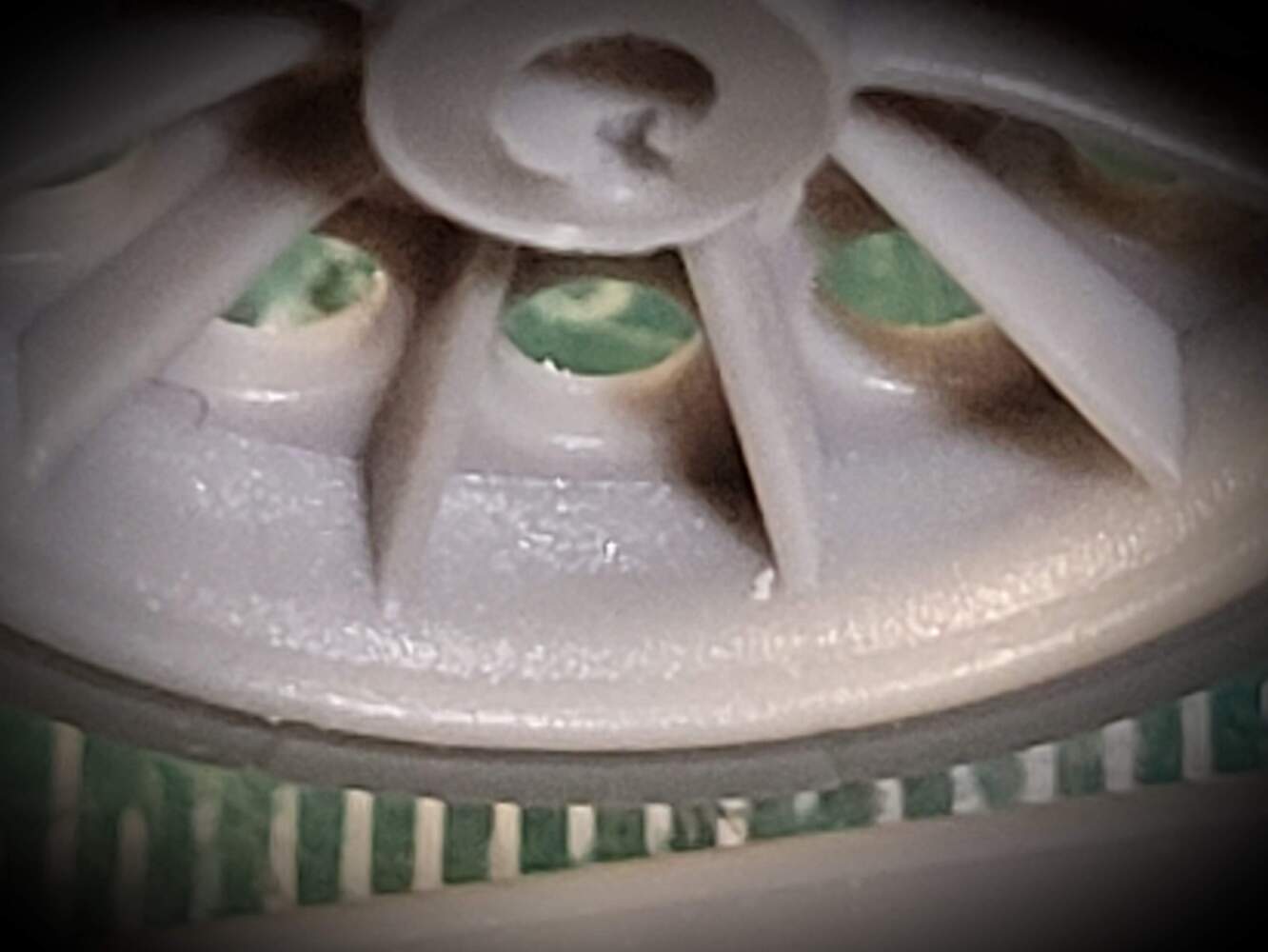

The first one I bought in 1997, the wheels were riddled with sink marks. I bought another thinking it was a fluke. It wasn’t. The third one had the same problem and so did the kits several of my friends purchased. It was a serial issue.
Remember, I made no claim or comments on accuracy or details, or fiddle bits so many get torqued about.
I addressed quality. If I want to, I can usually fix detail issues. Those wheels were just too much work to fix with Milliput, Molak Stucco or Super glue. Tried with all of them.
Covering that sort of sink hole mess in mud is just a cop out to me. I paid Dragon for a quality kit to build how I like. YMMV
Knowing which factory used which exhaust cover or whatever is pretty irrelevant to that sort of commentary.
The 1997 era mold quality is nice for what it is but it isn’t up today’s, again being up on all the fiddle bits isn’t critical to that observation.
That’s backed up with the wheel photos as shown above.
Every wheel between every set of spokes had the sink marks. 10 wheels × slots = ~120 sink marks.
I’ve seen one Premium Dragon T-34-85 kit without the wheel issue.
Definitely buyer beware product in my book based on my experience. I don’t recommend kits like this or sugar coat their faults and suggest other modelers buy them when I found the kit to be a disappointment due to quality issues.
