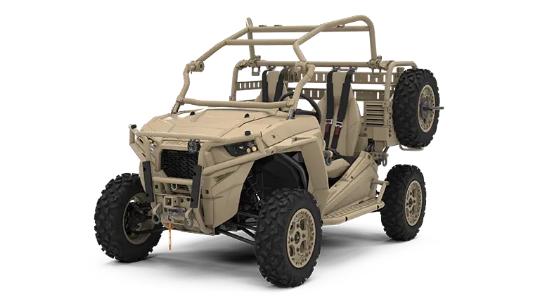

This is the color I want to match.

Interesting. We have some things at my job painted in the sand color (I don’t know if I can say what they are).
At least some have the very slightest pink tone. You have to look very intently, but it’s shifted ever so slightly to pink. So if I were going to model something that used this color, I would add a small drop of red.
