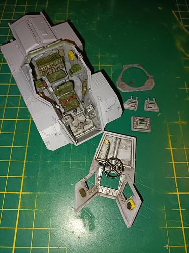

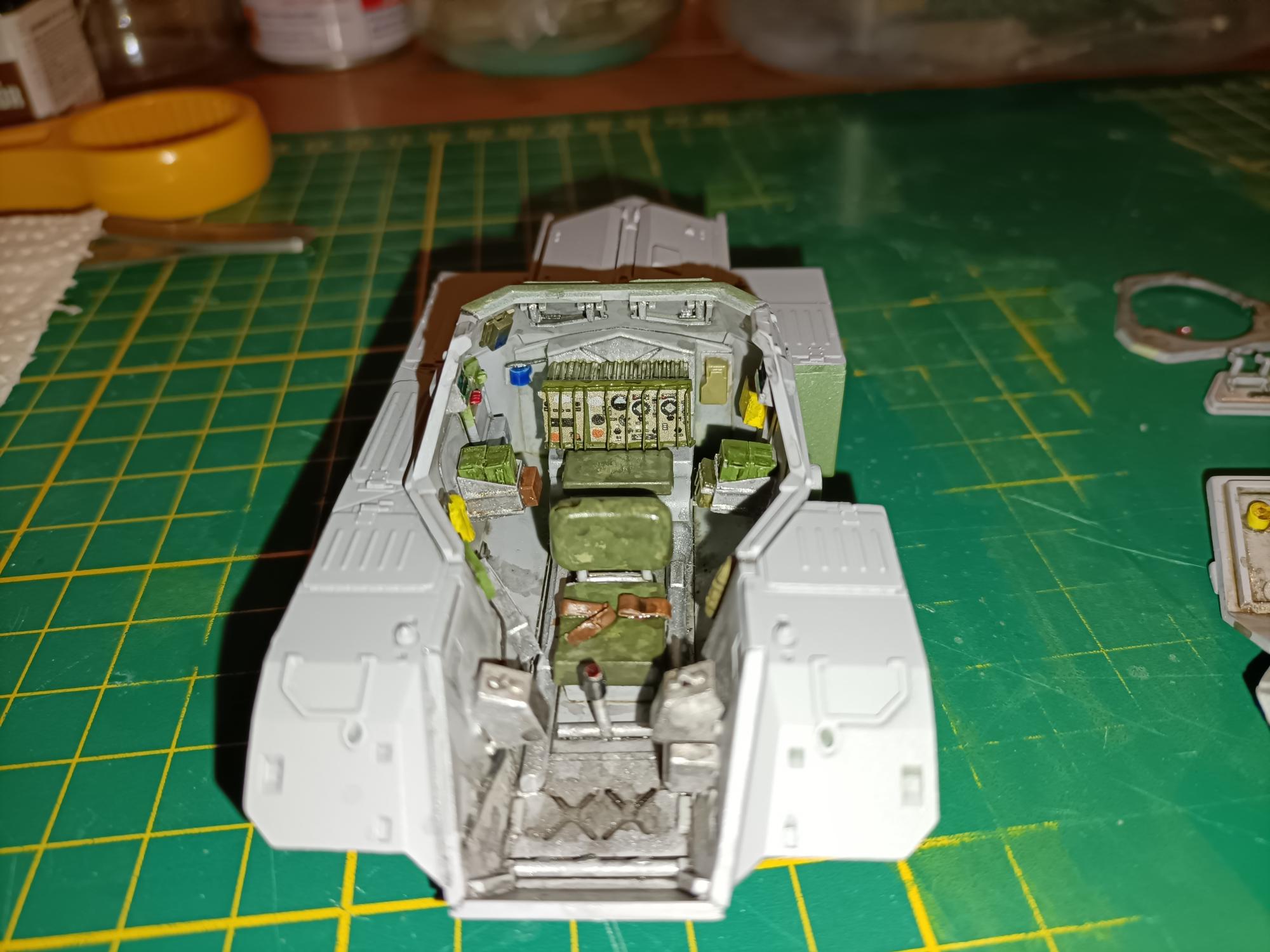

Interior finished, hull closed…
Looking good with how its going.
Thanks; it’s a nice little kit.
Very nice job on that interior! Is the interior white or silver?
the real is silver and gray (from the pictures I found), I sprayed with Tamiya gray primer then brushed in silver some of the items.
Ok thanks that’s what I thought. I remember the British using silver on some (all?) of their interiors except of course the M4s they received. I’m not sure.
I believe the early Centurions were painted silver inside as well, but not sure if that changed later on . I did an Israeli Nagamashon with interior but I painted it white based on reference photos.
Insides are silver back then. Was a total nightmare as it would rub off onto everything. Modern kit now is like a semi gloss white on most things
Thanks for the info.
At 1/35, what ever the vehicle once the hull is closed not much will be visible in the end…

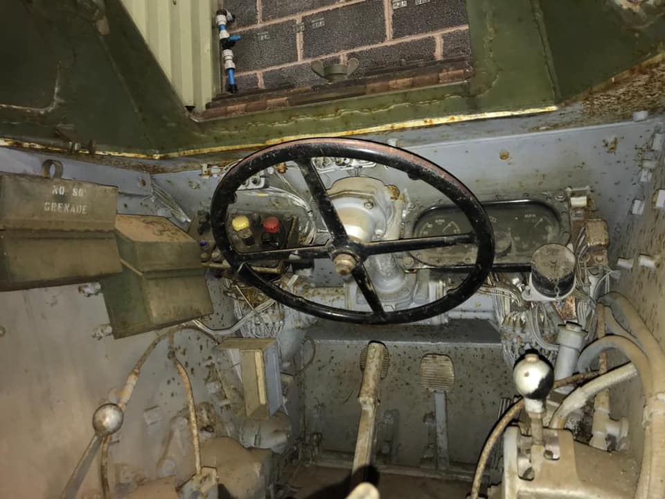

Airfix have mounted the steering wheel much too high. Fom the outside, front on through the driver’s hatch, the top of the wheel cannot be seen.
Just one of a whole list of inaccuracies in this kit.
17151258_05
Great photos, thank for the share!
I had noticed that there were indeed plenty of inaccuracies but since I’m not a rivet counter, mine will stay in it’s current definition.

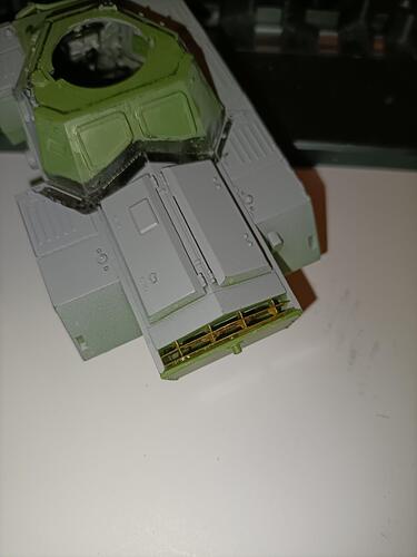

Work still in progress on detailling the exterior.

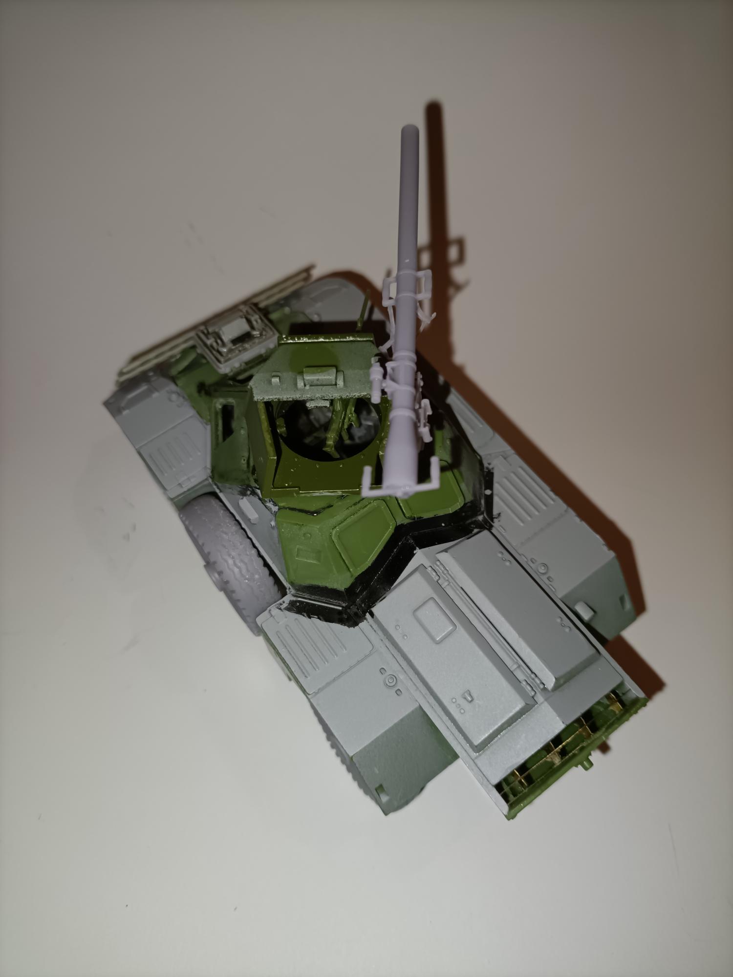

Dry fit test with wheels and and RR Gun (that is yet to be straitened).
That looks really good with the RR fitted. I can imagine what that sounds like having fired Charlie G’s in the past.
