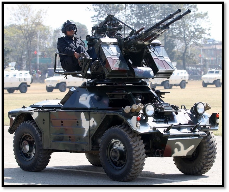

I have a second kit that will be way more exotic…
Nepalese army with ZPU-2 on top.

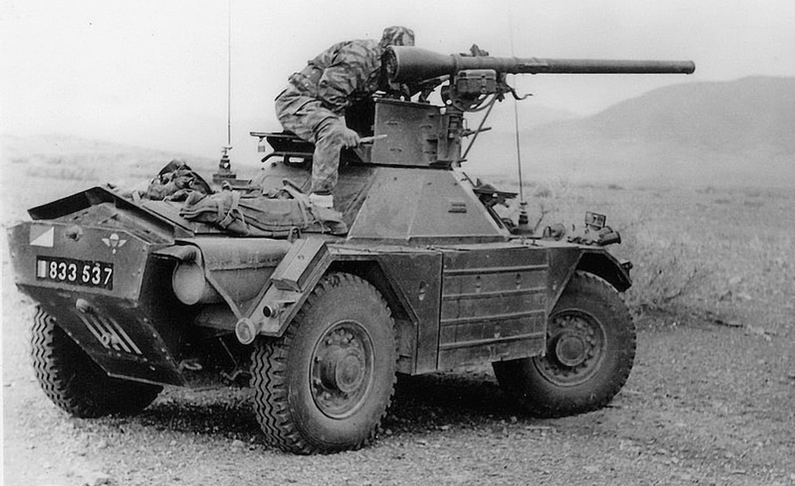

That French version with the RR in Algeria is very interesting. Didn’t know France used the Ferret at all.

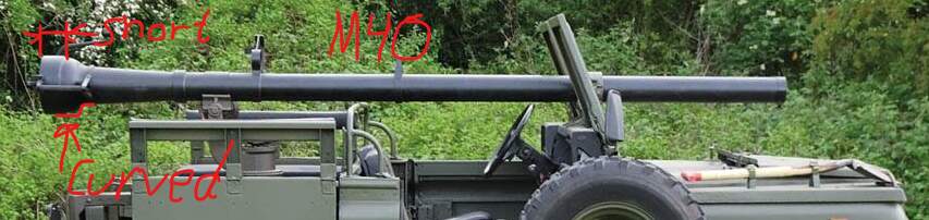

That’s not an M40 but an M20 75 mm RCL:
Thanks for the clarification- they look similar from a distance I guess. I noticed a parachute marking on the rear of that Ferret. Anyone know what unit this vehicle belonged too?

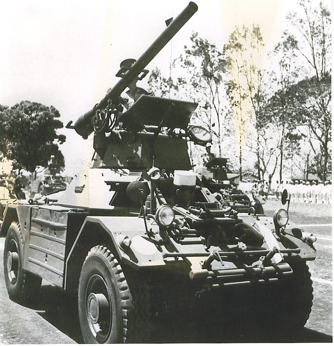

Not sure, but here’s a colour picture of two more:
(source)
Oh, wait, several others here as well, including:—
White kepi for the driver, so Foreign Legion, I assume for at least this one. Maybe the others with parachute emblems are from that too?

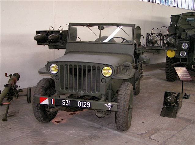

The Entac equipped jeep at Saumur has what appears to be identical markings:
So, possibly a standard French Airborne marking; someone on here will know I’m sure; Olivier?
Not sure - colocated with French troops twice in my career and never bothered to trade with them.
However, there’s only one French Foreign Parachute Regiment, and none of their devices look like like the two (slightly different ones) in the photos.
There were a few different French parachute infantry units in Algeria. It’s a little confusing, but they were divided between Metropolitan regiments, Colonial regiments , and Foreign Legion regiments. They wore different berets and insignia but were essentially identical apart from internal organization. This is from the Osprey book on the Algerian War, 1954-62 by the way. There was also commando units from the navy and air force.
Perhaps some were fitted with M20 and some with M40.

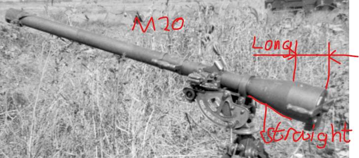

I’m using a kit from FC Model for the gun and the wheels.
img_3779_1bc8e972d597a53484750e39cb043719_20
Is that a M20 or a M40?
M40
M20
Thank you
The caption in the image is wrong: what’s in that set is also an M20 :slight_smile: Though it looks at first sight like it’s not greatly accurate — it certainly gives me the impression that the two handholds are too far forward, for example.

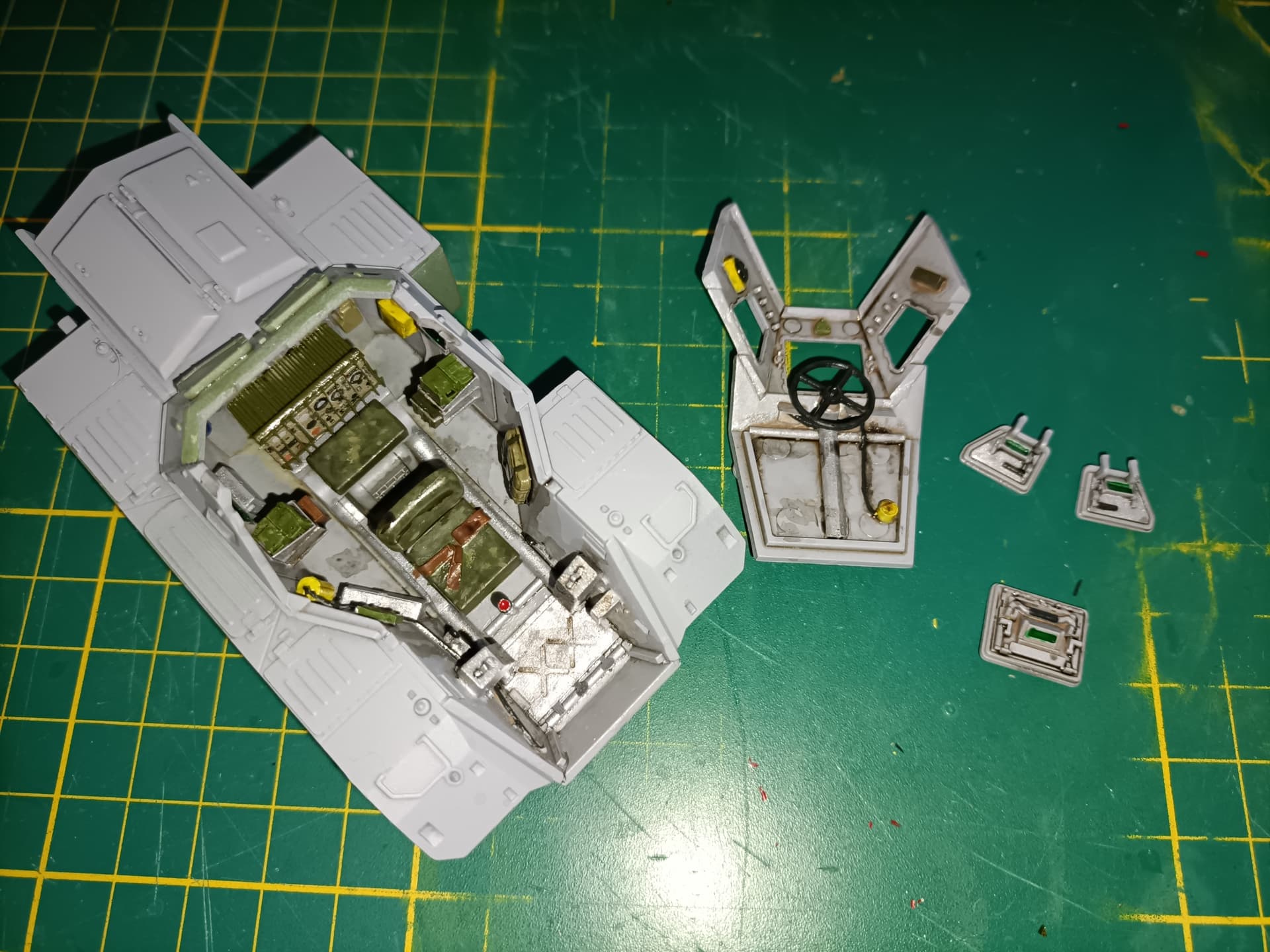

Buid on going, interior almost finsihed…
