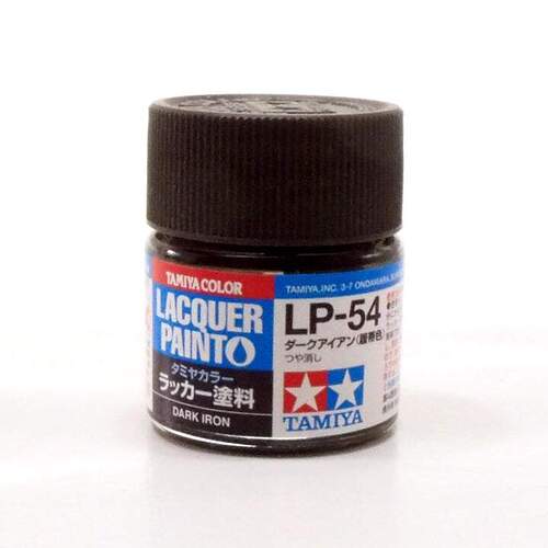

Is this lacquer?
I don’t know about the primer and the Tamiya paint I mentioned it’s acrylic, but they have a lacquer enamel as well (LP-54).
as for the wash, the AK Interactive washes are enamel based.
Thanks,
I just looked up the black version on ebay and I see they carry other colors which I think are lacquer, so I’m guessing this is so.
