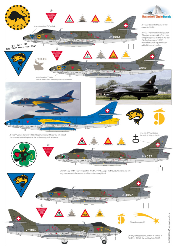

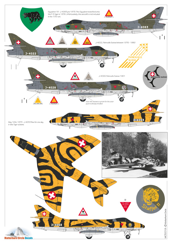

The Swiss hunters featured in a The Aviation Historian article recently, well in the last 6 months. They looked to be all over Swiss olive green.
Bottom of this page might help find the TAH article.
Hi Peter,
thanks for this. I don´t know when I will finish this, but its good to know that there are decals out there. ![]()
