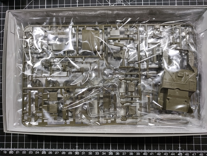

The kit is pretty good out of the box with nothing really needing to be “fixed”. You can always add details though. It is missing straps and retaining clips on the tools, the engine can be plumbed and wired, there are no brake and clutch pedals, etc., etc., etc…
No clips for the hood and windscreen.

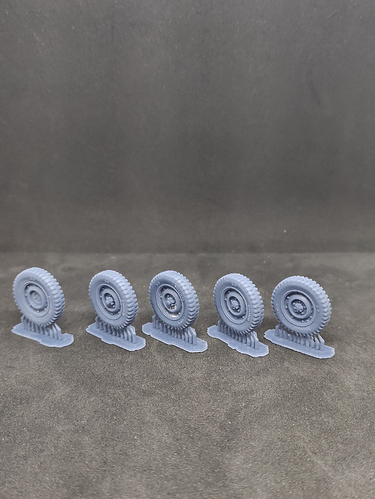

The first addition are the wheels from Cults which I printed:
