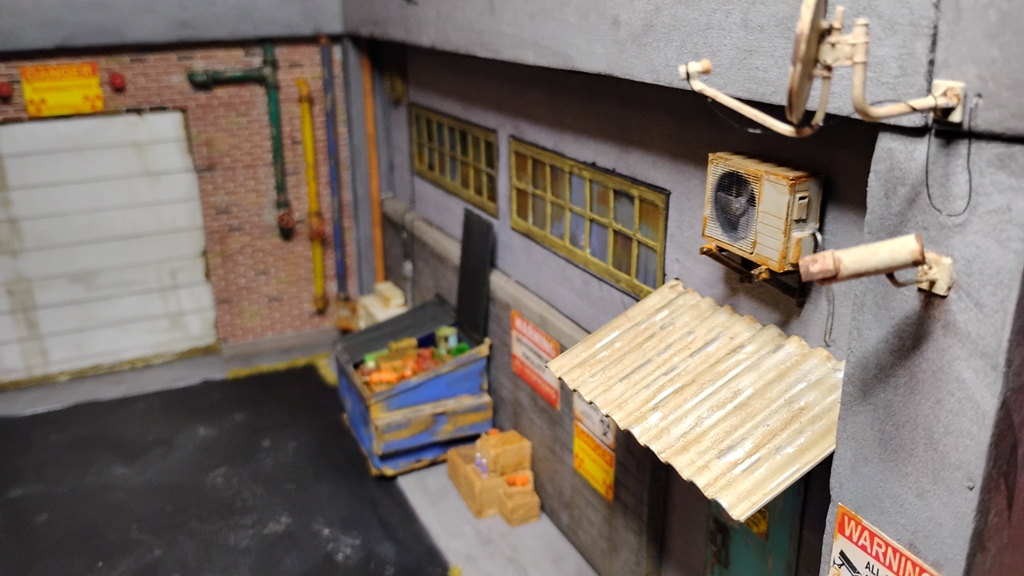

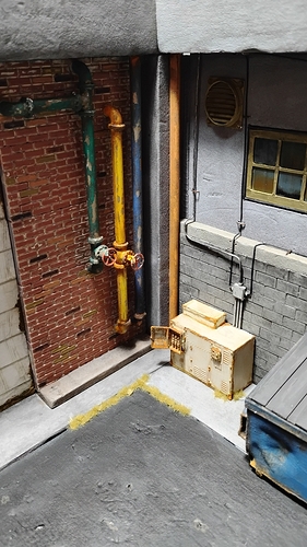

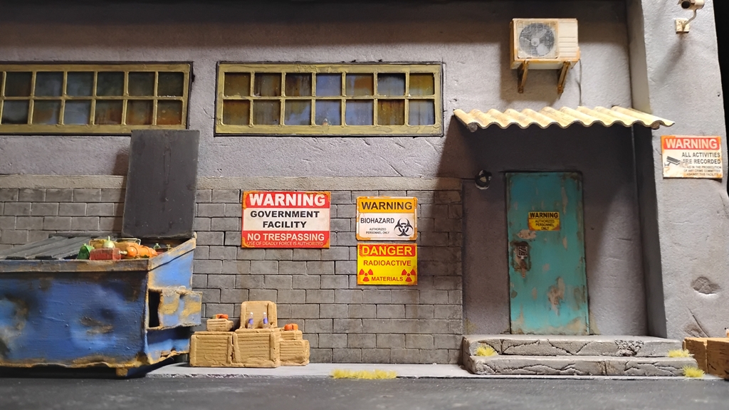

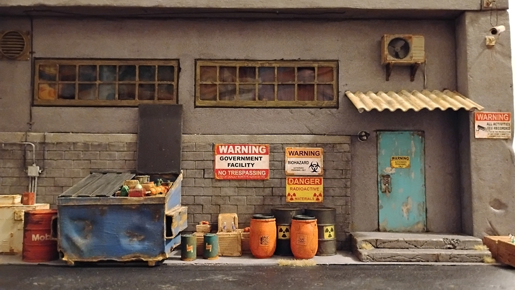

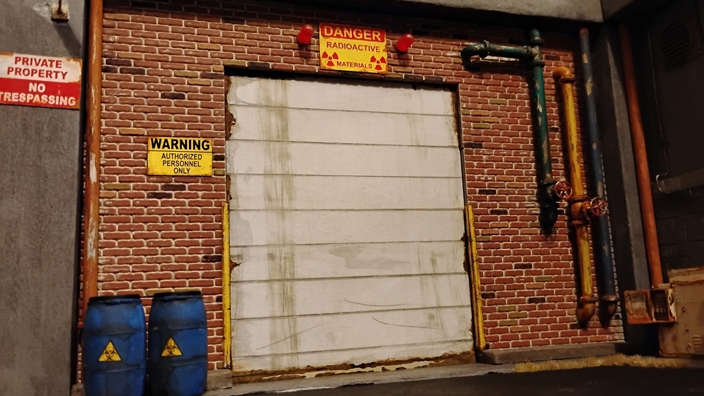

Small update I got the AC unit on along with a vent. And worked on the roll up door I cut it a bit short so not sure if I want to leave it a bit open or add in small piece and then blend it in with the rest of the door to be closed. I’m not to worried about the bits of black paint on the grey on the ground it’ll mostly be hidden by tufts of dry grass and other items. The black pavement is just well black paint with some browns added into the recesses and a very light second black wash to blend it all in. Added in a lot of junk to fill the dumpster still got to add in some paper goods to it and then then the lid top which Im hoping to have a figure that can be posed holding it open while searching the bin. Then its on to electrical wiring, a sat dish and maybe some type of mounted antenna. Barrels and drums and bits and pieces this will be one busy dio thats for sure.

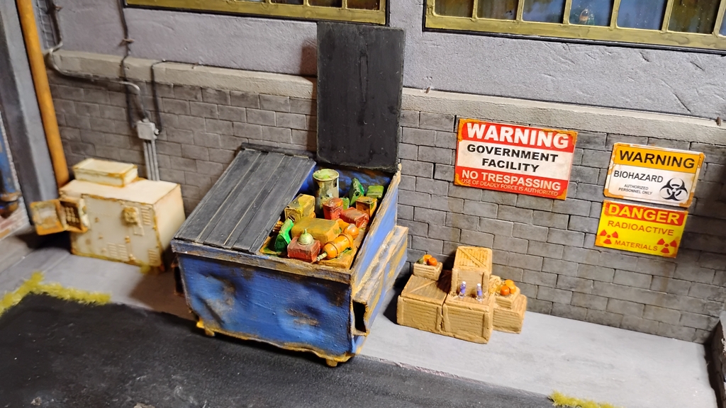

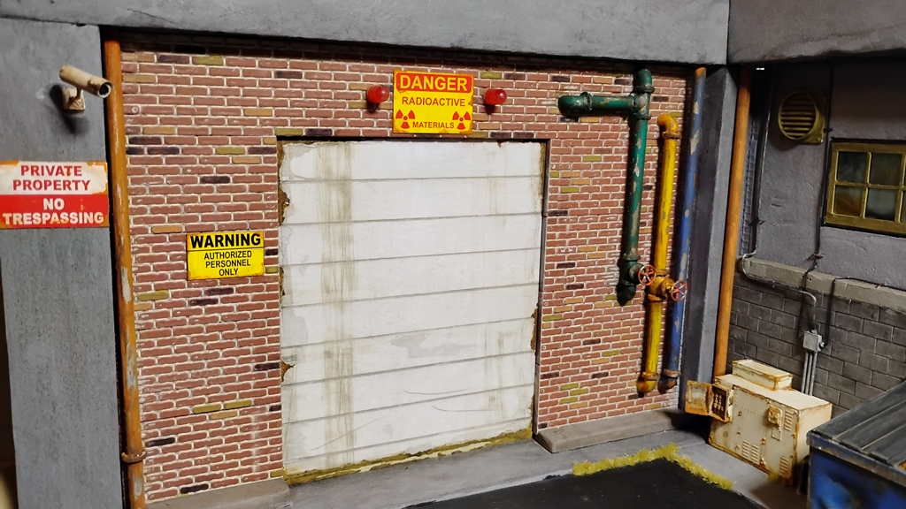

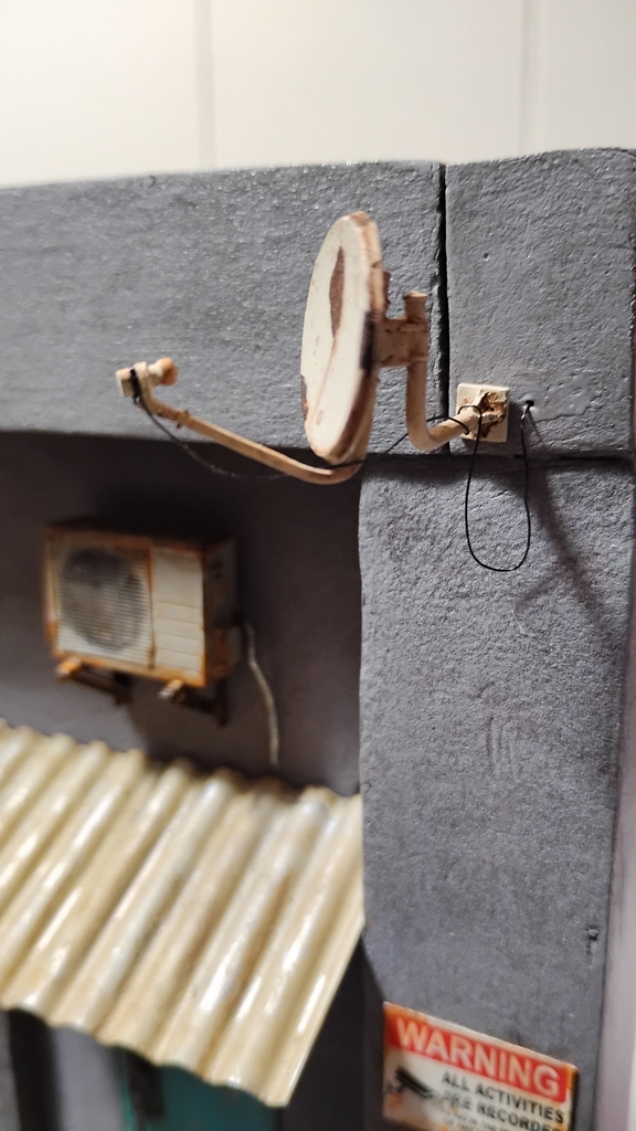

I got the electrical, satellite dish, security cameras, dumpster all finished built and installed. Cameras were made from sprue and pieces of left over PE. Next up are all the drums and barrels, then vehicles, figures and final set dressing.

Nice Rocky !!! Very realistic looking man , luv it !!!
Thank you, your work was direct inspiration for me after seeing your diorama work it’s beautiful work.

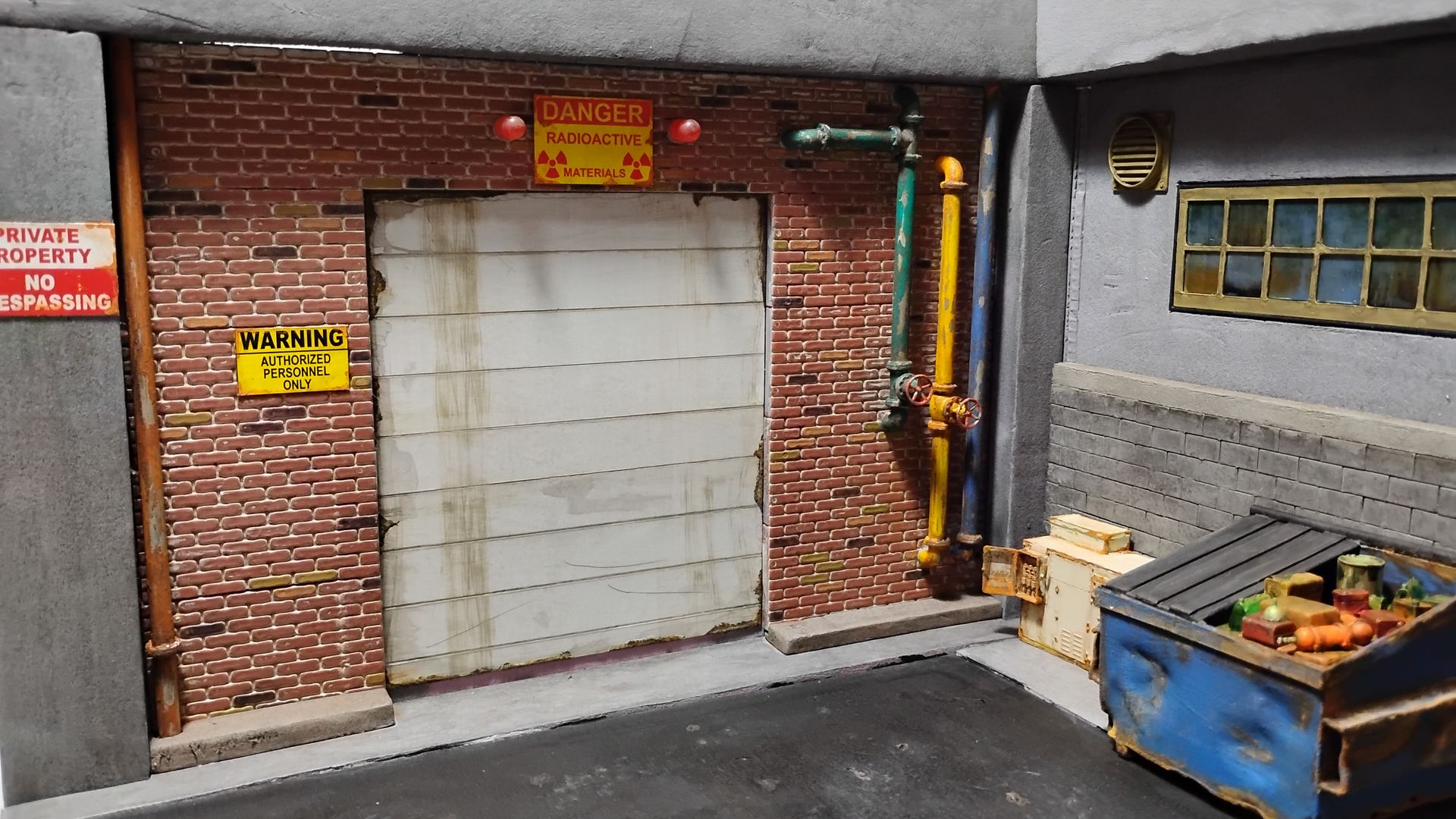

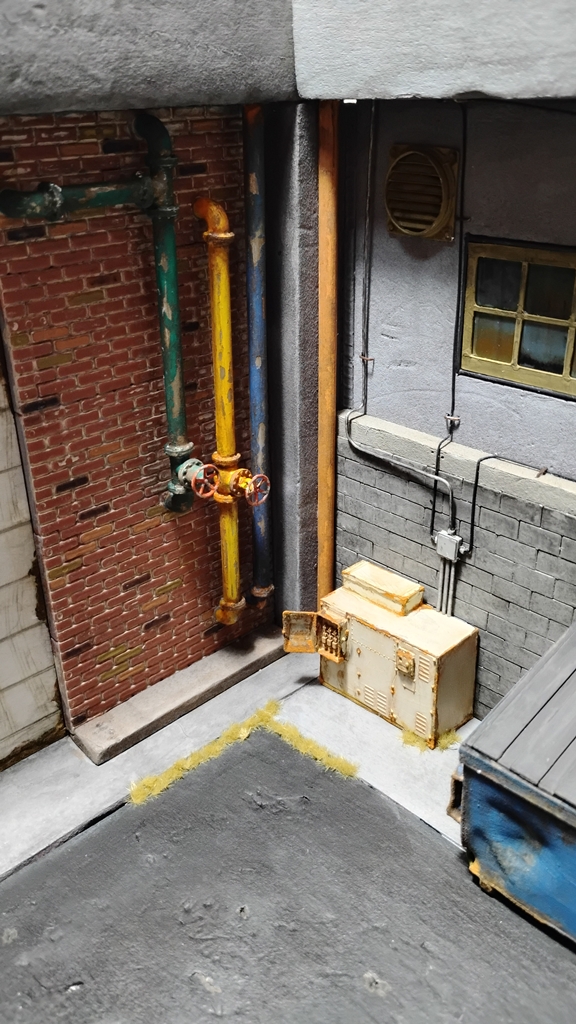

Finished up the building and junk of this build now its on to the vehicles and figures.

Now that’s photorealizimforreallookin you couldn’t tell your work from a photo of the real thing !!!
Very , very cool !!!

Thank you very much but my work aint on the same level as your man. Guess its the photographer side of me coming out its all about angles. More photos will follow as I get into the vehicles and figures.
Photorealistic for sure. The weathering is outstanding. Excellent attention to detail.
Thank you. I seem to have no issues doing weathering for dioramas yet hold back when I build any thing else. guess its fear of screwing up the decals or other fine details on the kits. :man_shrugging:

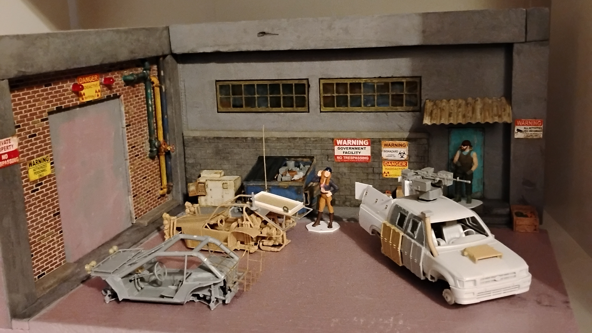

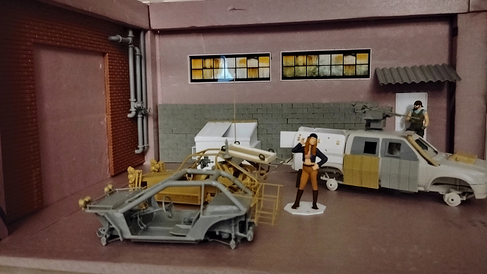

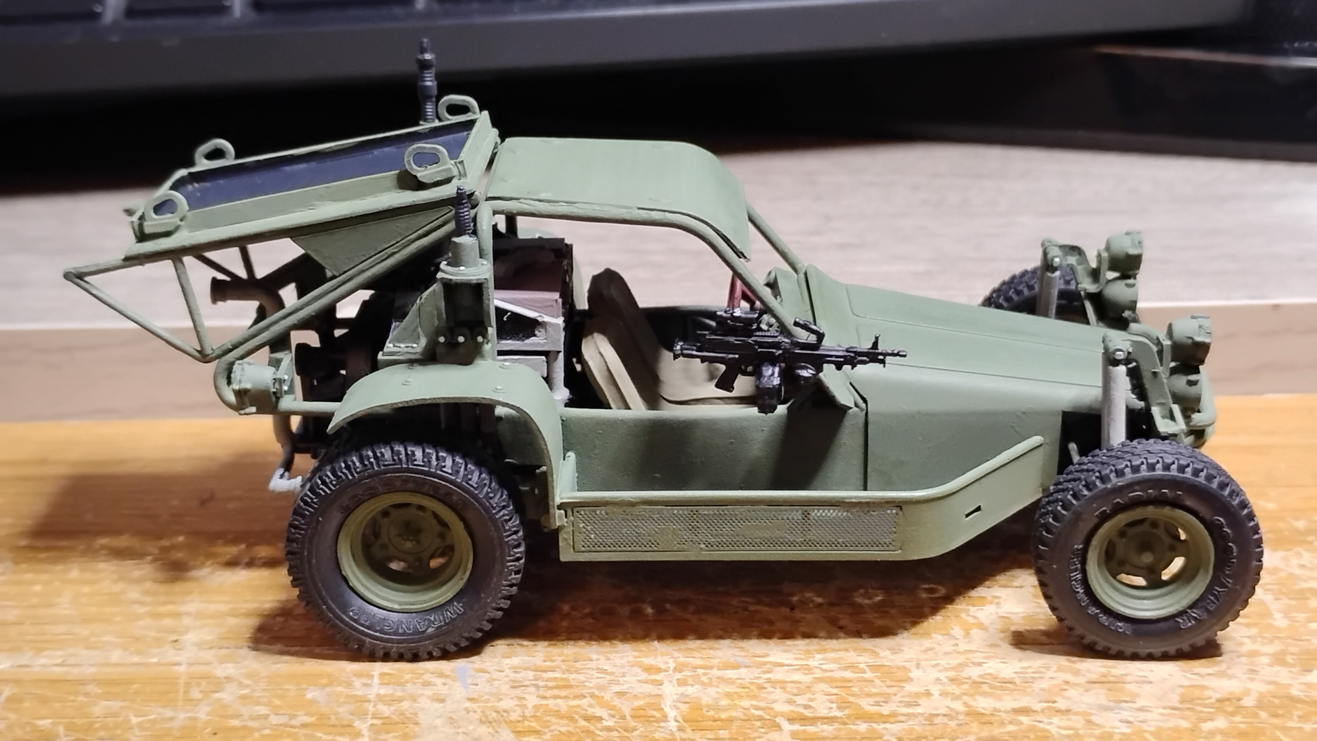

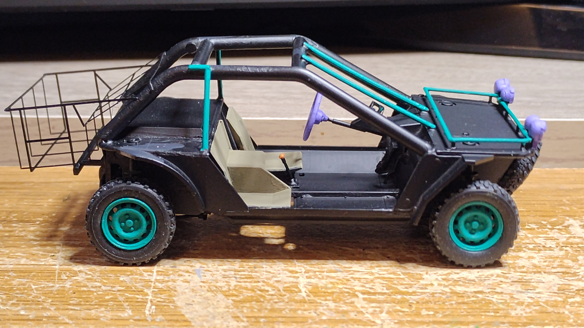

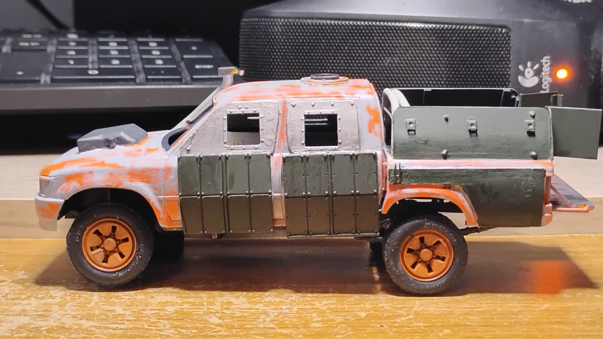

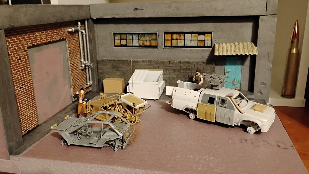

Started in on working on the vehicles for this dio. so far so slow going. yeah looks like the joker inadvertently joined the group.
Amazing diorama. Lots of details and excellent painting and weathering.
Thank you, these builds have been a learning experience. Lots of talented builders on these forums to draw inspiration from.

Nice MadMaxian rat rods !! They look great .
Thank you @Cheyenne and @strongarden hope you enjoy the trip.

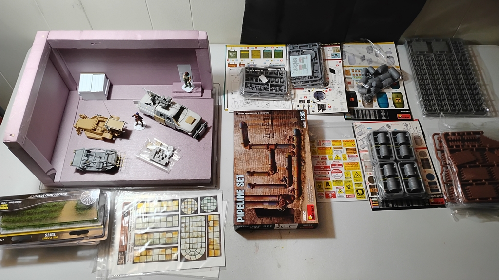

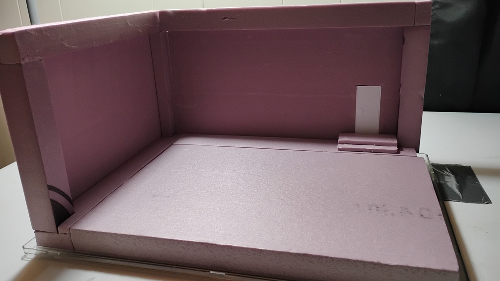

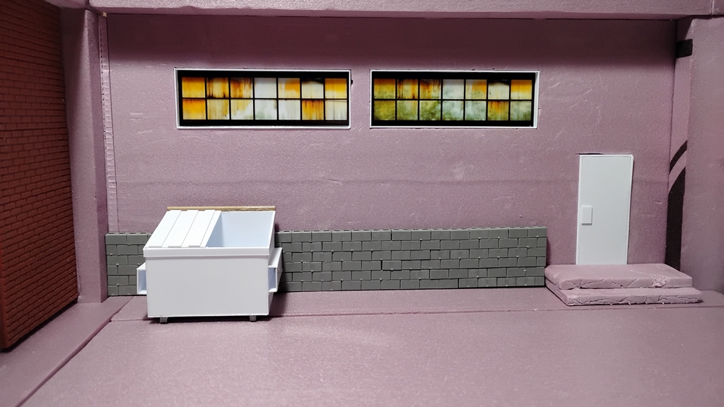

Heres a prebuild showing all the things used and very early build and test set up pictures.

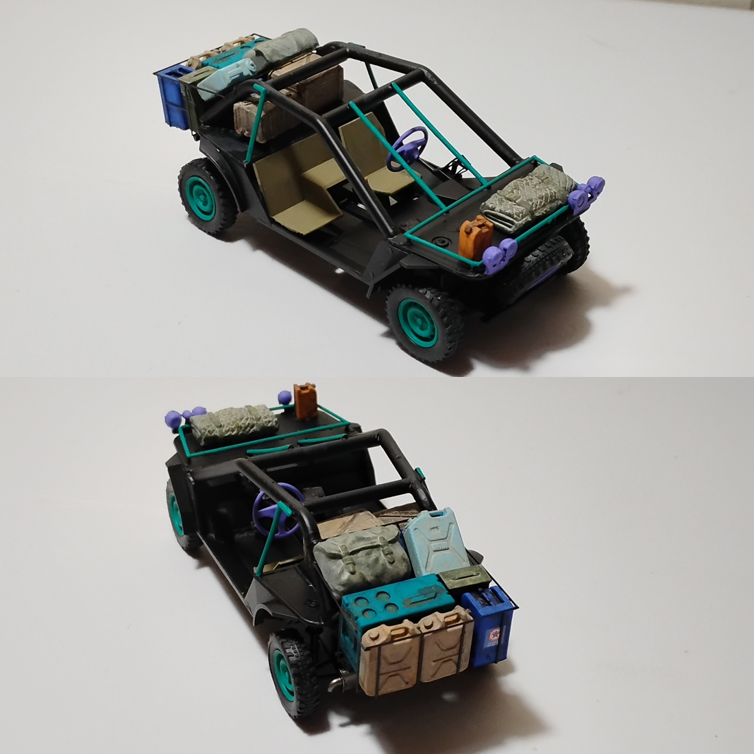

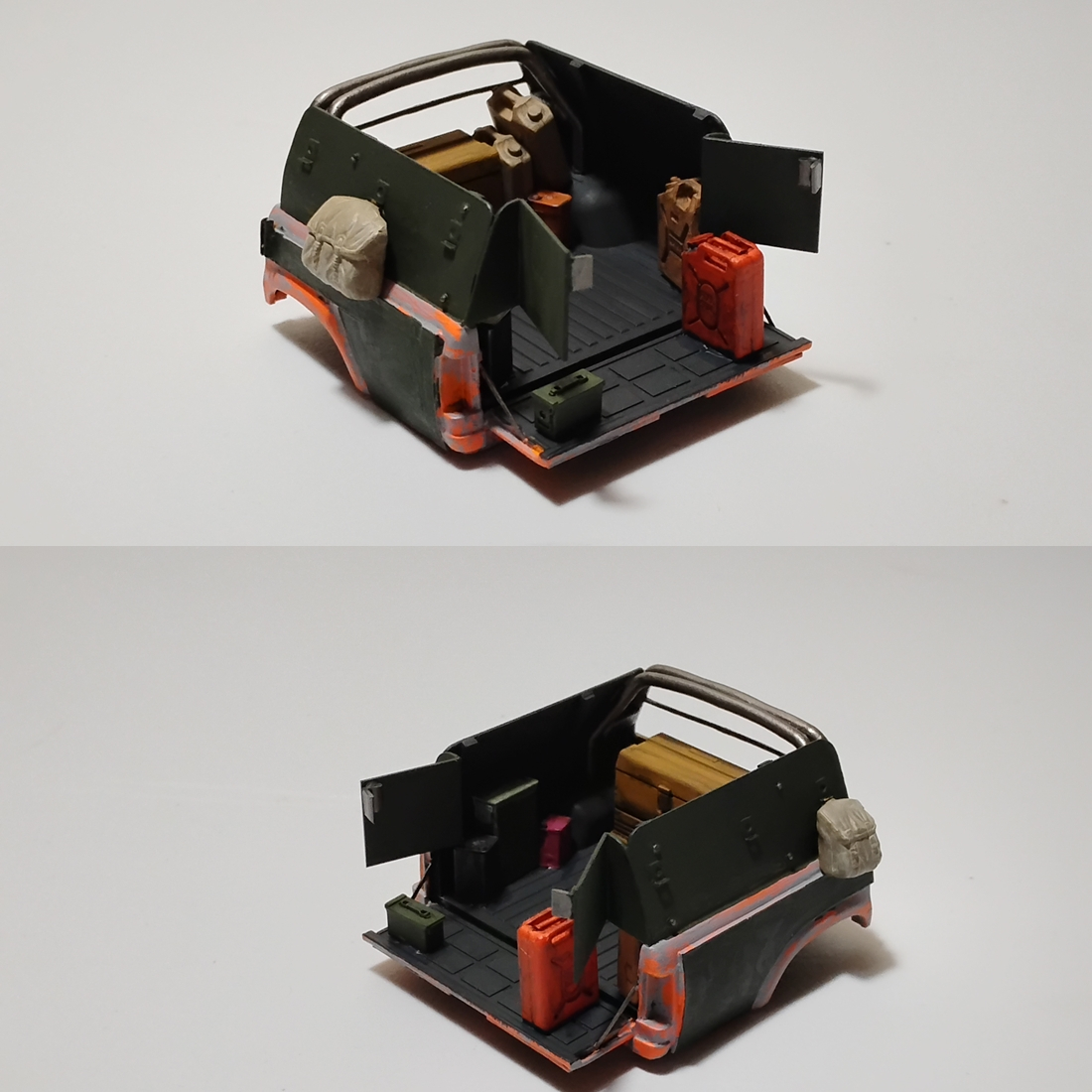

Started working on the stowage for the vehicles once I get that squared away then to figure out the tie down style for everything. Then on to figures for the diorama.
