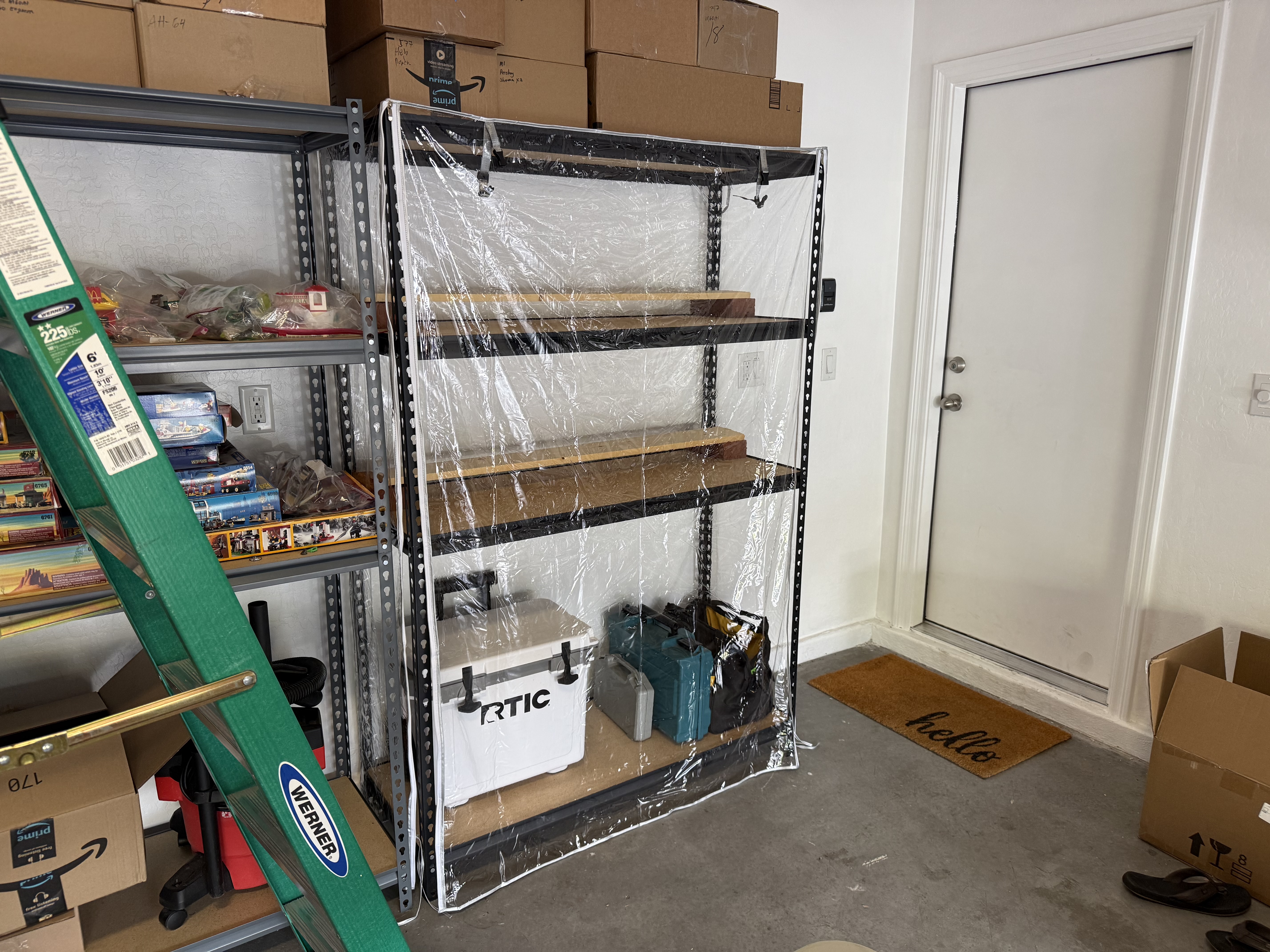

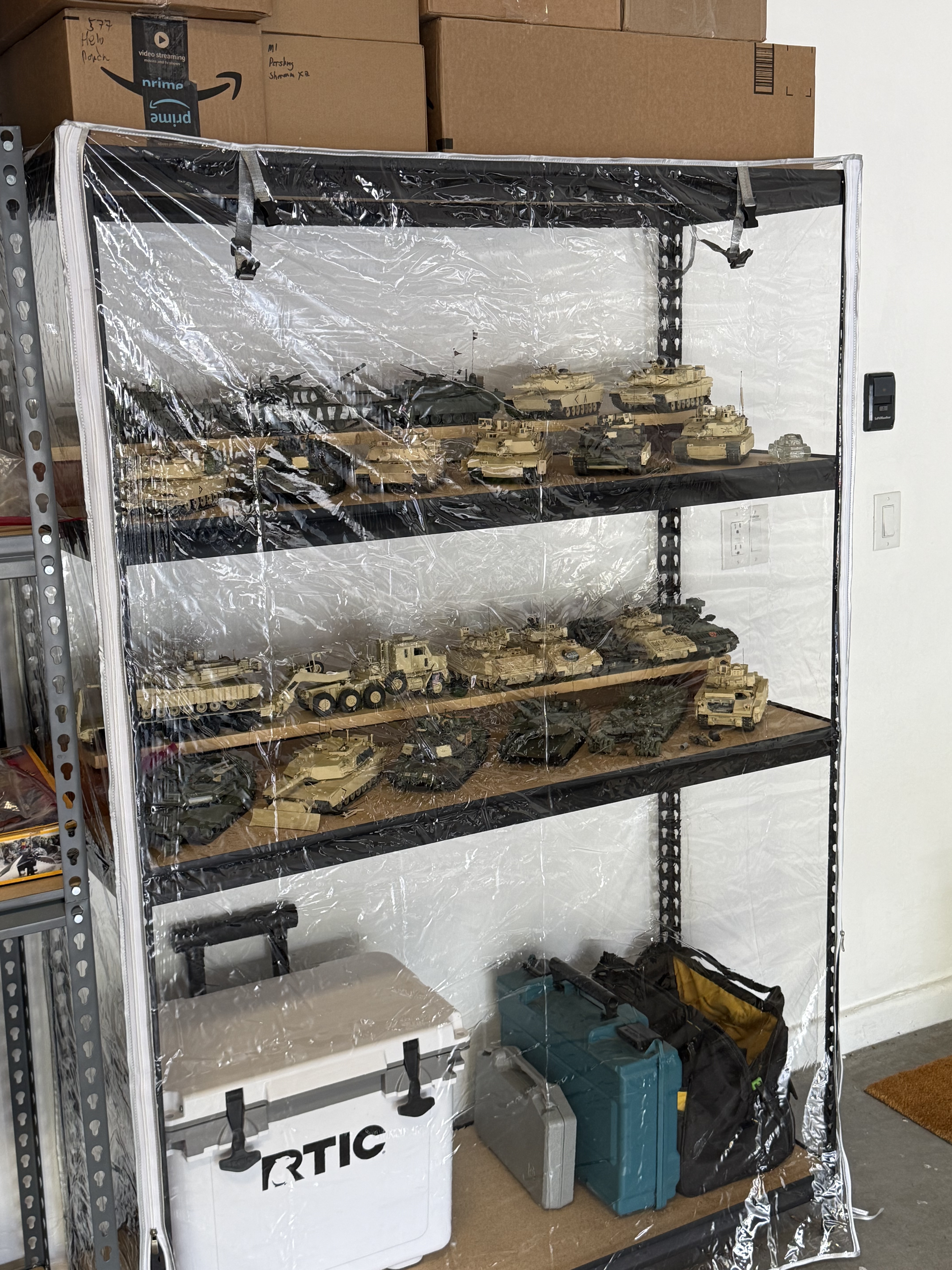

Check this out, Dan, found these on Amazon, come in different sizes for shelving, which I needed badly to keep the dust off
Do you have a link or what they are called so I can look them up?
My models are displayed in the garage, so I was desperate for something to keep the dust off, I’m gonna order a few more for the other shelves as I unpack and sort my built kits
