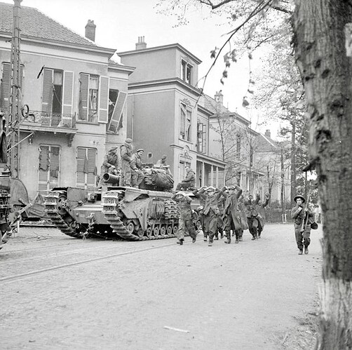

Churchill Tanks in Arnhem after the Market Garden event
IWM. Photo
Yes it is, but it is a specialised vehicle from the Royal Engineers so is not really indicative of the presence of a Churchill-equipped Tank Brigade.
Cracking photo mind, and would lend itself well to a decent diorama in its own right..
That’s a Churchill AVRE part of 79th Armoured and not a gun tank. 79th Armd were assigned as needed so could in theory appear with any other Brigade as the need arose.

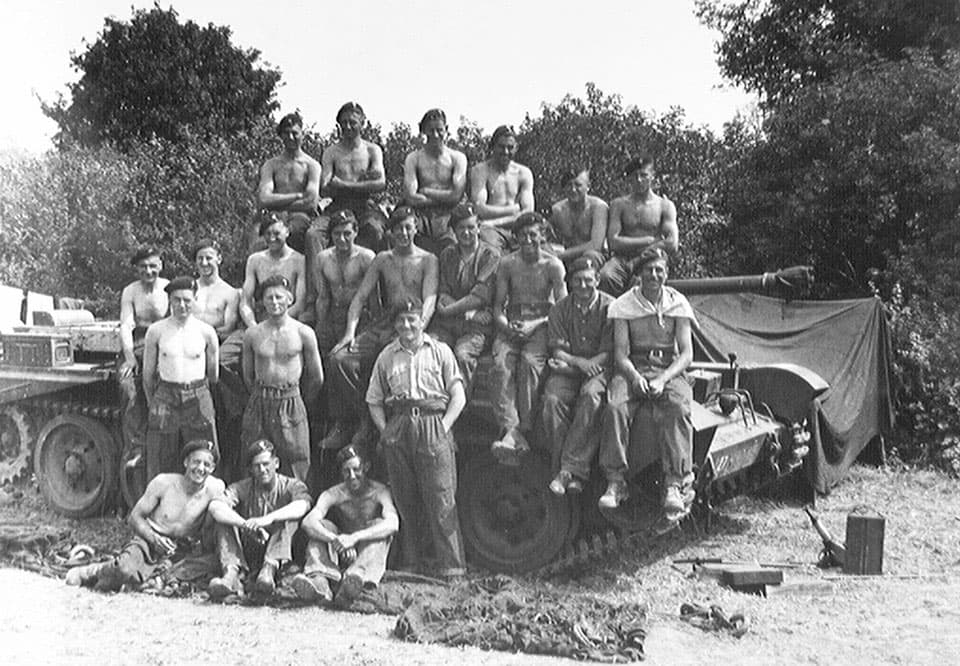

2nd Battalion Welsh Guards were the Armoured Recce Regt for the Guards Armoured Division, Cromwell of the 2nd shown

That’s when Arnhem was actually liberated, April 1945, almost seven months after Market Garden, so not really relevant to the question.

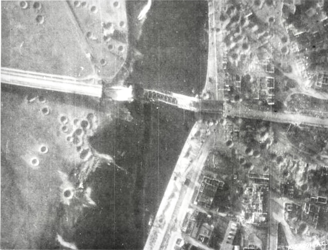

The bridge a short time after the Allied forces left the area.
