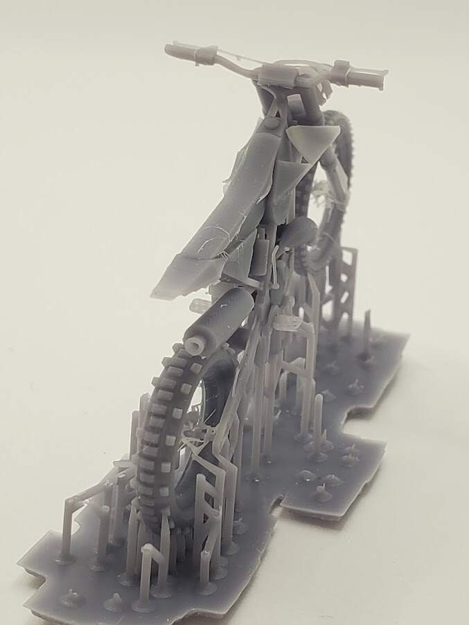

I’m scraping this project. A test print confirmed my doubts that the spokes are too thin to print in 1/35.
It’s unfortunate even though the rest of the bike came out nicely:
You could always use the PE spokes from one of the Bronco or Miniart motorcycle kits.
Yeah, that’s nice but it will be forcing a separate purchase. I wanted to do a one-stop shop approach.
I may be able to pull it off in 1/16 if I over-scale it a bit but probably not in 1/35.
Might be your printer and a limitation but I have seen 3D printed spokes for sports cars.
This looks similar.
It’s a shame to let that work go to waste. Some folks use fuse wire to replace the spokes on kits. The most time consuming part of it is drilling the holes. If you could print those wheels with holes in the hubs and rims (or even dimples) for the spokes, those who choose to could add the spokes themselves. They look better than PE anyway.
Those who don’t, well - when moving the spokes are a little hard to see anyway…
If you did the hubs and wheels in two halves this method would work as well:
Ryan and Rob,
You two just gave me some inspiration on how this may work! :smiley:
OK, it may work if I overscale the spokes a bit more - separate the wheel parts from the bike in CAD and replace the existing spokes with thicker wires in CAD.
Back to the drawing board then. Thanks.
