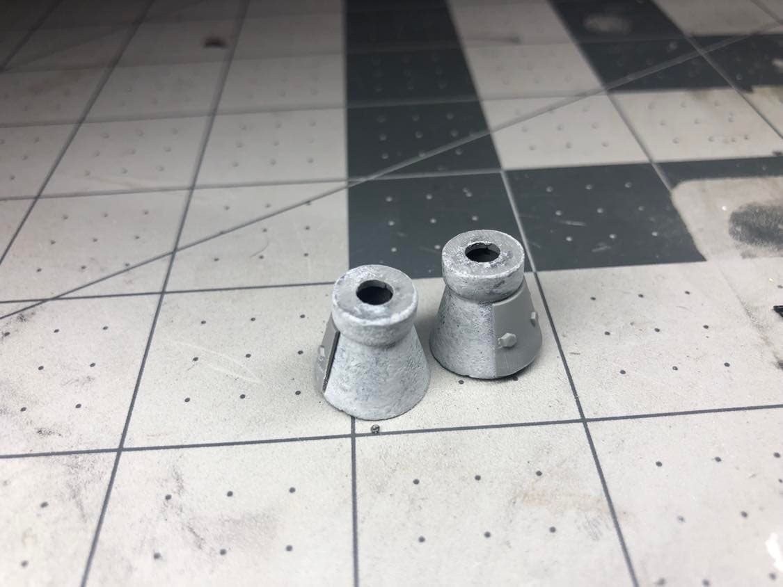

Put together the sprocket hubs and added some cast texture. From what I can tell there should be a few welds attaching this to the hull, but I will need to wait for my epoxy putty to arrive.

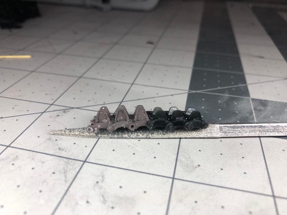

Here you can really see the difference. On the left in brown is the kit supplied tracks, and on the right in black the 3D printed ones from Tankbrusher STL.
