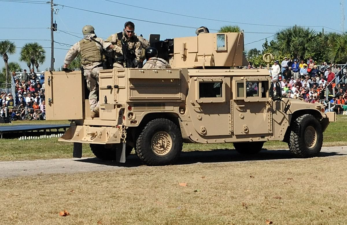

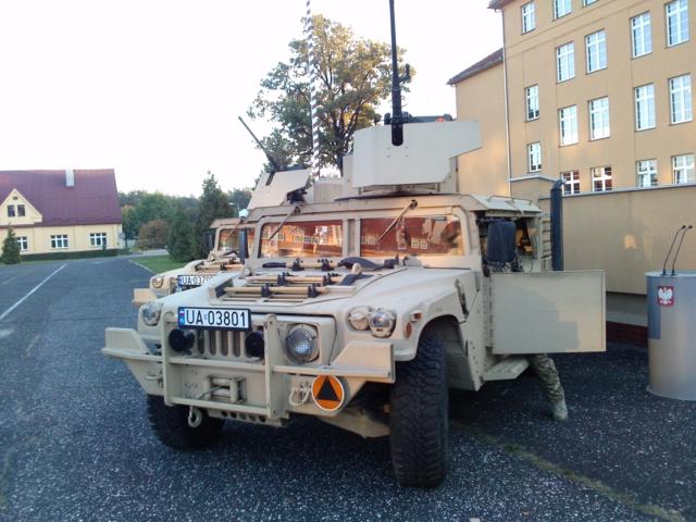

The model looks great. It is clear that you have put a lot of work and additions into it. The figures are elegant. It is good that you mentioned that the vehicle is not inspired by any specific photos. The GMV M1165, despite the M1151 base, does not have its sides armoured in this way. If my memory serves me right, there is no M1151 GMV (without the doors and with the extra armouring). The M1165 GMV has 2 basic variants- with all doors and a built-up rear, and with doors (half). The photos show both versions.
