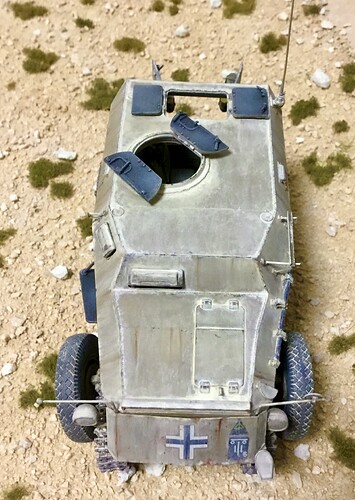

The SdKfz254 full build is going along steadily…

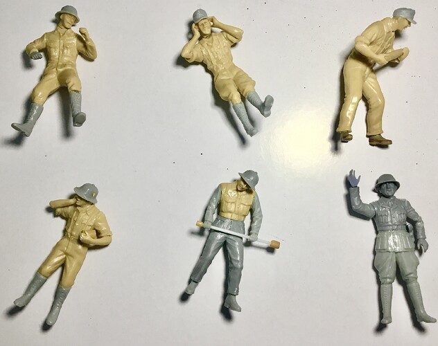

Needed a change from building vehicles and have roughly finished the DAK artillery crew. Puttying gaps is next. Most are figures from a Trumpeter set and a couple cobbled together from spares.

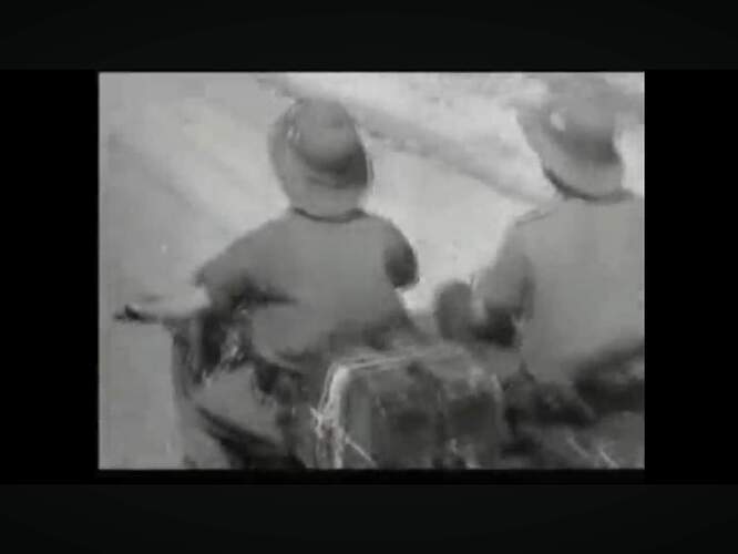

Seems strange to see guys who are actively working wearing the pith helmet rather than the Feldmutze.

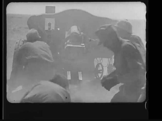

Not so strange just less common, I think. Reference images from period film such as these are why I chose a mix of headwear for the crew. No problem. Makes for interesting figures, too.
point taken, though the film was made for publicity purposes, and the virtual universal disdain for the pith helmets in memoirs and diaries as well more candid pictures show them worn infrequently.
I don’t really agree they were being worn merely because they were being filmed for propaganda reasons. They may have gone out of use because of being unpopular but there are a fair few images of them in normal use early on across various units.

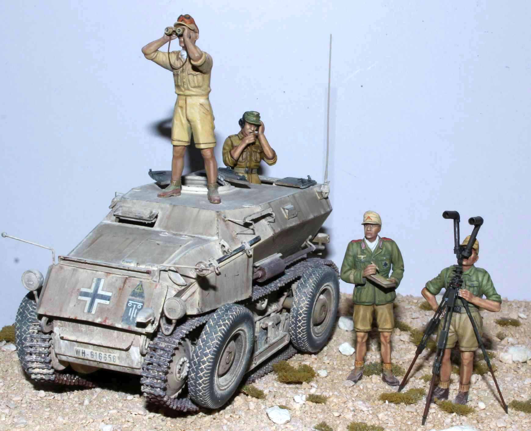

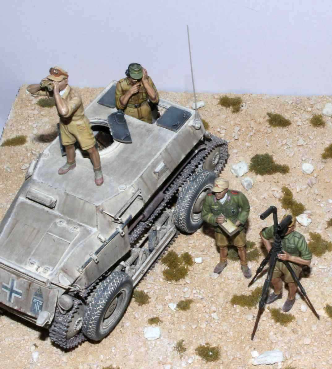

First vehicle completed…

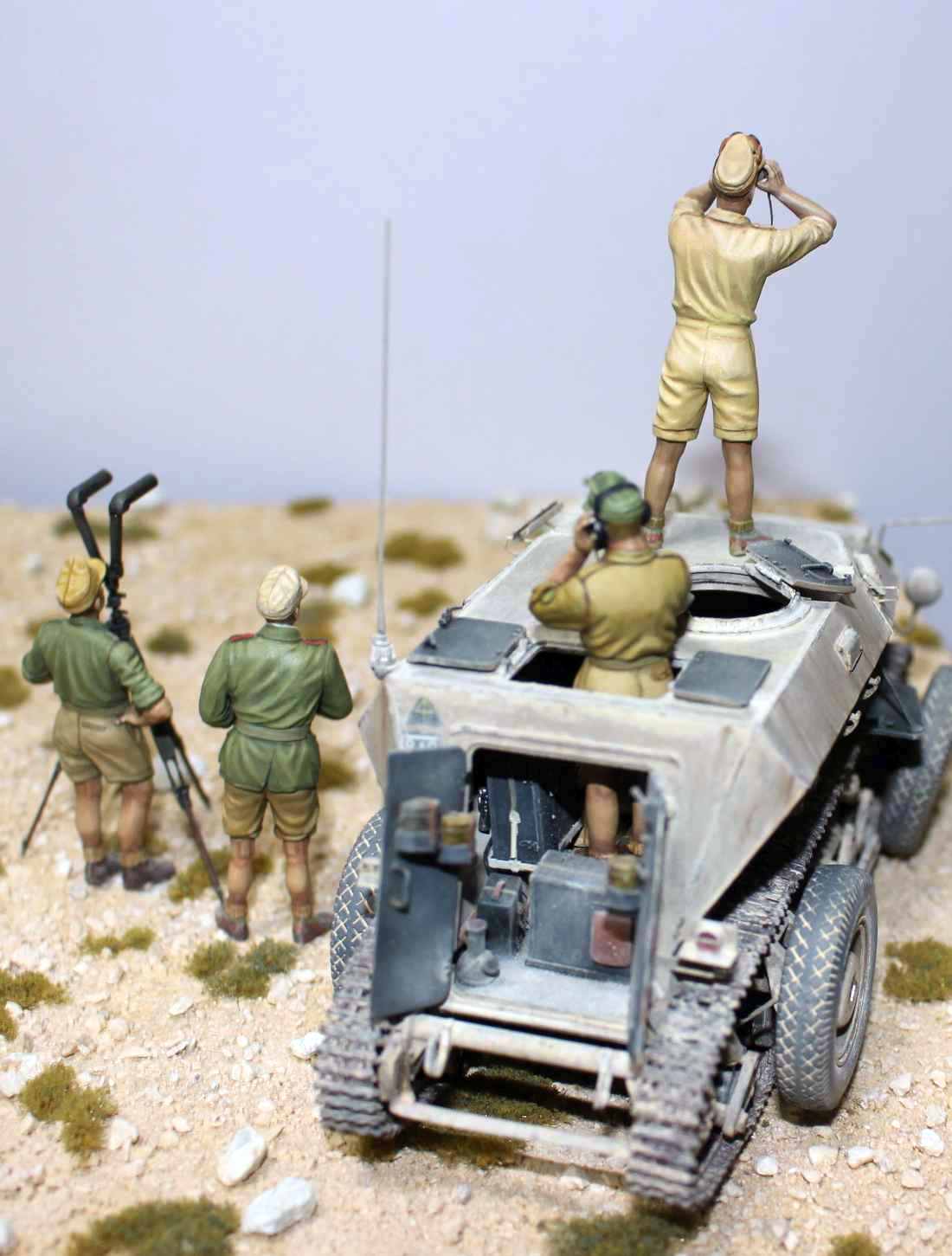

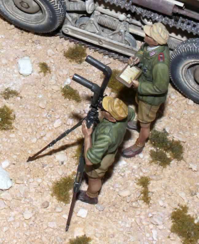

Finished the figures for the 254 crew part of the diorama… Apart from the radio operator, they are recycled figures, two of which I modified. The radio operator was built using spares and the head and modified arms of a Dragon Wehrmacht Signal Corps figure.
I’m happy I could integrate the figures and vehicle to reflect an aspect of its likely role.

Jeremy that vehicle looks great but the figures are the icing n the cake! They look excellent!
The seen looks great.
Cheers for that!
Thanks very much.

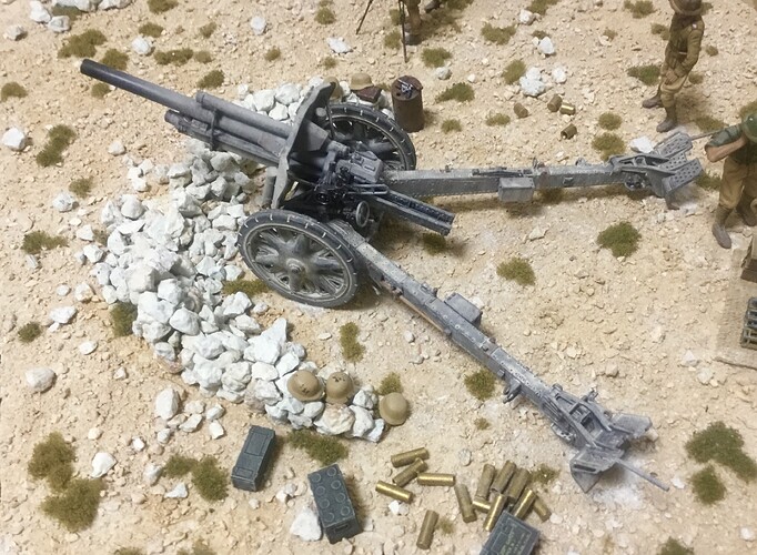

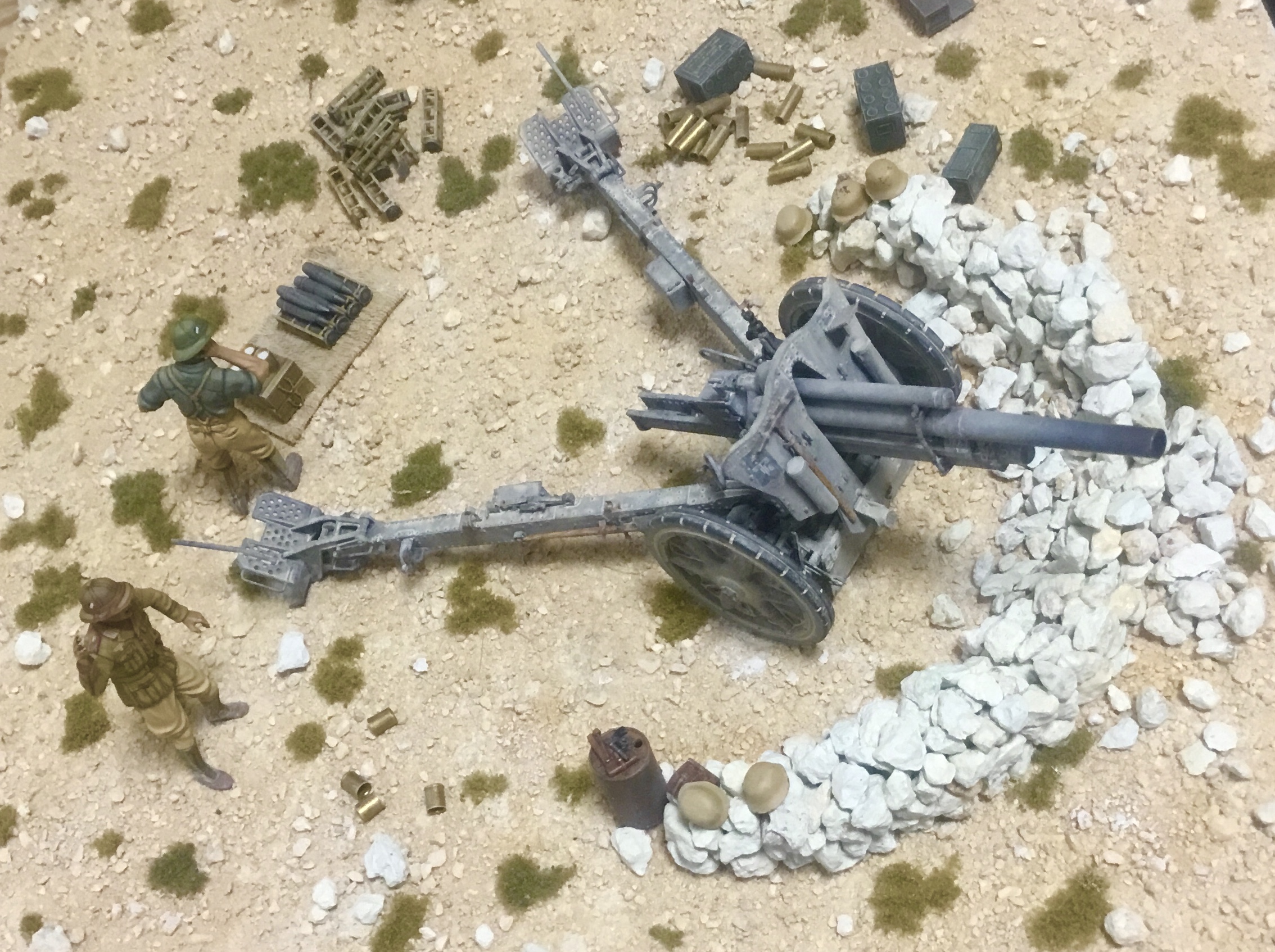

The artillery is done… difficult to do actually. I tried worn effects over the dunkelgrau base then the RAL8000 gelbbraun. Used water to remove the topcoat and sealed it, then a highlight RAL7027 which I weathered with Tamiya A20 thinner. Then dark wash and a couple of sand pigments streaked using thinner plus some dust… still find DAK a challenge but looks ok.
Looking terrific Jeremy. May I suggest a bit of graphite on the breech carriage rails and the handwheels???
Ah, thanks for that tip…
