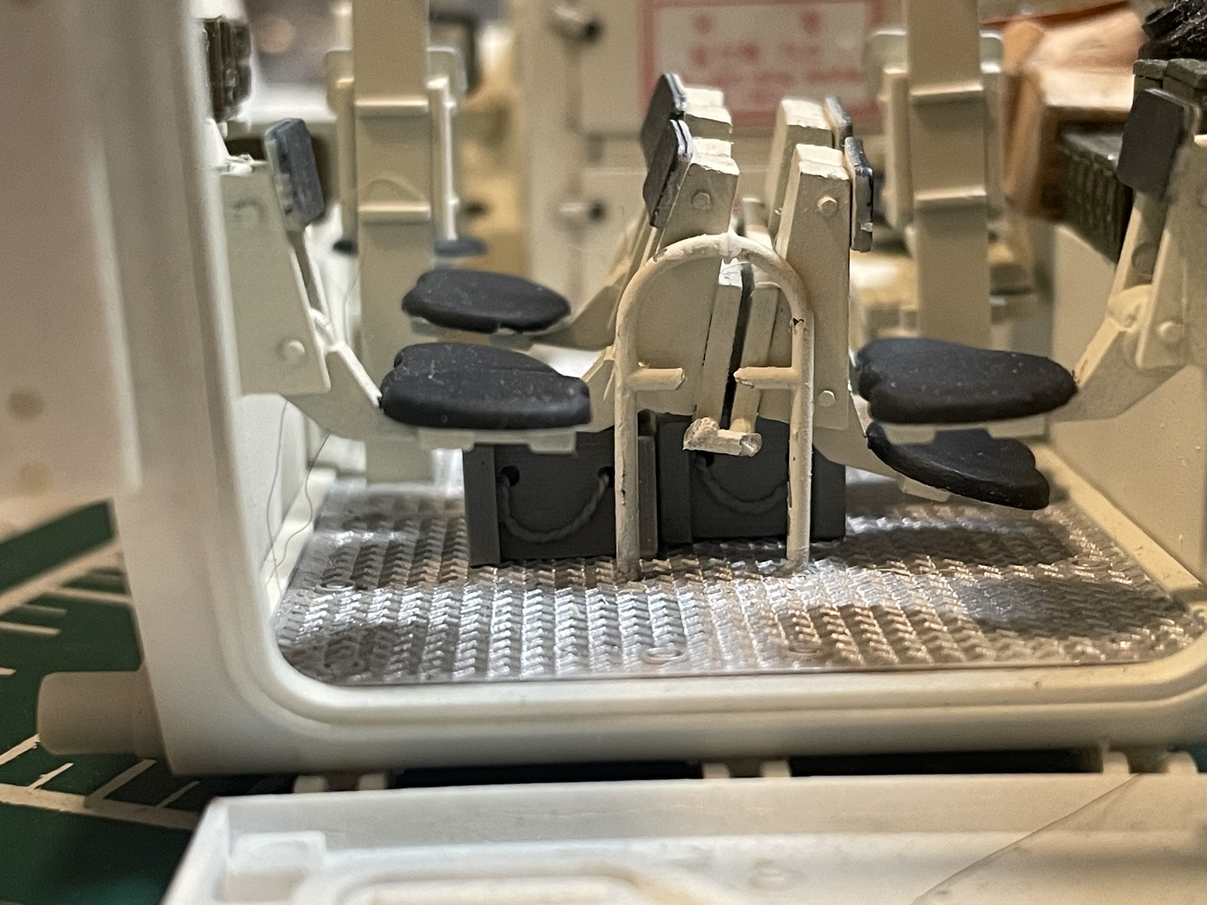

This is what i have so far… nothing is glued down yet cause i can’t make a decision, i put wooden box under the middle seats cause the thing keeps breaking! Would wooden box’s be a thing on a modern apc? As usual all tips and criticism are welcomed
Stowage looks good. Nice and lived in.
Yes, .50 cal ammo (and others) still come in wooden crates.
