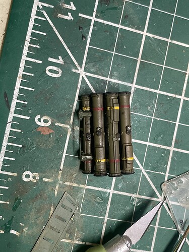

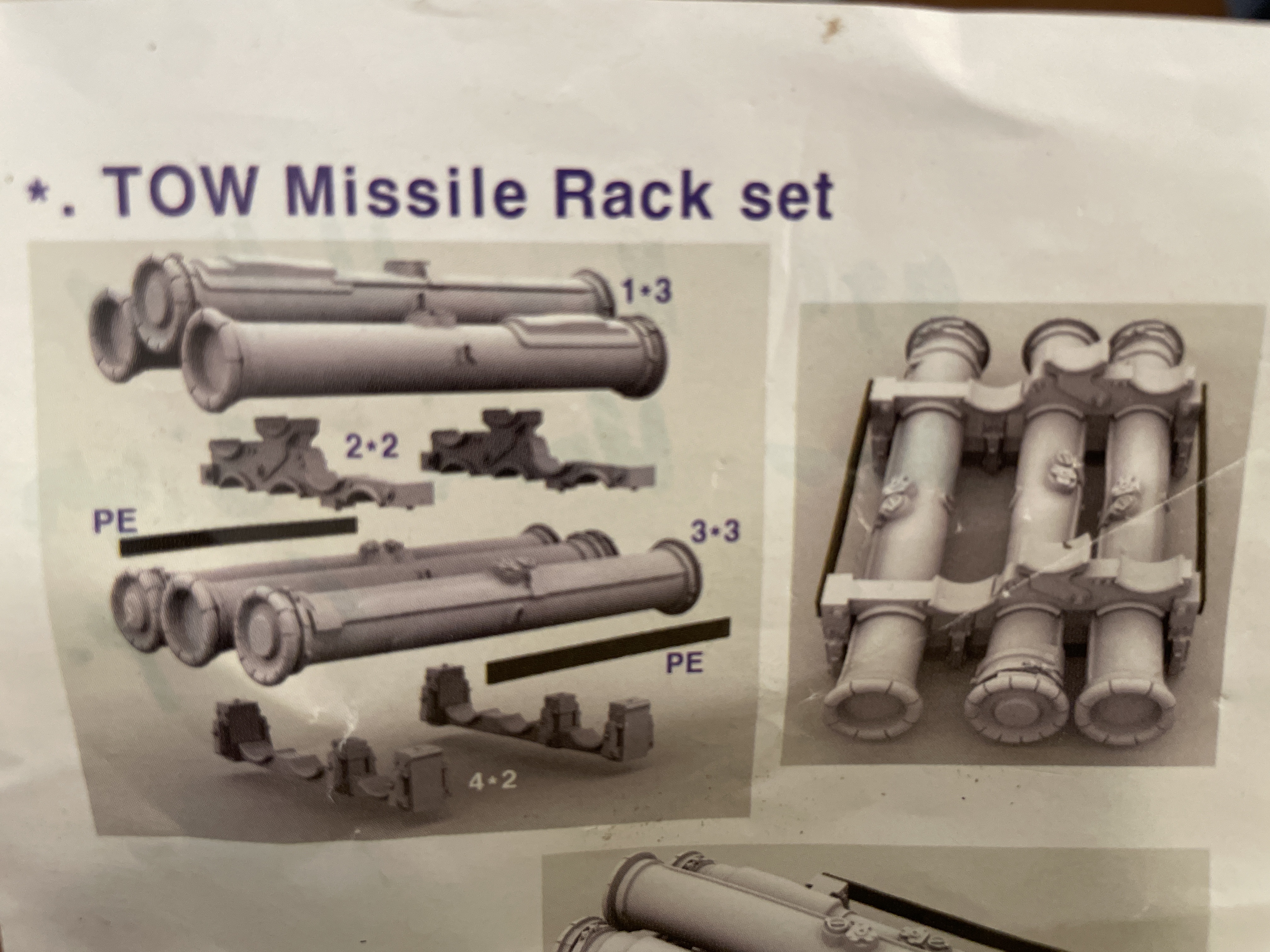

Why would the instructions be showing this?

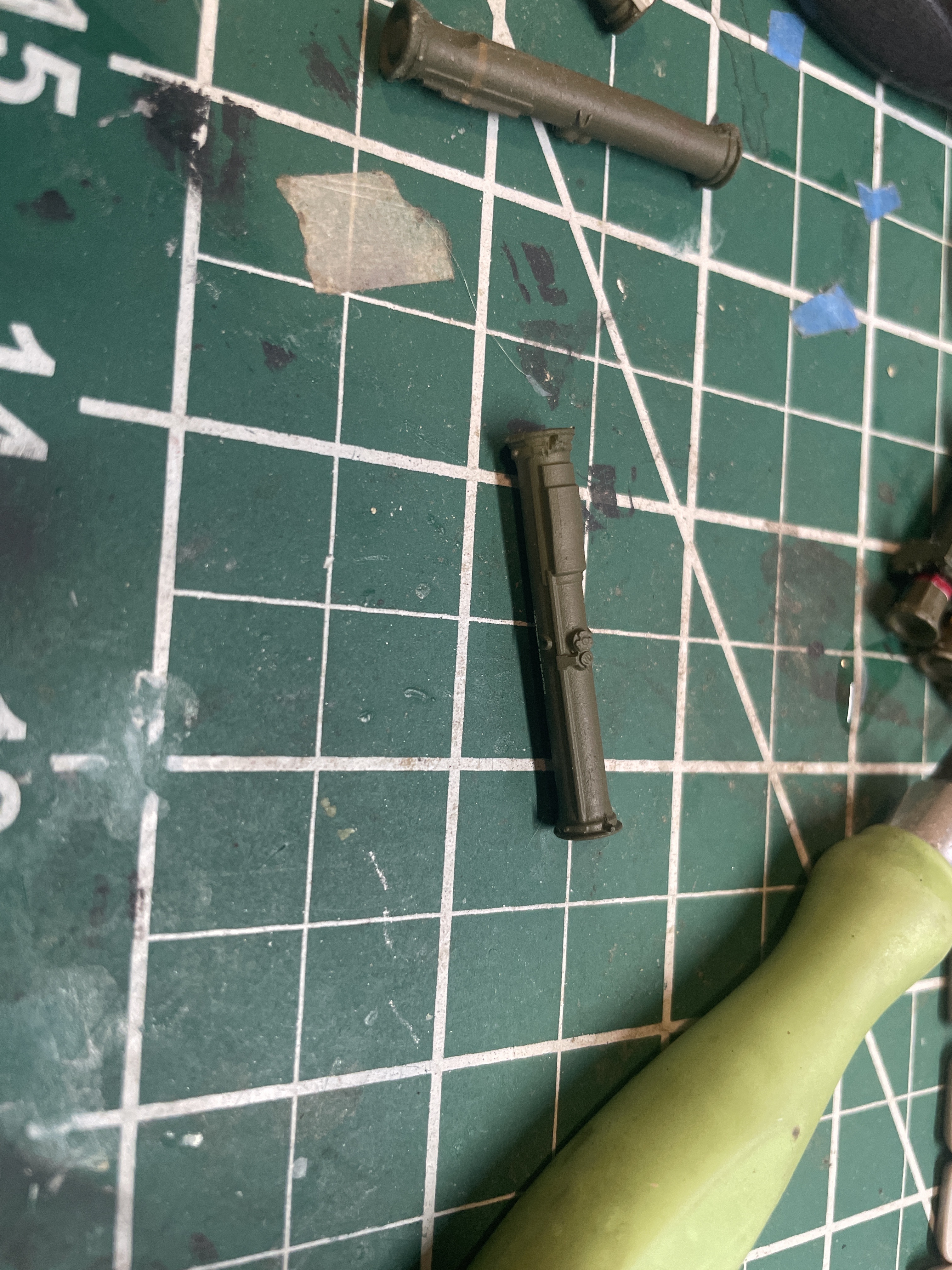

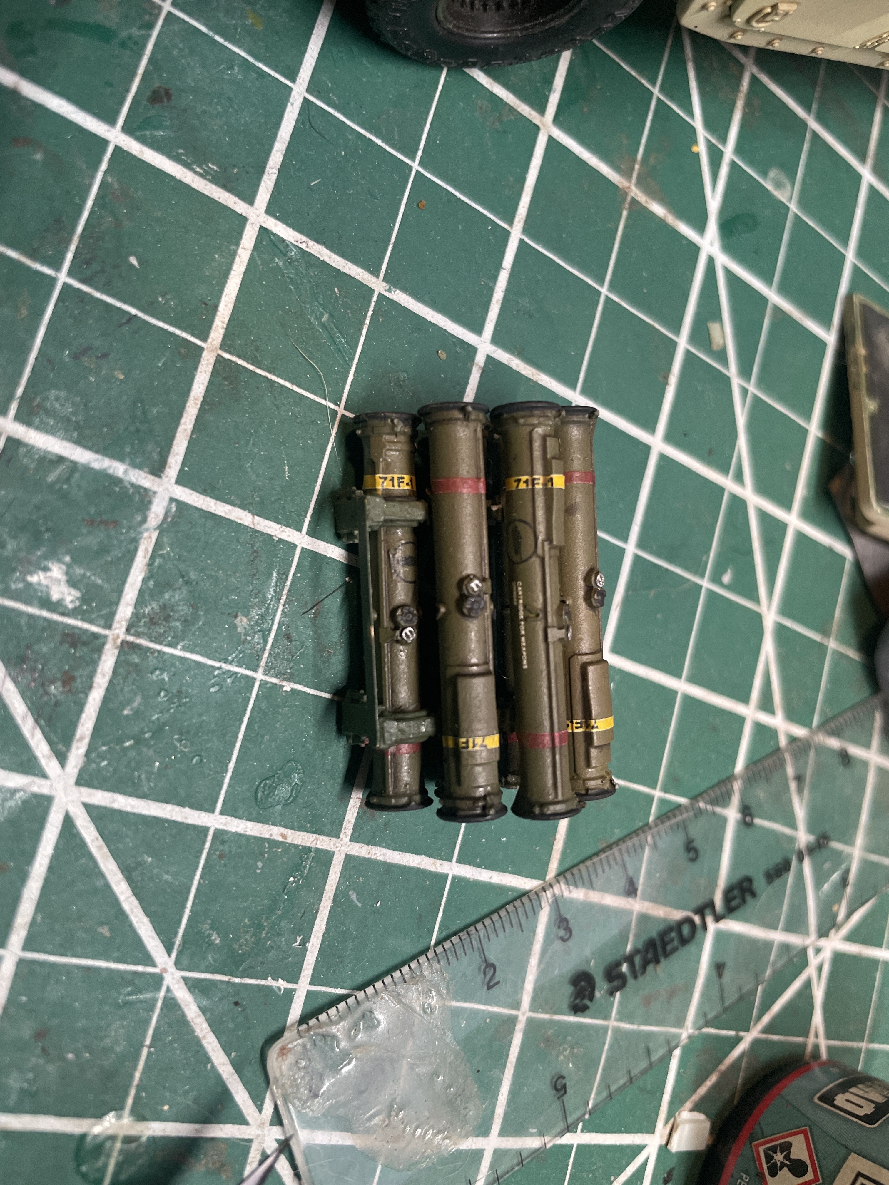

Another question is would the stripes be covered Like this
Or sticking out the sides like i have
The stripes are really not going to matter once the missile is taken from its shipping case and placed into the vehicle’s missile rack. Those come from the factory in standard locations.
It appears that the M1167 has the missile rack installed for side to side carriage, not front and rear. And I did find a photo of the load plan placard inside the M1167, and it is specified that the missiles are to be stowed in an alternating manner. I’d hate to be that loader because such a configuration involves some weight gymnastics flipping the missiles with the warhead pointed to the vehicle right side. As you can see, the bottom three missiles are also stowed on their sides, likely due to that box at the top of the nose end and clearance with the overhead rack.

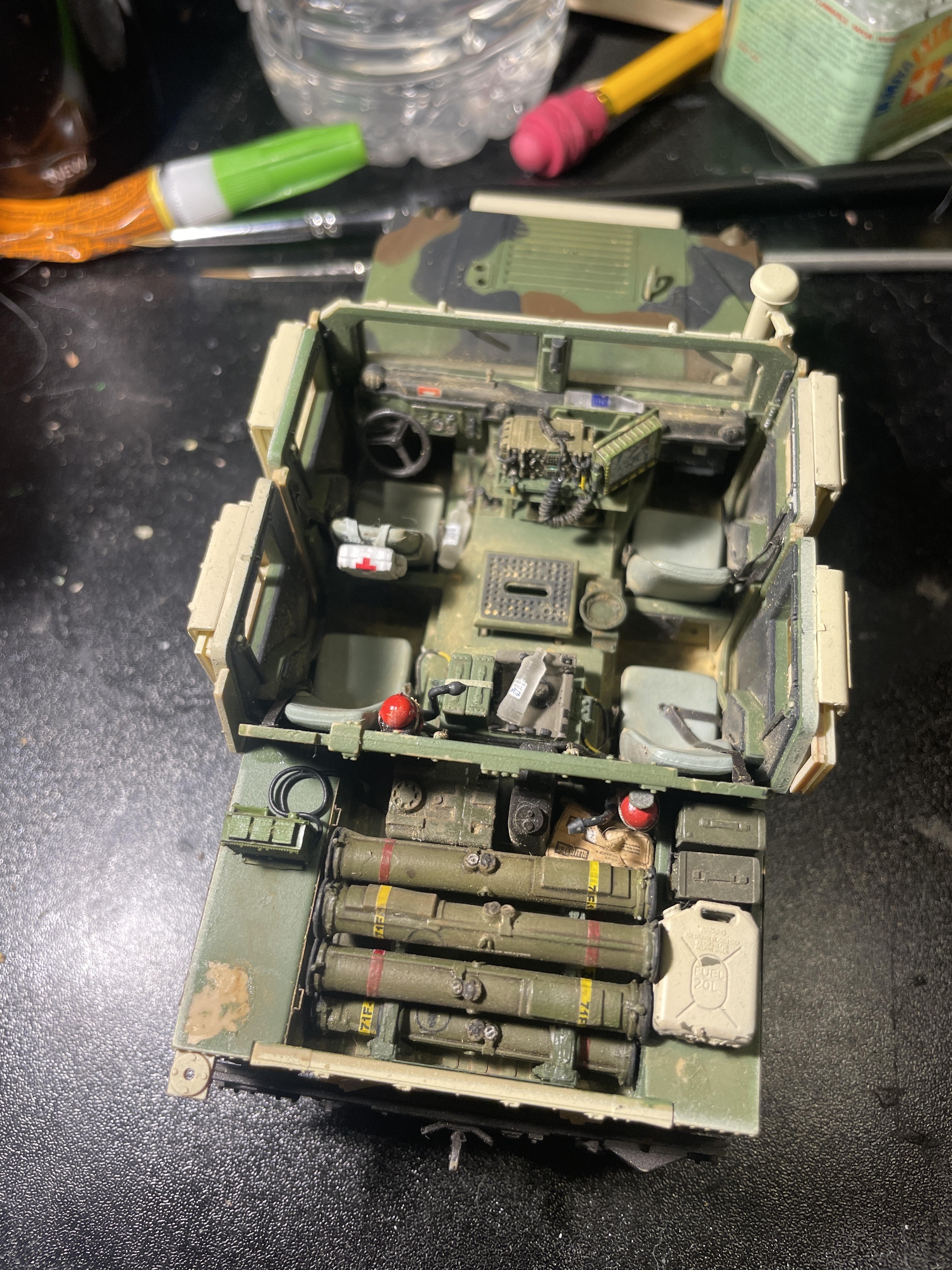

Here is the finished missile rack! Based on some references i think i messed up unfortunately it’s too late now… let me know what you think!
One more question… what color is the vmc?
TOW tube rack looks solid. :+1:

Great job I really like the interior.

Looking good so far.

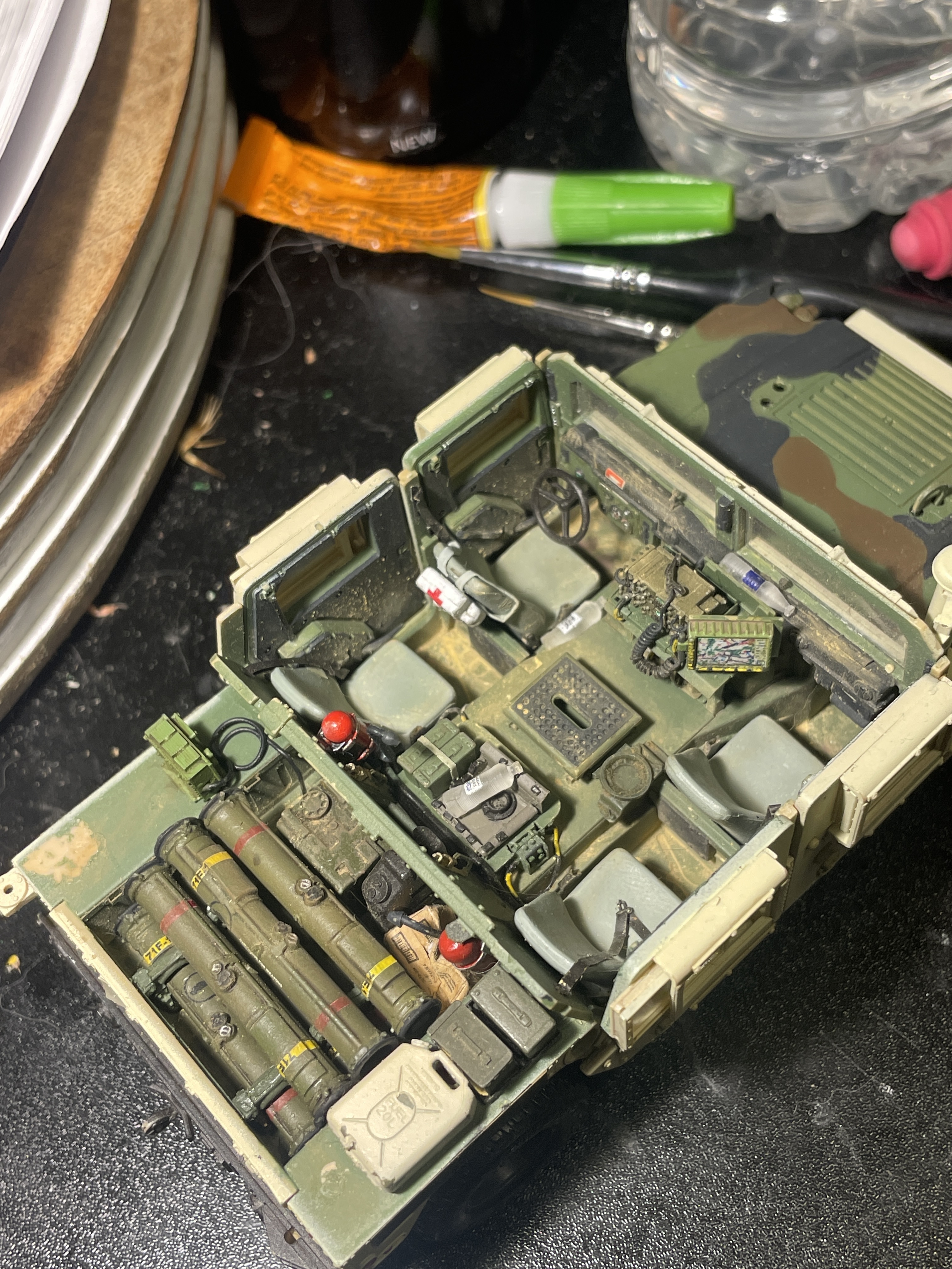

Thank you all for the comments! I finally have in interior 100% done
Let me know if I’m missing something
The interior looks excellent! Now just some personal touch items from the crew and you’ll be all set.
Like magazines, an M4 carbine lying on the deck. You already have the water bottles, maybe an MRE pouch.
That looks damn fine! Really great work. Yeah, maybe a couple of MRE pouches and some well dog-eared magazines would really round it out and make it look lived in.

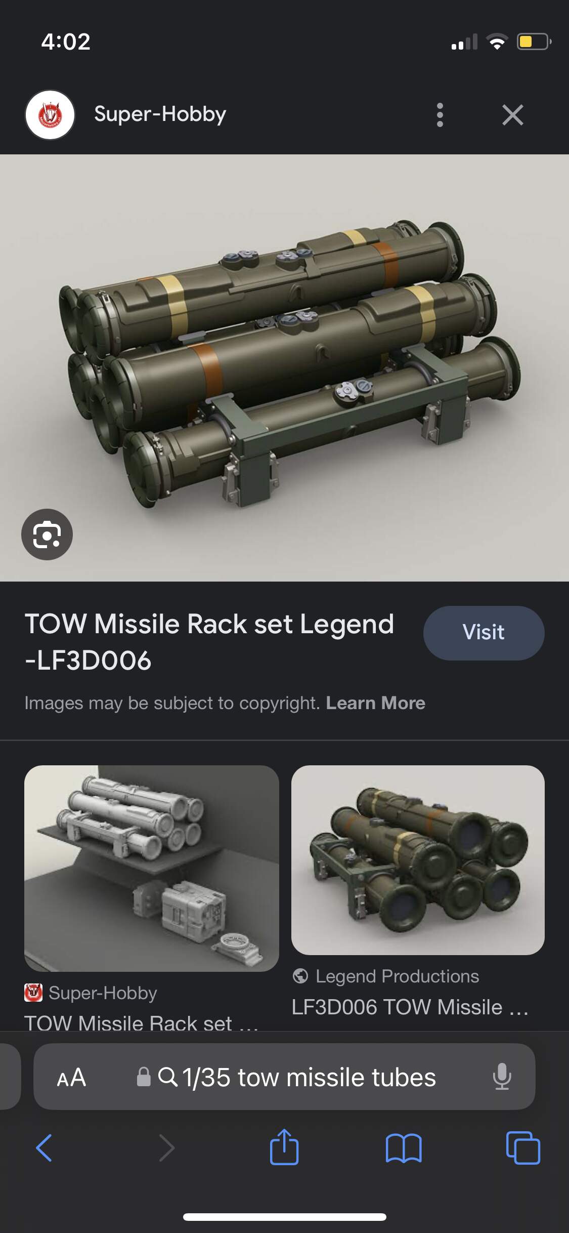

Those are some awesome ideas! I never thought about adding clips/ magazines or any kind of personal items… the mre pouches, do i have to scratch build them? And where can i find 1/35 clips other than ebay?
I have a bunch of pre-printed spare 5.56 magazines I can ship to you. Along with a few spare carbines.
