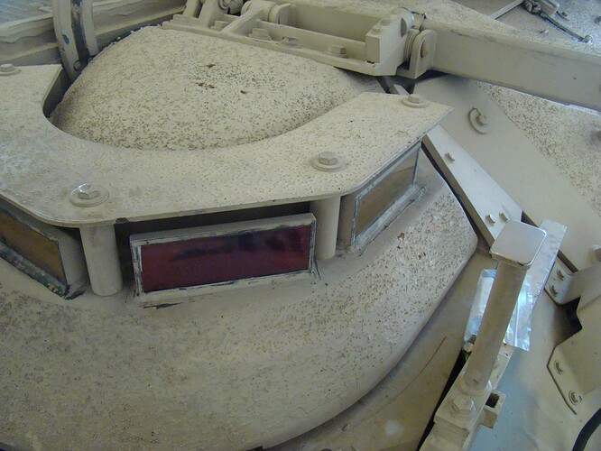

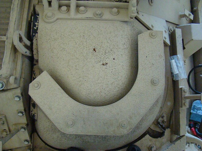

The M3A2 and M3A3 use the same TC and Driver’s hatches. The Tamiya hatches are “correct” and fine to keep/use. The Meng ones are better detailed, but no more “correct”. Either is fine for the M3A2 ODS you are modeling.
Neither are correct. That said, I’m still trying to wrap my head around the fact that you can say two things can be correct, yet vastly different. They can be different, and be incorrect though.
The Tamiya hatch is wrong in two areas - first - the ridges that are pointed out in the photo. Second, the lower left portion as viewed should not be straight, but rather curved as on the Meng hatch.
Here’s a better view:
The Meng hatch is easy to fix - it is slightly too rounded in the front - it should have a bit of a straight run parallel to the front edge of the track, slight, but noticeable. One swipe with a file will fix that.
Then it needs a 90 degree edge all the way around. It’s very easy to discern in the first photo.
Lastly, as you can see in this photo, there’s an edge running around the Meng hatch that is much too sharp - it needs to be leveled. off until it’s barely perceptible:
Compare with this photo:

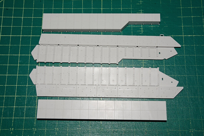

I noticed on the Tamiya side skirts, the front inside edges sits even with the armor plate on the glacis. On the Meng kit, the front inside edges of the side skirts sit above the glacis. After looking at some reference photos, looks like the front inside edge of Tamiya’s side skirts sit too low. The Tamiya and Meng side skirts are exactly the same height except that the front edges of the Meng side skirts where they sit by the glacis are higher. I guess I would just need to add sheet plastic to the front edge of the Tamiya side skirts to adjust the height.
Tamiya side skirts showing the front edge sitting even with the glacis with the extra armor plate added.

You are correct on the armor plates. The cut out on the armor was to allow for the swim barrier equipment. The Tamiya side armor should be made of four plates on each side. Tamiya represented this with welds. You’ll probably want to remove them and scribe lines there instead. People miss this. You may also want to add bolt heads on the insde of the armor plates along the top. Thier position is easy to figure out - they’re oppositre the holes on the outside of the armor.
Each panel of the lower skirt armor of course is made of of two plates of spaced armor. Since no kit has yet duplicated this, you have several scratch building options. There’s also a PE set available for that.

Started correcting the Tamiya armored side skirts. I only added some plastic strips to the front edges to bring them back up to the correct height. The left hand side is slightly taller than it should be and needs to be filed/sanded down a bit. I also still need to fill in and sand the join lines to blend them in. I will work on the lower double armor next. Not going too crazy as I don’t enter shows or contests, this is only for myself. Not really liking the footman loops on the Tamiya side skirts but I have nothing to replace them with so they will have to stay as is.

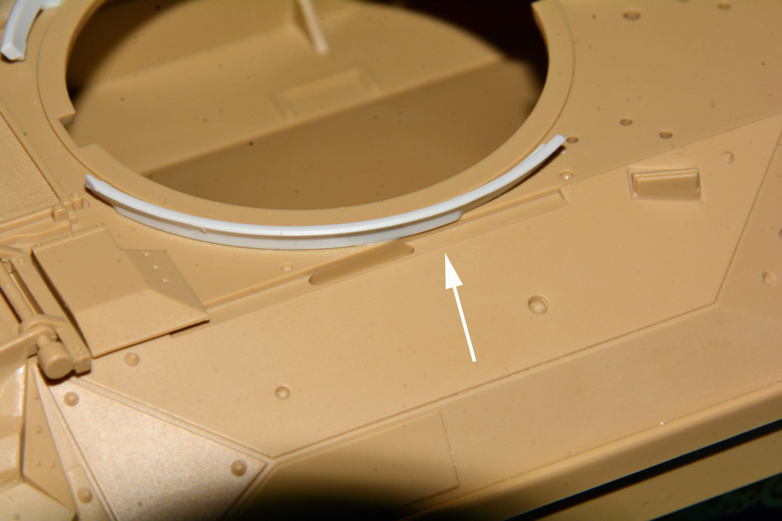

Tamiya has you remove the lip on the very front of the hull. You need to remove it to fit the glacis armor plate.
Imgur
I used label making dymo tape to run across the lip to get a clean, straight line.
Imgur
Imgur
I first used the Tamiya scriber to run along the edge of the dymo tape to get a nice groove then I used the Tamiya razor saw to cut the lip off.

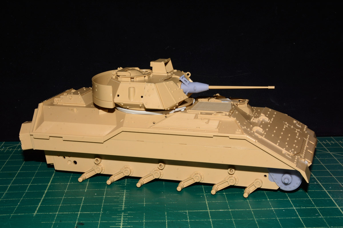

Got some Meng M3A3 parts trees from Meng customer service. The “E” parts tree has the shot trap parts that I needed to add to the Tamiya kit. I used the Meng kit as a guide for the proper placement. The Tamiya turret rotates freely.

Got a little more done on the Tamiya M2A2 ODS.
I will be using the Meng armored side skirts with the ERA blocks. I need to use the Tamiya skirts as a guide to fit the Meng parts to the hull as the Meng parts don’t align the same as the Tamiya parts.
