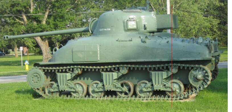

Hard to tell from pictures but your turret looks okay to me. I compared it to my Tasca firefly turret. I can probably be of more help if @Armorsmith can poin out the issue is a little more specific about what looks out of scale?
@Mead93 Thanks for the response. To me it looks too deep(front to back) and a bit to wide. As I said not a Sherman expert by any stretch but it just looks off. Not trying to nit pick but it just struck me that something about it seemed off as soon as I saw it. Don’t get me wrong Erza does great work and has an amazing eye for detail in such a young modeler.
Oh yeah no worries! Didn’t think you were being too nit picky or rude. Just thought maybe I could take some measurements of mine to help Ezra out, if I knew what was wrong. I know he would be capable of fixing what ever issue arose
Without actual measurements it is hard to say if there are issues. I cannot find any direct side on pictures, but this seems to be the closest and based on this the turret bin seems closely aligned to the rear bogie roller, and Ezra’s seems to match that. The height also seems to match the position in relation to the aerial mount ring and also the gap between the bottom of the bin and the bottom of the bustle. Eyeballing it, I’d say this is way good enough.
