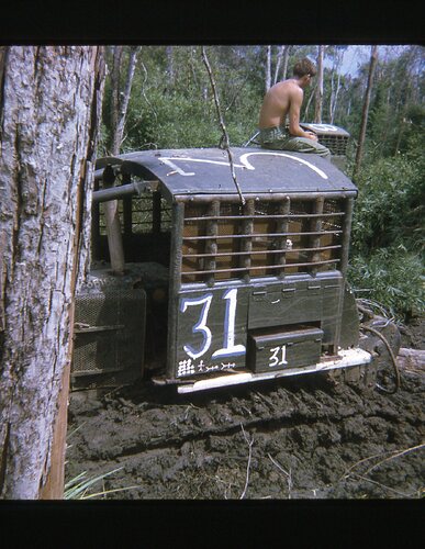

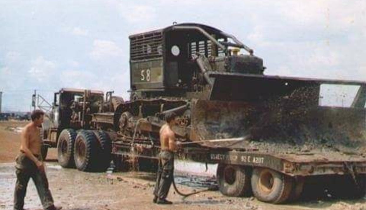

a few reference pics i have from 2nd Lt. Julian Ballance RNZAC - hope these help with reference for you
@NZTankie - thank you so much for posting those pictures! References for the Rome Plow are not easy to find on the net, and the above pictures will not only help me, but also other people building a model of one.
Some mud from the pictures above just has to be seen to be believed…

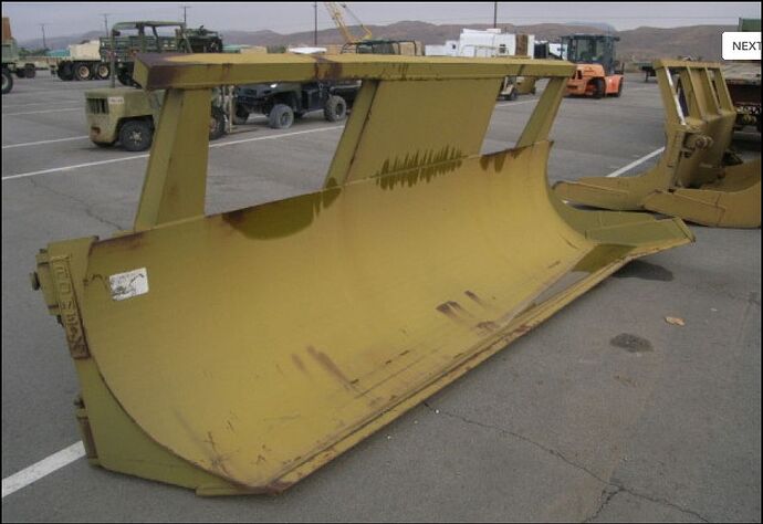

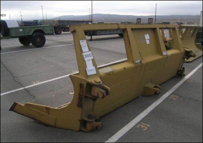

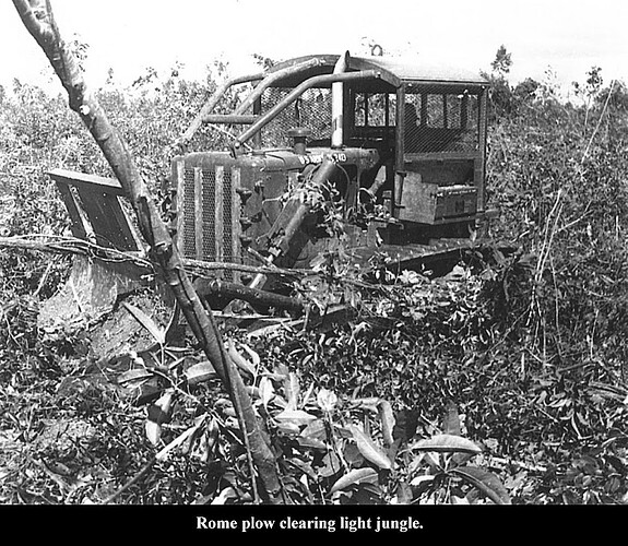

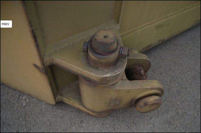

A few more from my archives
Rome Plows Model KG7ED Treedozer walkaround

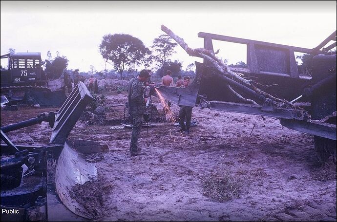

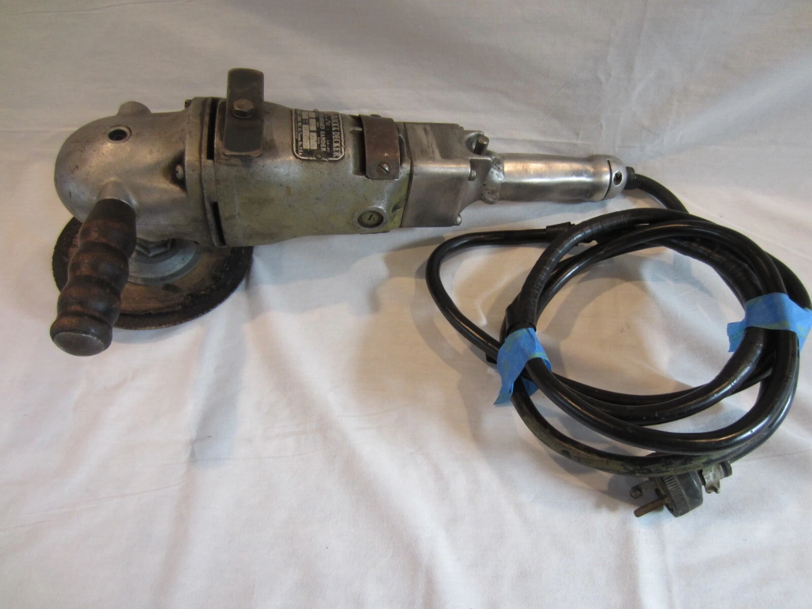

need the little grinder they used to sharpen the blades. Wayne

There are 3D printed angle grinders available so should be easy to find one.
Just pick up a vintage-looking one…

This gas powered one was the one I was refering to. As shown in the manual. Kind of a cross between a chainsaw and a grinder! Wayne
